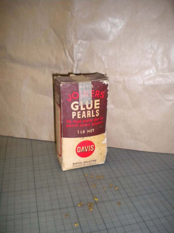

Post by Bruce McC » Sat May 28, 2011 5:09 pm
One for all the users of HHG. Do glue pearls have a shelf life?
The price on the box is 7/- so the contents must be at least
45+ years old. The pearls are dry and separate they have not
congealed into a solid mass.
Bruce Mc.

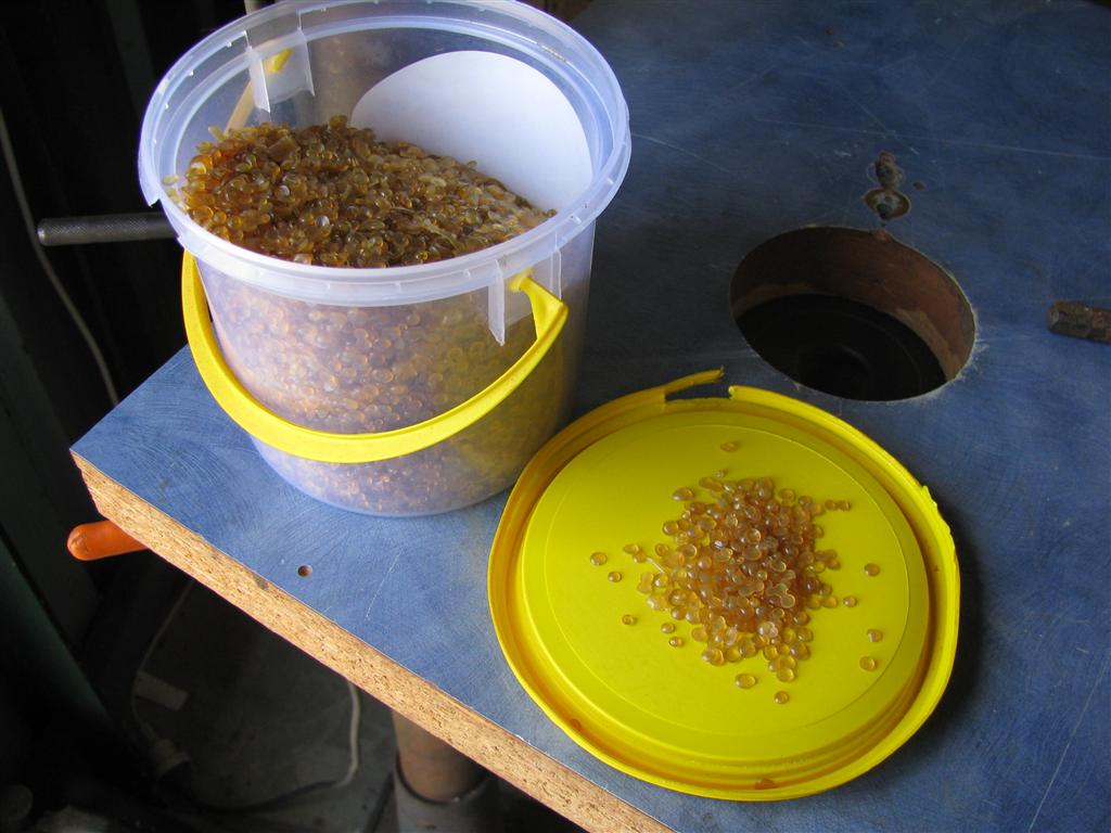

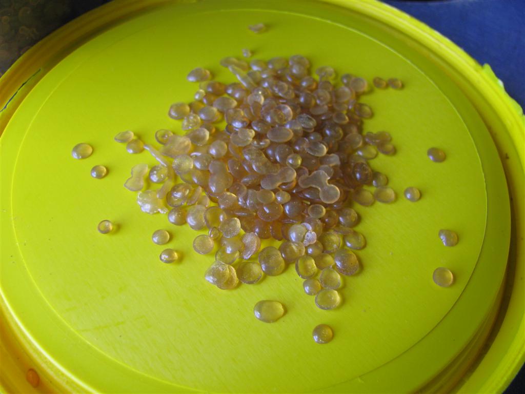

Yes and experiment would always be advisable but how much experience had you with HHG before drawing your conclusion about the Davis product Matthew? I only enquirer as I am at a loss to understand how the product could have deteriorated over time?
My comments above are based upon my own personal experience and that of a french polisher/restorer who had put me on to hide glue for the first time many years ago...I think it was the early 1980's. I still have some of the 'pearl' he took from a huge sack and gave to me to try out.
Last time I played with this stuff, (about 3 or 4 years ago) it was just fine. I only stopped using it because I have no idea of the actual gram strength which is the only reason why I switched to 192 high clarity. I know there may have been many years, at least 14 anyhow, between pre-decimal currency made glue and the stuff from the 1980's, but a couple of things make me wonder what the problem could have been with your glue.
First of all, this french polisher had immigrated from England bringing his business with him...that included the big sack of pearl glue from which he took my generous sample and he had been well established in the Perth hills area for quite a few years before I stumbled across his operation. So we can add at least another 10 years to my sample...but here is the main point that is causing my confusion.
When this fellow was lauding the benefits of HHG leading to him giving me that sample, our conversation had been triggered be me first inquiring as to the purpose of the grubby stainless steel syringe he had laying on his bench. His explanation to me was that the true beauty in HHG is that rather than him needing to pull apart some of the antique pieces sent to him for restoration to affect a repair, often times, as long as no one had tried to fix the problem themselves using PVA or Araldite :?, he could simply inject any loose joints with hot water to reconstitute the dried glue and clamp it back into place saving a lot of money because clean up was minimal and refinishing not required...some of those pieces where well over 100 years old and he was re-using the original hide glue. He would not do so on chairs and such simply because of the risk involved, but dressers and sideboards no problem...as your signature use to say.."Strong stuff this glue"
EDIT: Thought I had best clarify that the re-constitution of glue joints as described above was not 'the' standard practice employed or recommended, rather it was an option offered to those seeking a 'cost effective' repair suitable for antique 'occasional furniture'.
