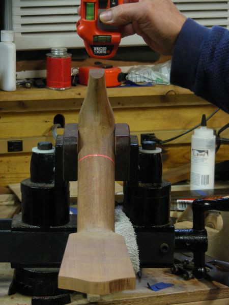

I lurk around these parts sometimes, and once in a while I have something to contribute. I guess this is one of those times!
I use laser levels a couple ways. Clipped to a shelf above the workbench, with the laser beaming straight down, I use it sometimes to do a rough check the neck alignment with the body. Also, it works to check neck cross-sections, sort of like holding a card over the neck to cast a shadow, only the laser can also work in the heel area owing to its coherent nature. Like this:
