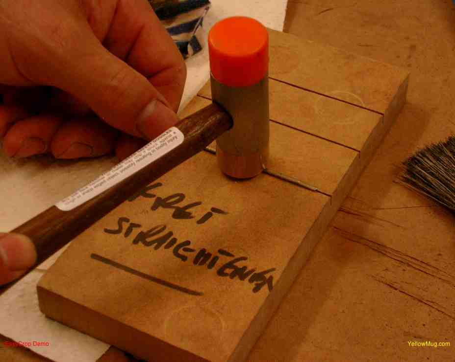

Get a piece of MDF...cut a fret slot in it with your fretsaw.
Cut each fret off the roll and straighten it by placing in the dummy slot in your piece of MDF and giving it a few light whacks with your fret hammer.
Note that I actually like to leave a bit of curve in my frets when doing a fret job on my classicals...less chance of the ends ending up sitting proud of the fretboard if I hit the fret a bit too hard.

kiwigeo wrote:Get a piece of MDF...cut a fret slot in it with your fretsaw.
There you go Nick, knew there'd be a cheap bastard here somewhere!
No it's actually a damn good way of doing it, plus as Martin & Tod point out, leaving a slight curve in it, help the ends to stay seated.

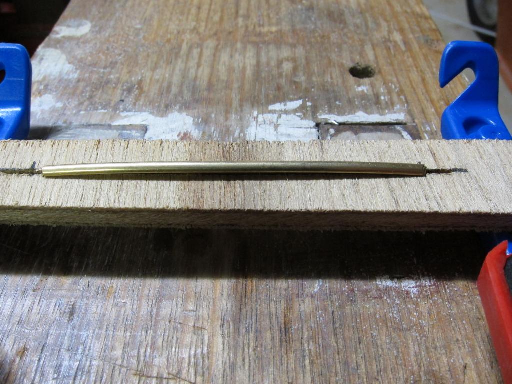

After reading the suggestions, this is my ultra-cheap solution. Cut a skinny piece of 6mm ply about 100mm long, cut a slot in it just deep enough for the fret tang with a dremel cutting wheel, clamp a couple of bicycle tyre levers to the sides of a trestle so that they support the ends of the ply about another 6mm above the face of the trestle, put a 100mm long piece off an old industrial hacksaw blade over the fretwire to provide something comfortable to press on and to distribute the pressure evenly, and press in the middle until the ply contacts the top of the trestle. This is a fret after doing this. it still has about 1mm of curvature, which is about what I want and a bit less than half of the original curvature.

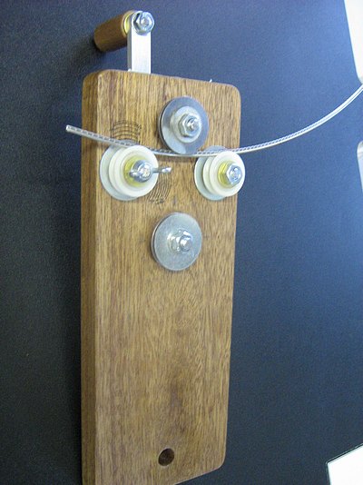

Quite a few years ago I made a little fret bending jig much like the StewMac one . Here it is : The wheels are made from 2 mudguard washers and a smaller washer between them. The white nylon ones are door runners and so won't mar the wire

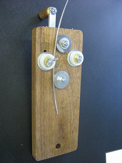

Some time later after receiving some new stainless wire which was coiled way too tight , I got to thinking about how this jig could uncoil to a bigger radius and came up with this additional fourth wheel . You can see that the adjustment wheel can be moved in it's (two way )slot to increase or decrease the radius:
To decrease the radius ;
To increase the radius ;

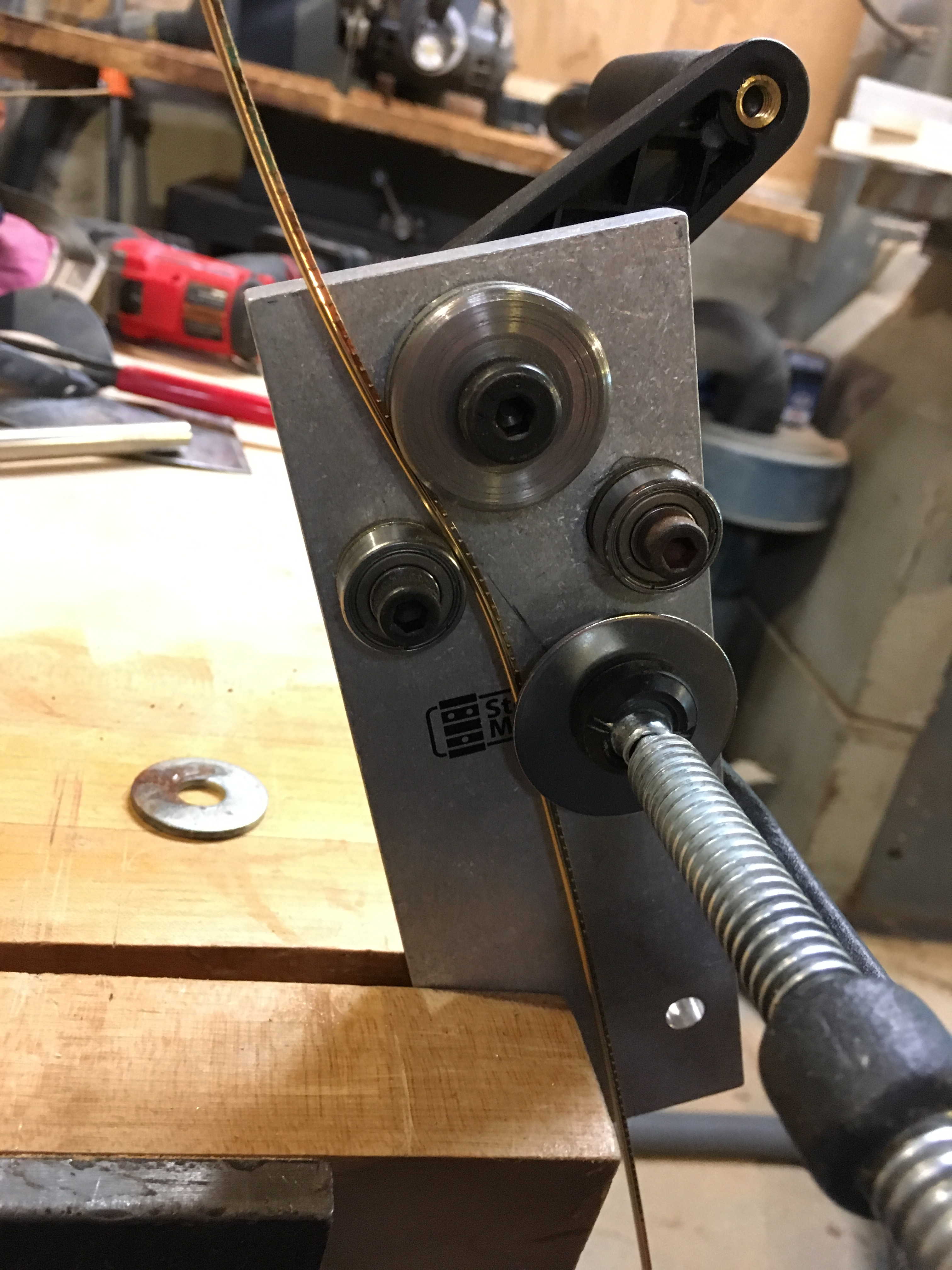

I know this is an old thread -- but I've gotten here twice with google searches -- so I thought I'd describe a simple way I adapted the stewmac fret bender (which only increases curves) to straighten a coil of 43080 EVO gold fret wire.
I used a C-clamp and large fender washer to position and clamp a 7/8" bearing in the right place so that the fret wire ends up straightened when fed through.
See picture.
See picture.
