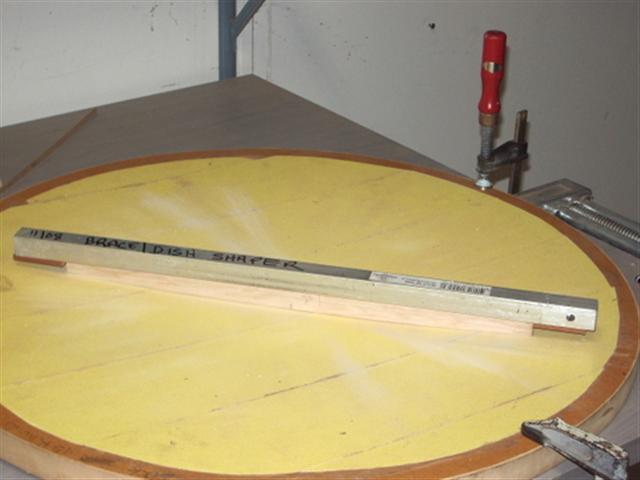

I radius as shown in the photo with the added support to make sure the pressure I'm putting down is more even along the brace's length. You might just see the wooden adjustable end "clamps" that holds the brace in position. Works for me anyway.

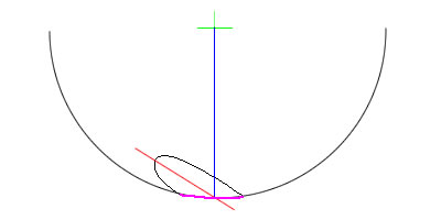

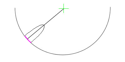

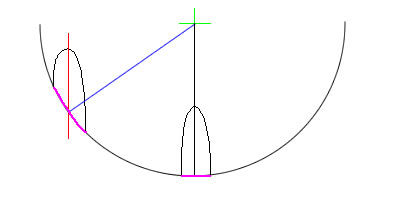

That's the point made by those whom advocate sanding with the brace held vertical relative to gravity at a place in the dish relative to its intended location on the guitar, there will be no tilt. I copied Billy T's post with images from the OLF topic mentioned above (Hope you don't mind Billy). For me this gives a good visual of what is going on.kiwigeo wrote:How much tilt you get on your braces depends on radius of the dish doesnt it? I definitely notice tilt when I do my back braces in a 15' dish and shape them at dish centre.
Anyway Im completely anal about such things and even if it doesn't look crooked I KNOW it's not vertical...
Must say that I really like Taffy's brace sanding support...gonna build meself one of those suckers today...THANKS TAFF!!These are a few figures that give an exagerated conceptual difference to sanding braces at different angles to the center line(green CL) of the sphere. This is to keep the brace CL(red CL) perpendicular to the top and not to the CL of the spherical form.
The first figure shows, though the spherical radius is the same, the spherical segment(purple) generated on the brace is not, again to keep the CL of the brace pointing "straight up" in relationship to the finished guitar.
This figure shows that one can, in fact, as Rod said sand in any place in the spherical sanding dish and generate the same form simply by angling(blue line) the brace CL{red} to the spherical CL(green).
One can do the opposite by sanding offcenter to the perpendicular CL of the spherical radius and still obtain the proper spherical segment formed on the brace.
By not sanding as Hesh does what one really gets is a toroidal segment(the outside portion of a donut shape) not conical. This causes the braces CL's to be lined up at angles to the horizontal plane of the guitar, the top facing up.
Yes the spherical radius is the same, the spherical segment, again, is not! Considering the size of the radius in real terms does it make a difference.... depends on how much you want to put into the guitar. I can do the math in numbers but getting into spherical radius points gets hairy if you don't do it often and I'd have to pull out length and width measurements of the braces themselves.

Taffy, could we get some more pictures of your brace. Its really hard for me to make out the details from here.
