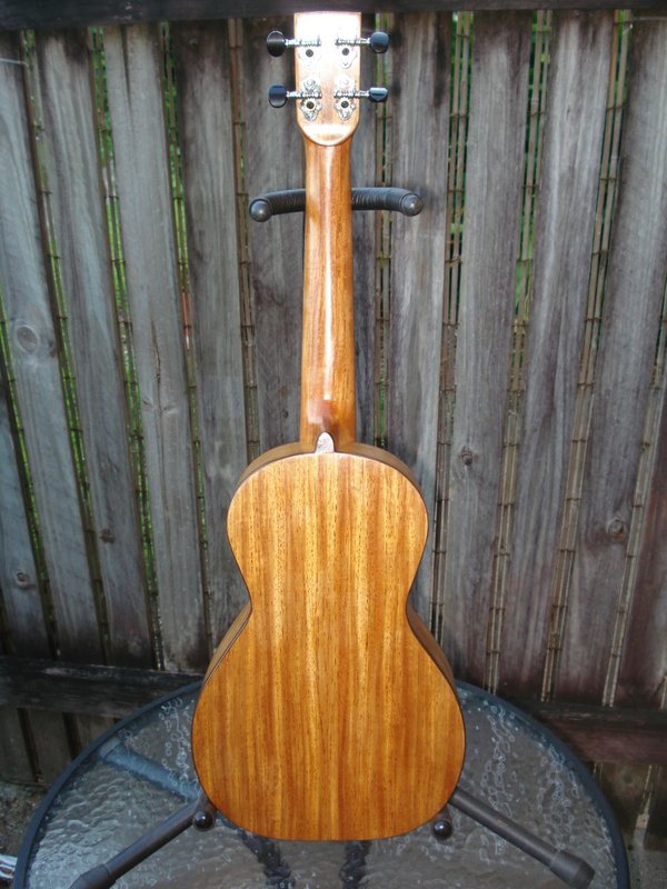

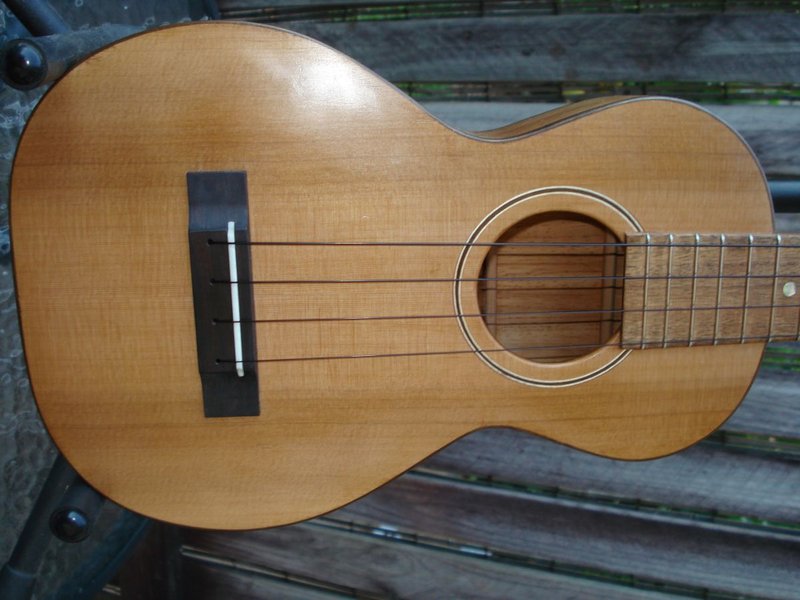

Post by liam_fnq » Mon Apr 18, 2011 3:37 pm
I've used minwax poly a bunch of times. I left a pool of it on some WRC soundboard to dry. Then I snapped the piece to check the penetration.I did this because so many self proclaimed experts claimed it soaks in and ruins the tone. The amount that had soaked In was almost impossible to see. This was a very important lesson not in finishing instruments but in not believing hype.
I'll post some photos when I get home. I think it's an excellent beginners finish. Time for me to step up though. :)

Post by liam_fnq » Mon Apr 18, 2011 7:36 pm
here's some pics
CA pore fill under Minwax Wipe-on Poly (Satin)
Re: wipe on polyurethane finishes
Post by charangohabsburg » Mon Apr 18, 2011 11:23 pm
liam_fnq wrote: I left a pool of it on some WRC soundboard to dry. Then I snapped the piece to check the penetration.I did this because so many self proclaimed experts claimed it soaks in and ruins the tone. The amount that had soaked In was almost impossible to see. This was a very important lesson not in finishing instruments but in not believing hype.
That was not nice, Liam. Now we have one myth less to believe in. :roll: :mrgreen:
Beautiful uke, BTW.

Post by Bruce McC » Tue Apr 19, 2011 8:59 am
Thank you LIam. Nice looking uke, what is the timber on the back?
Afshar
liam_fnq
Posts: 590
Post by liam_fnq » Tue Apr 19, 2011 7:34 pm
That's New Guinea Rosewood. Probably the most common joinery timber up here in FNQ and a great tonewood to boot. I can buy it by the shed load up here.

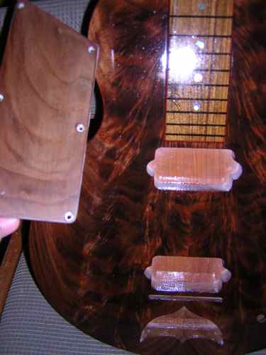

Alan Stassforth
Posts: 35
Joined: Mon Nov 15, 2010 4:09 am
Post by Alan Stassforth » Thu Apr 21, 2011 1:07 am
I'm trying the "General arm-r-seal" finish right now on a slab git.
It's a wipe on polyurethane finish.
This is about 5 coats or so.
Takes a lot of coats, but it seems to be building.
I'm thinking about 6 more will do it.
The control cover is ktm-9,
and is a cutoff from the top cap.
See the difference?
I don't know if I'd use it on an acoustic,
but maybe?.......
