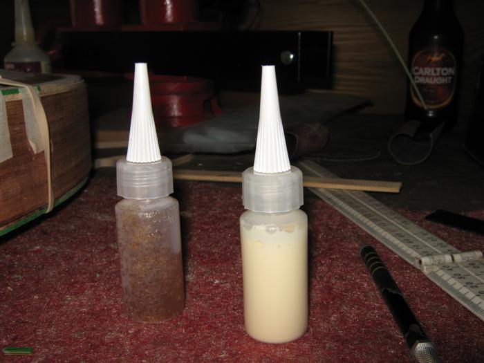

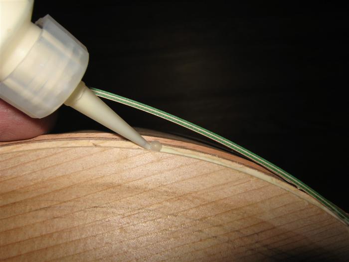

I thought this might be of interest to some, especially those who are new to the art of lutherie.
For me, applying glue to the workpiece without making a bloody mess has been a problem, well recently i've found a method to help me keep the sticky stuff under control a bit, resulting in less waste, less ooze out, less mess.
I found some little plastic bottles with needle point nozzles, similar to those that Hot Stuff C/A comes in in an art supplies store. For hhg i simply mix in bottle and heat and apply, no mess no fuss, simple. For tite bond just decant and apply at will!!!!

Rod are you sure that the Carlton draught in the background hasn't been the cause of your messy gluing ...hahaa
looks like a brilliant little bottle obviously perfect for purfling and binding,

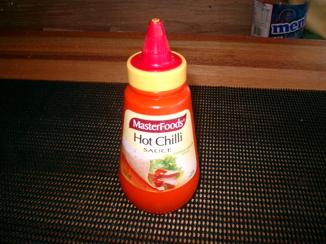

Here's my glue dispenser, once the contents have been consumed, wash it out re-lable it and hey presto.
Holds up to 250ml and the screw top lid seals the contents.
Hey if it's good enough to hold sauce, it's gunna be great for glue.

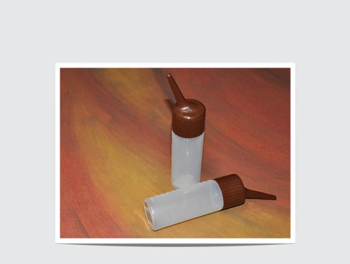

Post by rocket » Fri Mar 25, 2011 4:53 pm
This is the dispenser i used to use but i just got sick of the bloody mess, even with that fine tip you can see i just couldn't seem to glue anything without getting the damn shit everwhere!!!

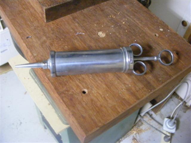

Syringes are superb for new and repair work and if you explain what you are doing with them doctors, dentists and vets can be forthcoming sources for all sorts of sizes.

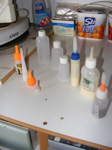

I bought a swag of small plastic bottles from one of those $2.00 shops and put my own nozzles on them, I obtained them from many different sources, including caulking gun nozzles. I just drill a hole in the cap and fit and glue the new nozzle in.

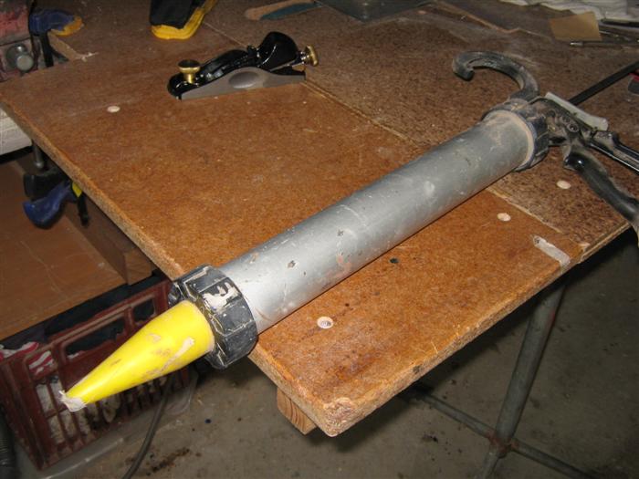

and then there's the mother of all syringes...........
DSCF5059 (Small).JPG (42.41 KiB) Viewed 9766 times
