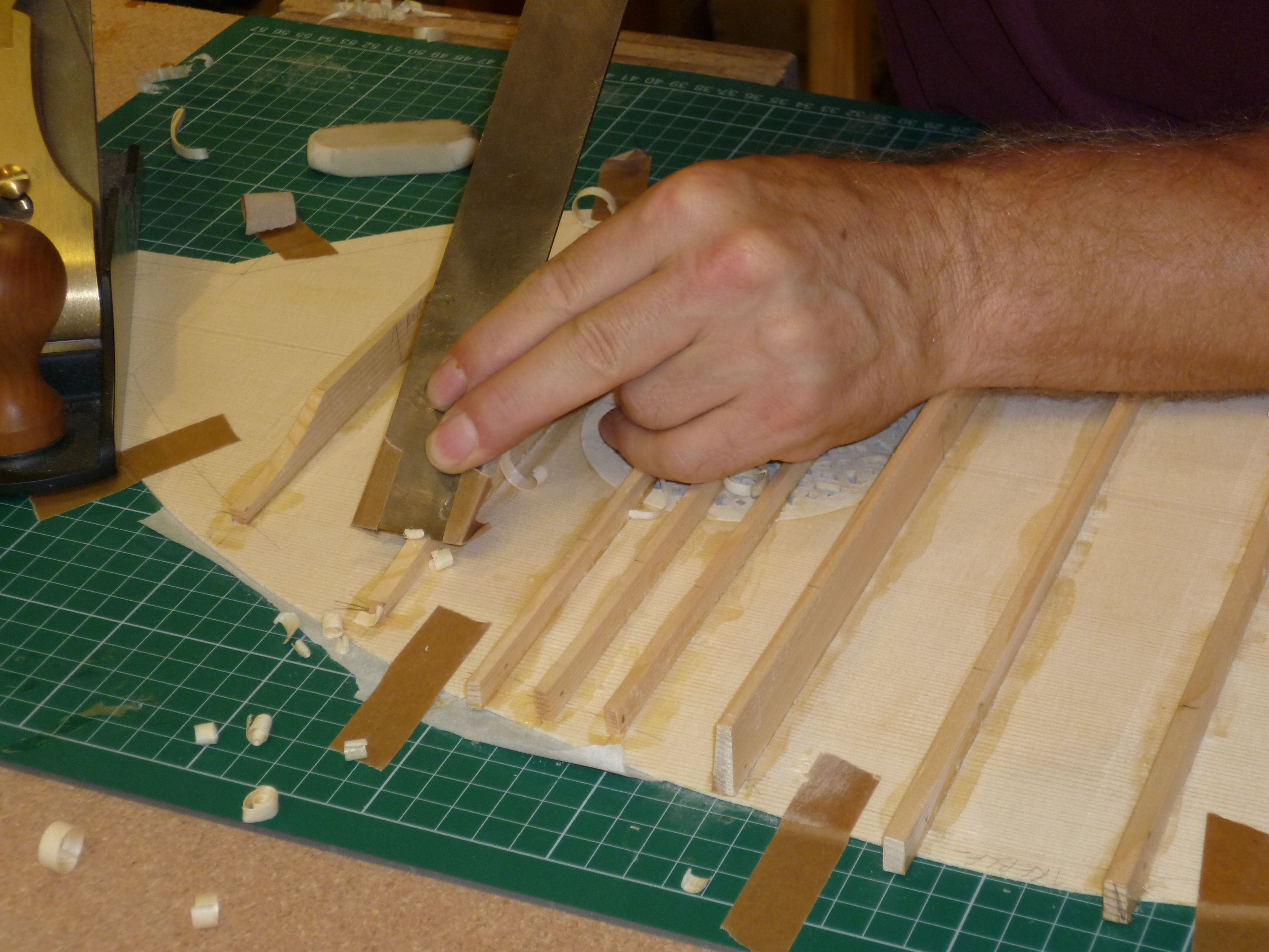

Technically Martin your lute braces are quarter sawn and making braces with the grain the other way makes them back sawn unless they are lower than they are wide then they become quarter sawn again. So if you want to follow Billy's method then you want your bracing to be back sawn and not quarter sawn. A bit confusing ain't it. :D
Edit. Nice tip with the tape on the paring chisel Martin, that will save me being annoyed when I make that little slip at the end from now on.

Yep, good tip on the tape when carving brace ends! I've also been looking for a shallow gouge for the ends, but tape is cheaper.
