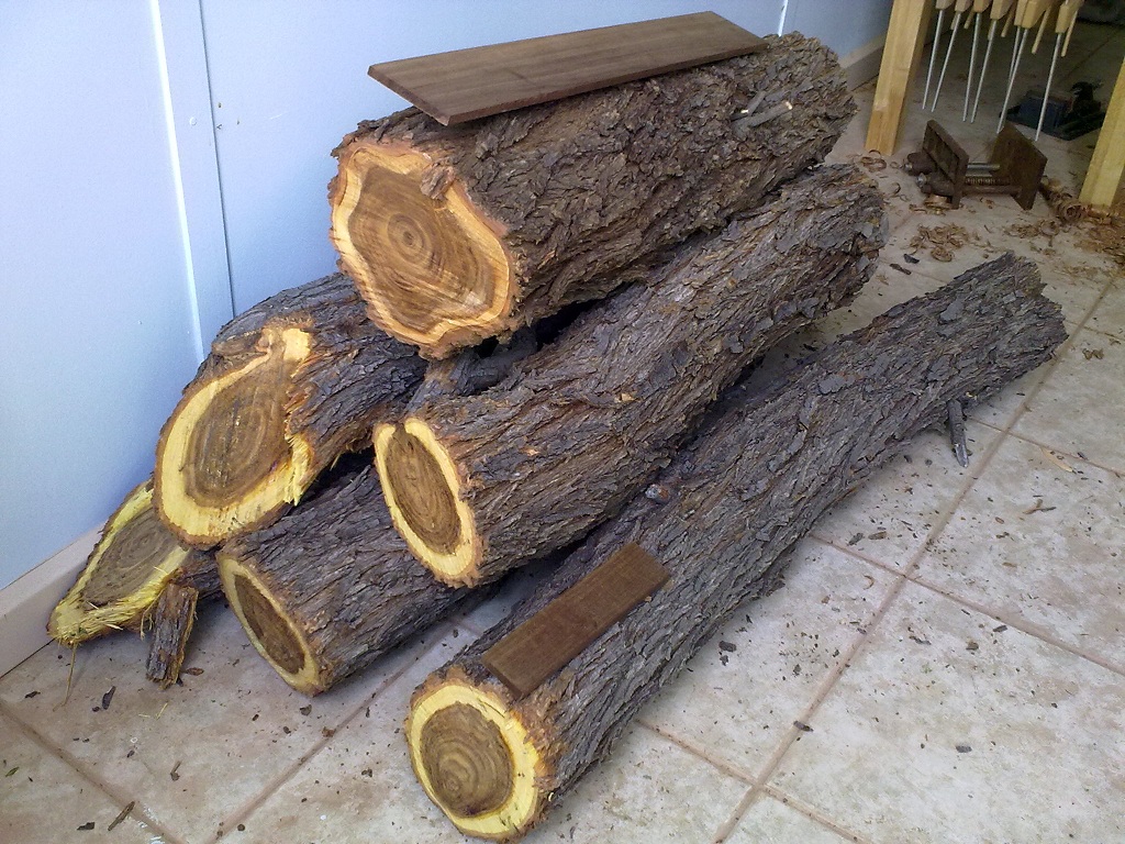

So I went to see my new mate "the tree lopper man" this morning.
He showed me some of the timber he'd sliced & some he hadn't yet.
I discussed with him my needs for good back & sides and how I'd be interested in the central cut etc, etc.
Then I showed him a gidgee fingerboard to demonstrate that I'm not just interested in large pieces - if the timber is right.
He chuckled, pointed to the back of his truck, said he'd just cut down a gidgee tree this morning & that there was some nice straight pieces if I wanted to have a look.
An hour & a case of beer later, I was stacking these logs the workshop.
I have placed a gidgee fingerboard & bridge blank on the stack for reference.
I figure I can get a few of both out of this.
Since I won't be able to cut it for a while though, how should I store it.
I assume I still paint the ends, but do I leave the bark & sapwood on, or remove it as fast as possible?
Do I really need to get stuck in & start slicing & dicing?
I've only ever re-sawn pre-cut planks before.
When I do saw this stuff, to be wide enough for fingerboards, most of the boards I get will have need to have the centre of the heartwood in them. Is this likely to cause a problem in use?
Also, can the sapwood be saved & used as decorative strips (purfling or maybe even binding)?
I'm sure I've got more questions....I'll ask as I think of them.
(And I won't be offended if you tell me I'd have been better off drinking the beer, just a little disappointed) :dri

Seal the ends immediately and store in the shade off the ground. Do not remove the sapwood or the bark, you need to slow things down as much as possible. Can't see why not to use the sapwood once it has been dried. I would not cut it up immediately. My experience from two Ironwood logs is that you get more useful wood if you let it dry in the log, but Kim is right in that it will get harder to saw as it dries. I cut one of the Ironwood logs when still wet but lost a lot of wood through splitting and twisting. The other log sat for years and the wood was stable when I cut it up and has made some nice fingerboards. Gidgee can be a pig to saw if really dry because it is soooo hard. I was once given a 100yo Gidgee fence post and man that stuff was HARD. Other Gidgee I have was not so bad.

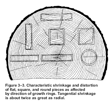

Heart shakes are those cracks you see on the end of a log that run radially from the pith out. If you season wood in the round what often happens (although not always the case especially with really dense dry country wood like you have there) is because the tangential shrinkage is greater than the radial shrinkage the wood has nowhere else to go other than to split (usually radially i.e. heart shakes). If you mill the wood green you minimise this, in fact because the wood after being cut is not subject to being, like "held" by the rest of the log, you can stop the heart shakes (hmmm sounds right in my head) I just pinched this diagram from a web site to illustrate what I mean hope they don't mind.
If you look at the dowel shaped section it shows how it will shrink in relation to where it sat originally in the round. It shows how the wood shrinks more tangentially than radially. The diagram also shows heart shakes.

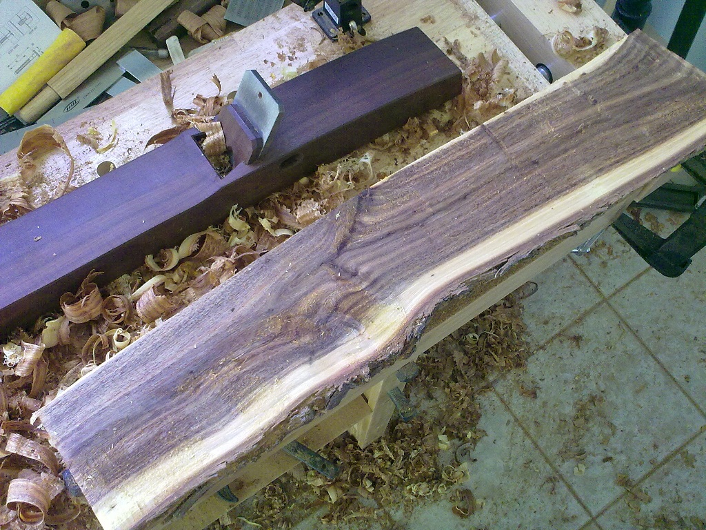

Well, while lying in bed last night I made the decision to cut 1 log in half & see what I've got.
Took a bit of work. Had to slice off some sapwood first so that I could fit it into the bandsaw, then went slow.
It didn't blunt the blade (anymore than normal) but the wet dust did clog everywhere & took a fair bit of cleaning up after. (And airing out the smell)
Anyways, here's how it turned out after cleaning up with a (gidgee) plane.
This piece is just longer than the length of a fingerboard blank.
Unfortunately there's too many defects to get any fingerboards out of this log.
(Should get some bridge blanks though, & maybe a couple of little plane bodies)
Also enables me to test Peter's idea - will see how this split log dries compared to the others.
Thanks everyone for they're help.

Ahhhh, problem solved Peter, I always think of ironwood as the Cooktown one. looks good Craig and with a bit of luck the rest will be more fruitful.

Cutting in half won't be enough. you are not relieving the stresses enough and it will most likely split. You will need to cut the halves in half again so you have 4 pieces, and do it now.
That log you have looks fairly typical to me. Looks ok from the outside, but as soon as you cut it in half you discover all sorts of hidden defects. Can be really frustrating if you want fingerboards, but I can use most of the smaller pieces as tuning knobs so most of the good wood gets used even if only small pieces. That mandolin in the picture has Lancewood tuning knobs from the 25yo log I recently cut up and a NSW Ironwood fingerboard.

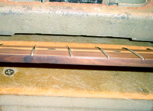

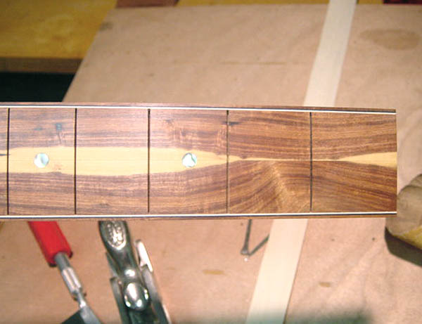

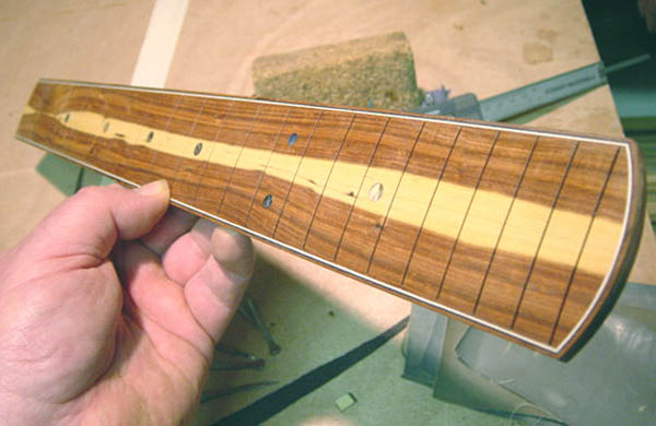

I knew and old bloke who, until he passed away, use to supplement his pension by making wall clocks and plaques. He had a mate who he used to go prospecting with years earlier who still lived out in the goldfields of WA. Each trip to Perth, his mate would drop in a few small logs of mulga and gimlet and they would simply stack them on a pallet inside half an old corrugated iron water tank.
The old bloke had a horizontal bandsaw, the kind used for metal work. He also had a cradle welded up from angle iron to hold the logs that were all app 150 to 200mm through. When he needed to make a batch of clocks, he would load a log into the cradle and start slicing off rounds from the end, bark, sapwood, the lot, at around 19mm. I don't know how much wastage he got through end checks, but I do know that none of the logs were sealed on the ends during storage as I seen some with the ends right off the chainsaw that were inside his shed ready for slicing.
He gave me a small log of mulga from that lot which I took home and sealed with plumbers glue. A year or so later I resawed it for fretboards etc and there was next to no checking. Once opened up though, the wood was found to have lots of knots and branch junctions etc so very little 'clean' wood came from the exercise. But its beautiful wood all the same so I continued the resaw. I am glad I did because even with all the faults, the 8 to 12mm thick slices I kept have remained surprisingly stable even after 5 years.
I know that many will say that you should not use such wood for the fretboard of a guitar for fear it will impart a bend or twist in the neck, but I disagree. First of all because as mentioned above, regardless of the knots and other issues, the wood is in fact quite stable. This is great the thing about really dense wood, it takes a long time to lose what little moisture it has to give up, but it also reacts very slowly to changes in RH because it can't take up moisture from the atmosphere that quickly either.
This means that such wood by its nature has greatly reduced extremes of movement, ie; it could take days of even weeks for malga to reach equilibrium if it were taken from a relatively dry climate, to a moist tropical climate. So under normal circumstances, where the wood is only exposed to the normal RH swings that occur within its own environment, it hardly has a chance to move at all, because no sooner does the RH rise, than it falls again. So dense woods such as mulga do not have enough time to respond to these swings and more often than not, RH changes will occur around them whilst they remain quite stable suspended somewhere in the middle.
The other thing to consider about the effects of wood in tension, is that movement and the force associated with that movement, is directly related to how 'thick' the wood is..i.e. thicker wood = more reactive fibres and therefore, more force to worry about. But a fretboard 'before' processing with a radius, is only 6mm thick, and then many slots are cut into it to a depth which leaves the section with the structural integrity of kerfed lining.....not much force left in that regardless of the knots and yes, it can be argued that the slots are then filled with fret wire reintroducing much of the lost integrity once the board is glued to the neck. But to my mind, the reactive fibres have still been cut which reduces their capacity to work as one to twist and buckle the fretboard.
Case at hand, I made this mulga fretboard and glued it onto a guitar a few years back. It has lots of 'reactive' wood, knot shadows, branch incursions (have a look at the wood between 1st and 2nd fret), sap wood, even the bindings are full of knots, but the neck of the guitar to which that FB is glued remains as solid as a rock.

Pretty fret board Kim, that sap inclusion give a nice contrast the the average.
