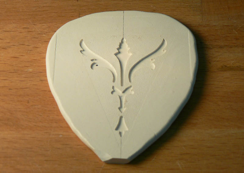

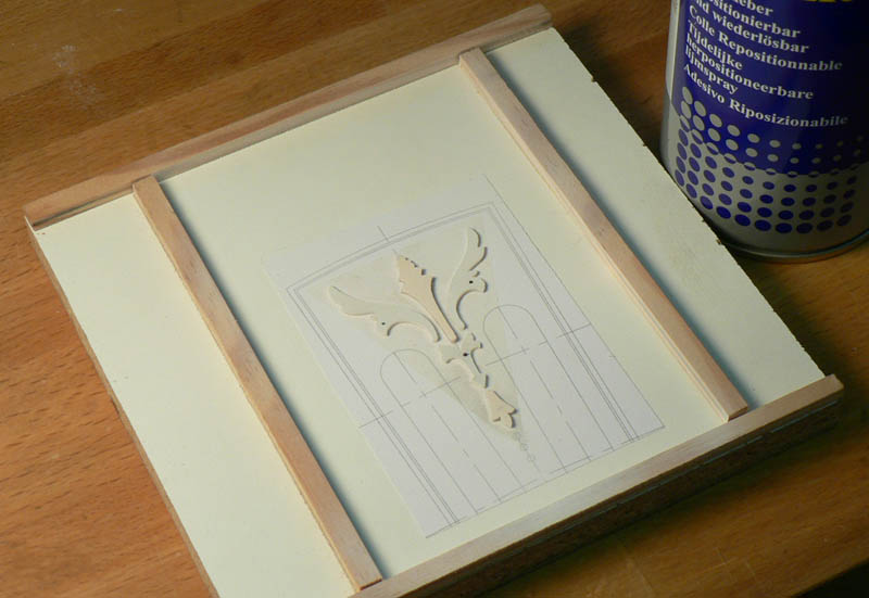

Once I'd cut out the shell pieces I used 3M re-positionable spray adhesive to position them face down (don't forget) on a board. I then gave them a coat of 'mould-relase' spray. This, in fact, is a Teflon spray I already had for treating saw or jointer tables, etc. Keith uses olive oil which probably works just as well but is a bit more messy.
TUC 106.JPG (69.99 KiB) Viewed 34382 times
I then warmed up some 'friendly plastic' in hot water. Mine is in fact called Utileplast (a French equivalent) but you can get the real thing from LMI if you don't have it in Oz. I kneaded this well around the shell. Note the 2 spacers stuck to the board.

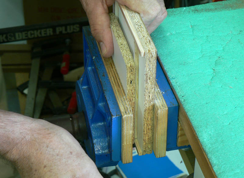

Then, while the plastic was still soft, I put another board on top and squeezed the whole lot up in the vice, and left it to cool down.

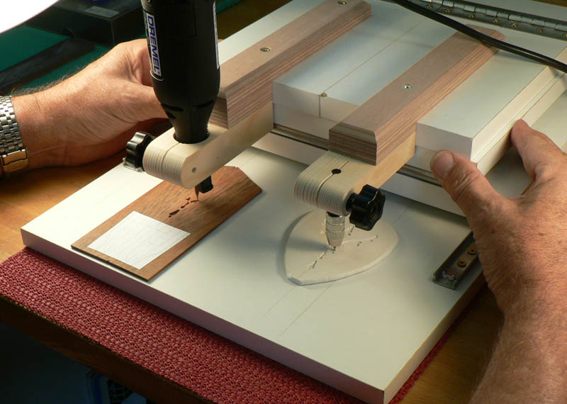

This is the only photo I have of the 'machine' but I'll tell you a few things about it that need to be modified before I use it again. First of all I simplified it a bit by making the Dremel attachment and the stylus fixed. That was a mistake as I had to very carefully align my headplate veneer and the mould to get the inlay in the right position. So either the Dremel or the stylus (or both) needs to be adjustable. Second, as you can see, I used lightweight drawer runners and heavier ones would probably have made it a bit less flexible. To attach the Dremel I bought the accessory for cutting holes in dry walling and used the threaded part. If you think of making one just watch Chris Paulick's video a few times and you'll get the hang of what you need to do. Take note of what he says about 'racking' the hinges to take out the play; I wouldn't have thought of that.

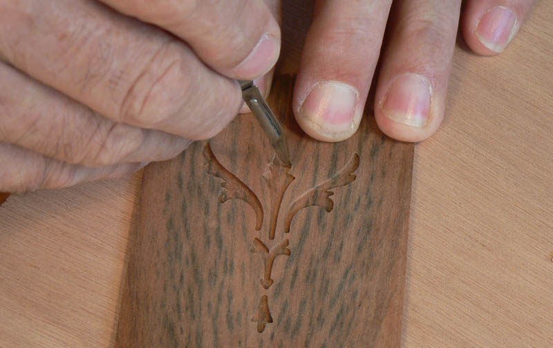

Do some trial runs before starting on the real thing. My first results were very disappointing; the recesses I cut were much too big. I used the 1/32" downcut cutter from Stewmac and a 1/32" drill shank as a stylus. I had to experiment a bit and finished up using a bit of brass rod as a stylus and kept putting it in the drill chuck and filing it down a bit until it gave me a recess that was the right size. It also needs a very light touch. I found the best way was to hog out the inner part of each recess, watching the stylus, not the cutter and then carefully follow the contour of the mould using as little pressure as possible. Of course, if it were made from aluminium plate, using precision hinges and linear bearings instead of drawer slides it would be more accurate and wouldn't need such a light touch, but this only cost a few quid.
A 1/32" diameter router bit looks tiny and you'd think that a 1/64" radius would be next to nothing, but it ain't. So this machine's not really suited to inlays with long pointy bits. Any inside corners in the recesses still have to be cut by hand. And I'm with you guys when it comes to eyesight. I'm seriously considering one of those binocular thingies that Dan Erlewine always has stuck on top of his head!
TUC 115.JPG (67.5 KiB) Viewed 34380 times

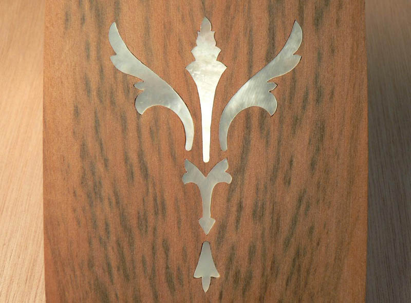

So when all the bits finally went in, it looked like this. As I said, it's not at all perfect, but I don't think I would have got it any better by hand.
TUC 116.JPG (90.06 KiB) Viewed 34380 times
With a bit of sanding dust mixed into the epoxy the shell was glued in. The sanding dust/epoxy mixture always looks darker than the surrounding wood (unless it's ebony) so I mix a bit of chalk dust in as well to try and get a better colour match.
