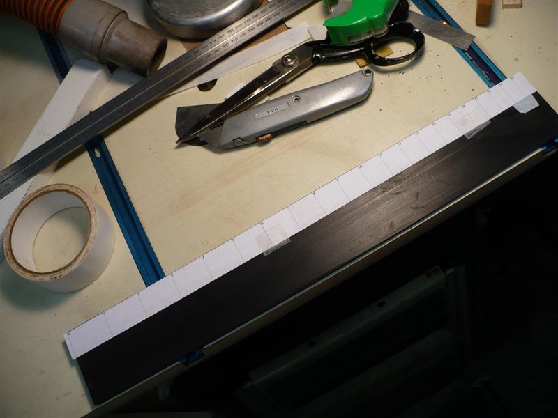

wfret is a good calculator which will print you a template.
I print the tamplate, then stick it lightly to the centre of the board then prick through it with an awl.
I then cut in a mitre box with the saw covering the awl mark
Saves measuring and marking errors
BUT
you must check your printer's accuracy by comparing the template measurement (12th fret) with the calculated measurement and adjust if necessary.
And use it straight away or recheck it because paper does move with RH

Paper will also move with liquid glues so I star at one end and dab a bit of stick on, a couple of frets at a time. A spray adhesive would work well.

I also print with wfret, check it carefully for accuracy (it gives the measurements from previous fret and nut), and double stick tape it to the board, and cut it on my RA saw, aligning the edge of the blade to the line (not trying to center it).

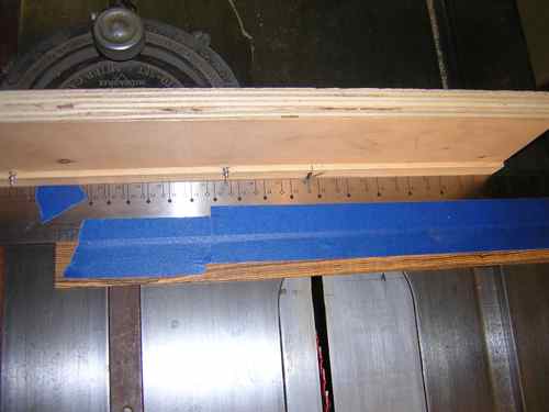

I transfer my fret positions to a length of aluminium strip, about 20mm wide and long enough for the whole scale length. I scribe the positions of nut, frets and saddle. Then with a fine saw make a shallow saw cut possibly 1mm, with a fine saw, in one edge.
This is now my template, I have many of these at different scales, hanging ready for use.
I then clamp the aluminium template to the fingerboard and with a sharp fine knife that fits the slots in the template [with no sloppiness] push down in the little slots and into the fingerboard, leaving a little nick in the surface of the board. Remove the template.
I then rub some white chalk into the nicks so they stand out, I place a knife back into the nick on the board, slide a small engineers try square up to the knife blade and score across the fingerboard. The board is of course not shaped at this point. I then rub chalk into all the slots and its ready for your chosen slotting method.
I don't use a hand slotting method anymore as I use my table saw, the templates for which I made using the above method.

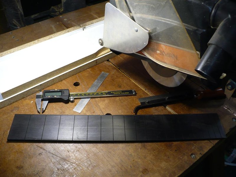

I wonder if is is worth me adding here as there has been much said but before I started using templates I measured and marked my fret positions with vernier callipers, starting from the nut, then when the callipers reached their limit I clamped a stop at the last mark then measured from there.

A one metre length of 5mmx50mmx40mm ali angle marked out in Jim's method and drilled gives me nine very accurate 24 fret jigs per length that I can prick through. By using frets one through .... as the "nut" the jig is incredibly versatile for multiple scale lengths.
A bonus with the FretFind 2D is its giving an accurate nut to saddle length per string per tuning that gets you right in the ball park for initial compensation setup.
Extrapolating further (asking for 72 frets) will give precise pickup placement.
