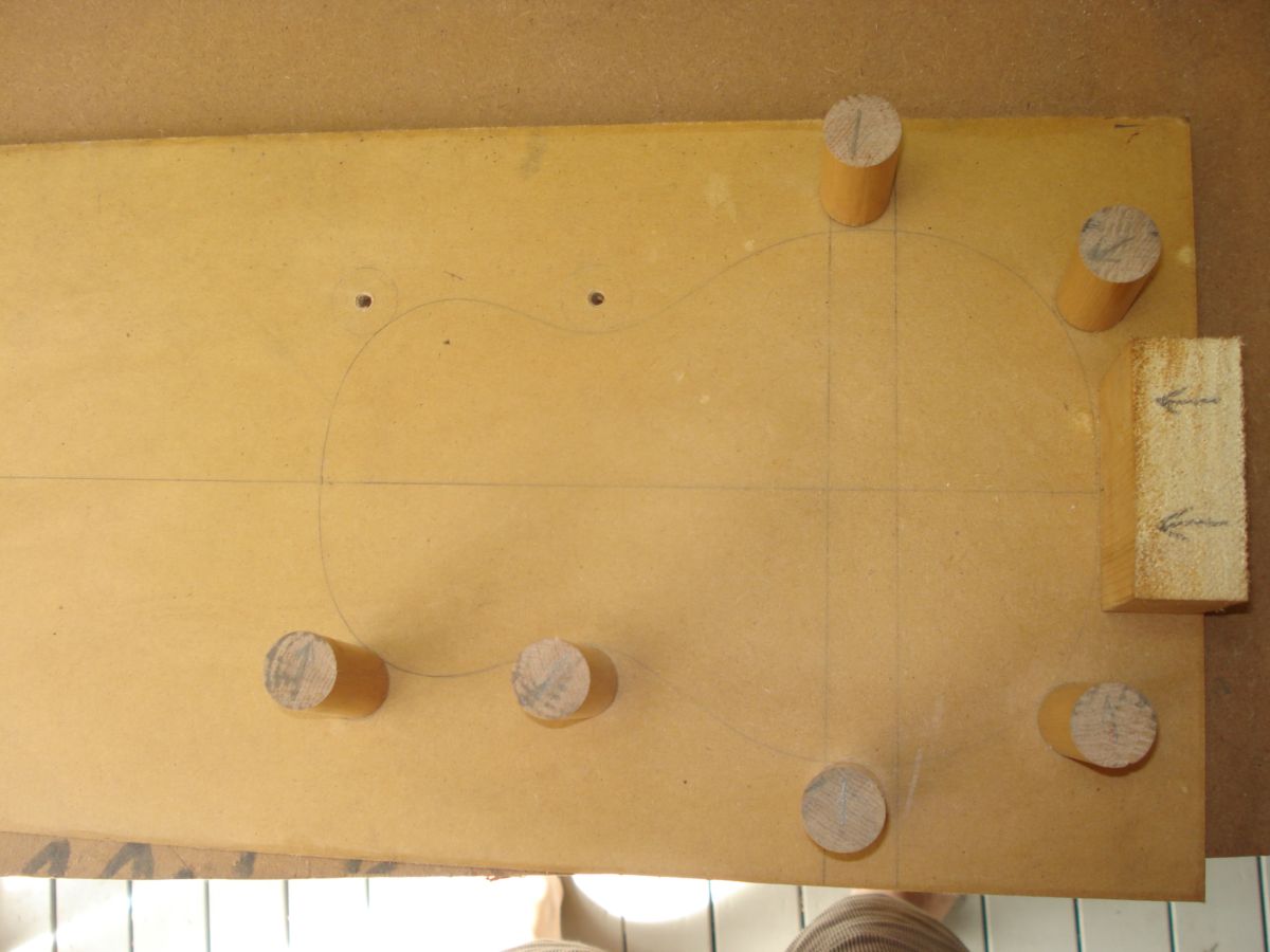

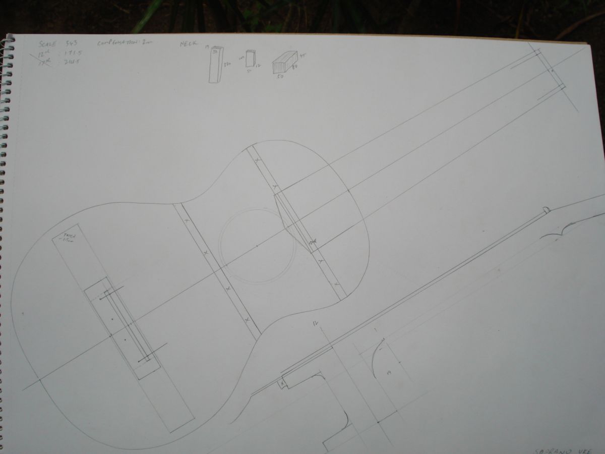

As I haven't built a soprano yet, the first thing to do was to draw up a plan and make templates and a workboard.

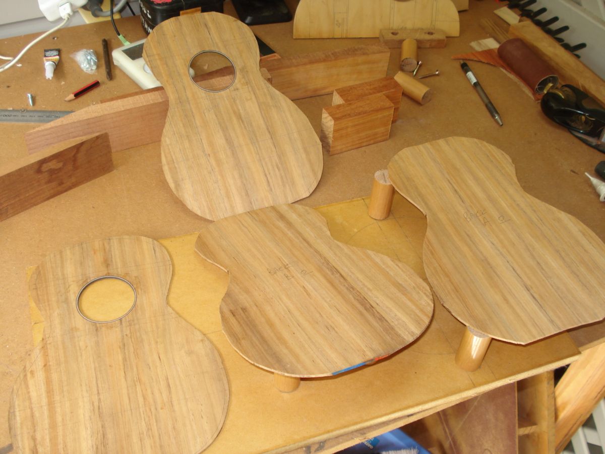

Mike decided on blackwood as the back/sides and top. I'm building two ukes just because I can. We haven't discussed fingerboard, bridge and binding materials so whatever he wants, I'll do the other a bit different just to give me some feedback on what different fingerboard/bridge timber will do on a soprano.
the Blackwood is a guitar set from Bob. There's enough for 3 sopranos if things work out.

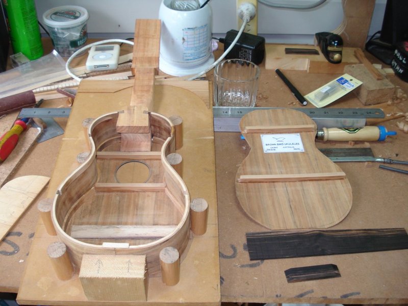

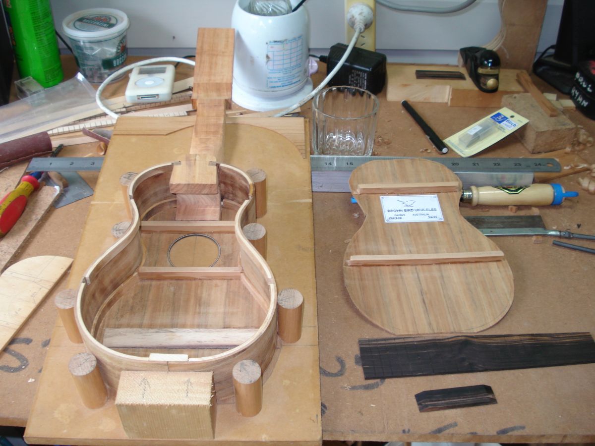

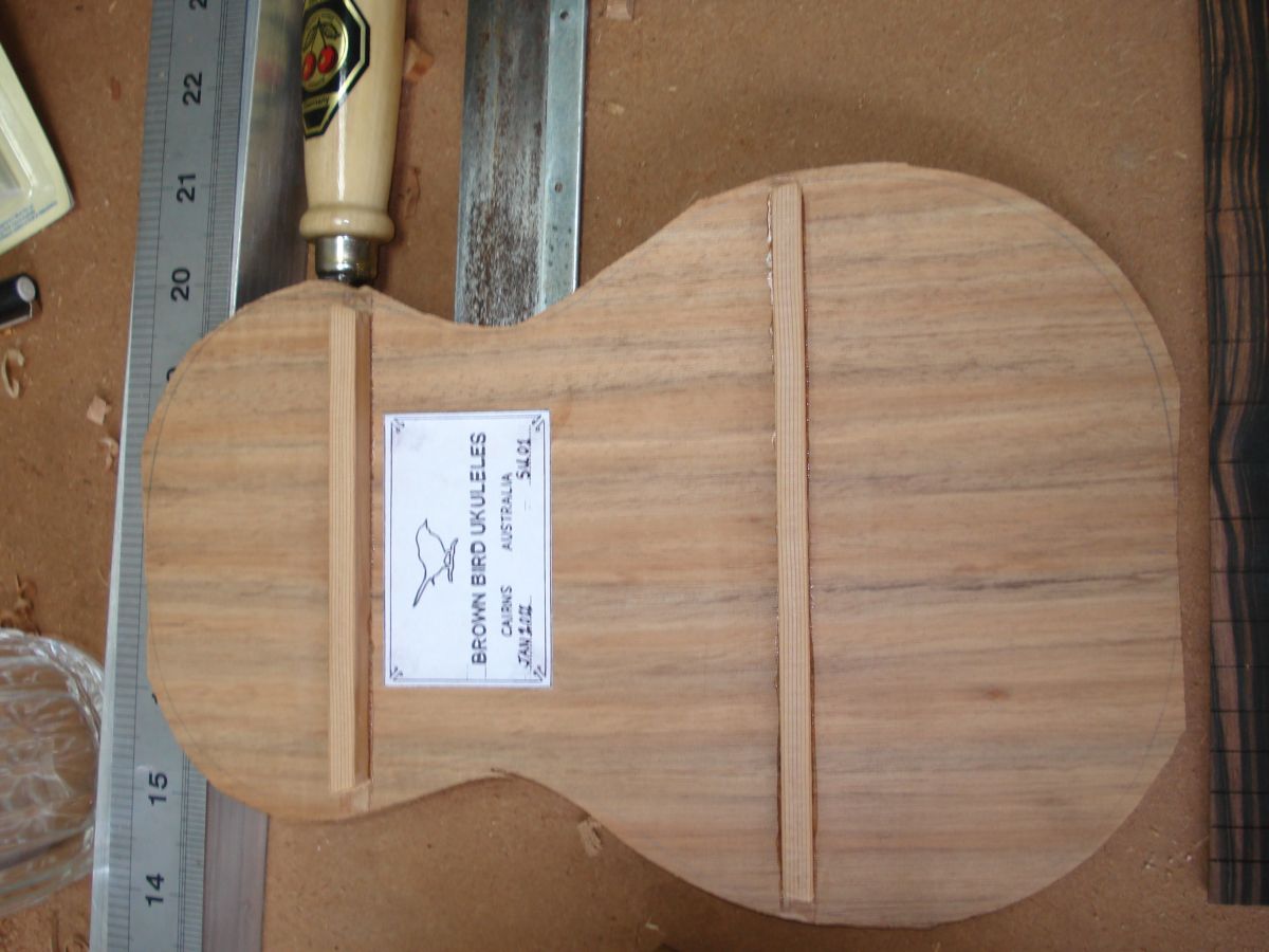

Howdy all, just a little update on the Uke. My Xmas holidays began a few days before Xmas and I've made it my priority to get the ball rolling on this project. I was also working on the old parlour rebuild I got from Jim viewtopic.php?f=23&t=2688
I was having a bitch of a time glueing up the cracks in the old guitar's soundboard. The weather in the week leading up to Xmas was all over the place. humidity was fluctuating from 60% to 100% every few hours. I'd get a crack all glued up and the next day it was popped open. Ggggrrrrrrr.
It was Xmas eve that I cracked too. I unwrapped presents til I found my dehumidifier. Within an hour I had the spare room converted into a climate controlled ukulele building facility all the parts for the parlour guitar and two ukes sat for the night to acclimatize.
By Boxing Day I was made aware that we would be having guests on the first and so the dedicated, climate controlled uke room would be shut down. All my focus shifted to Uncle Mike's soprano uke.

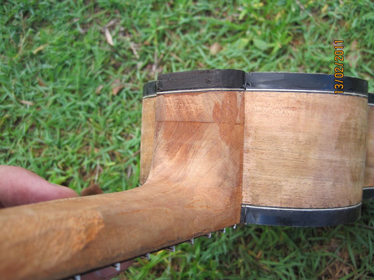

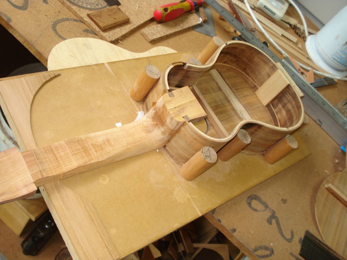

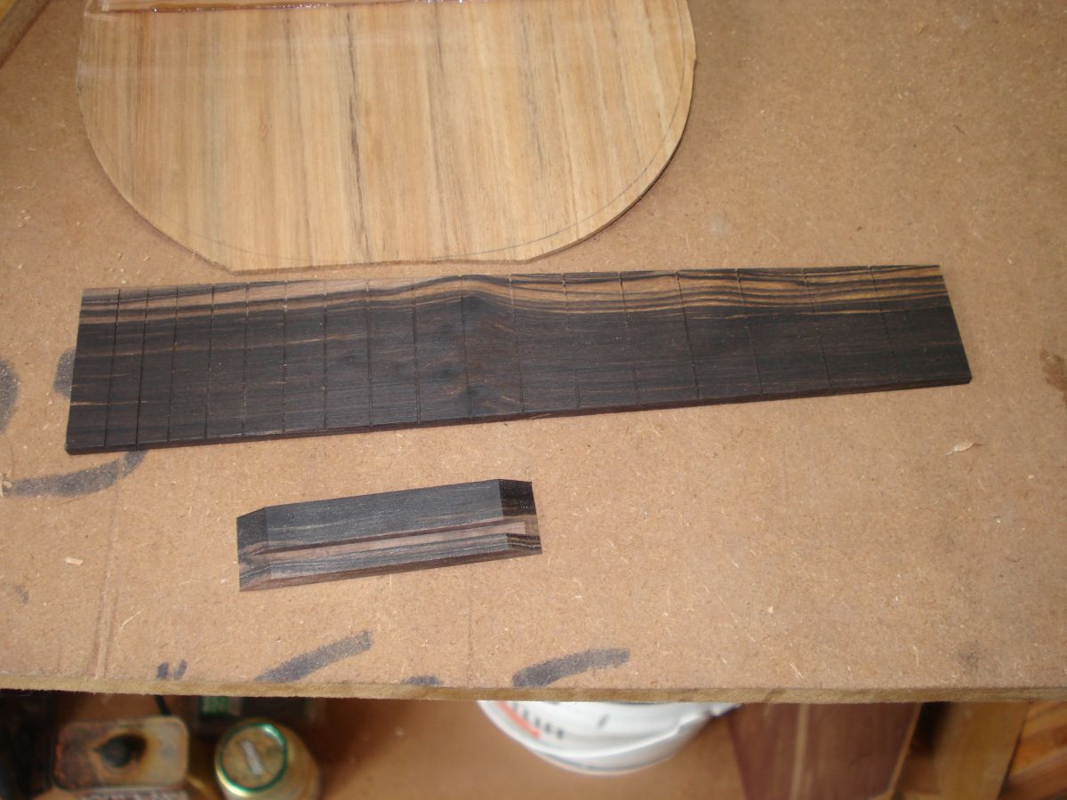

I had to cut the fingerboard to size so I could taper the neck so I could carve the heel so I could fit the sides into the slots in the neck. I use a Spanish Heel and a workboard. Once the neck was ready I glued it to the top. Then the top braces and bridge patch. The two back braces were sanded to 25' then glued aswell. The sides were bent one at a time and pressed into a half outside mold. This is where I glued on the solid linings. I'd previously had trouble gluing in the front linings in the workboard scenario. With the solid linings the sides were very ridgid.

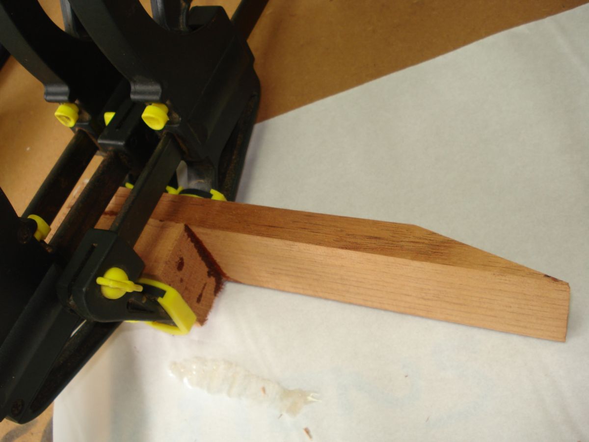

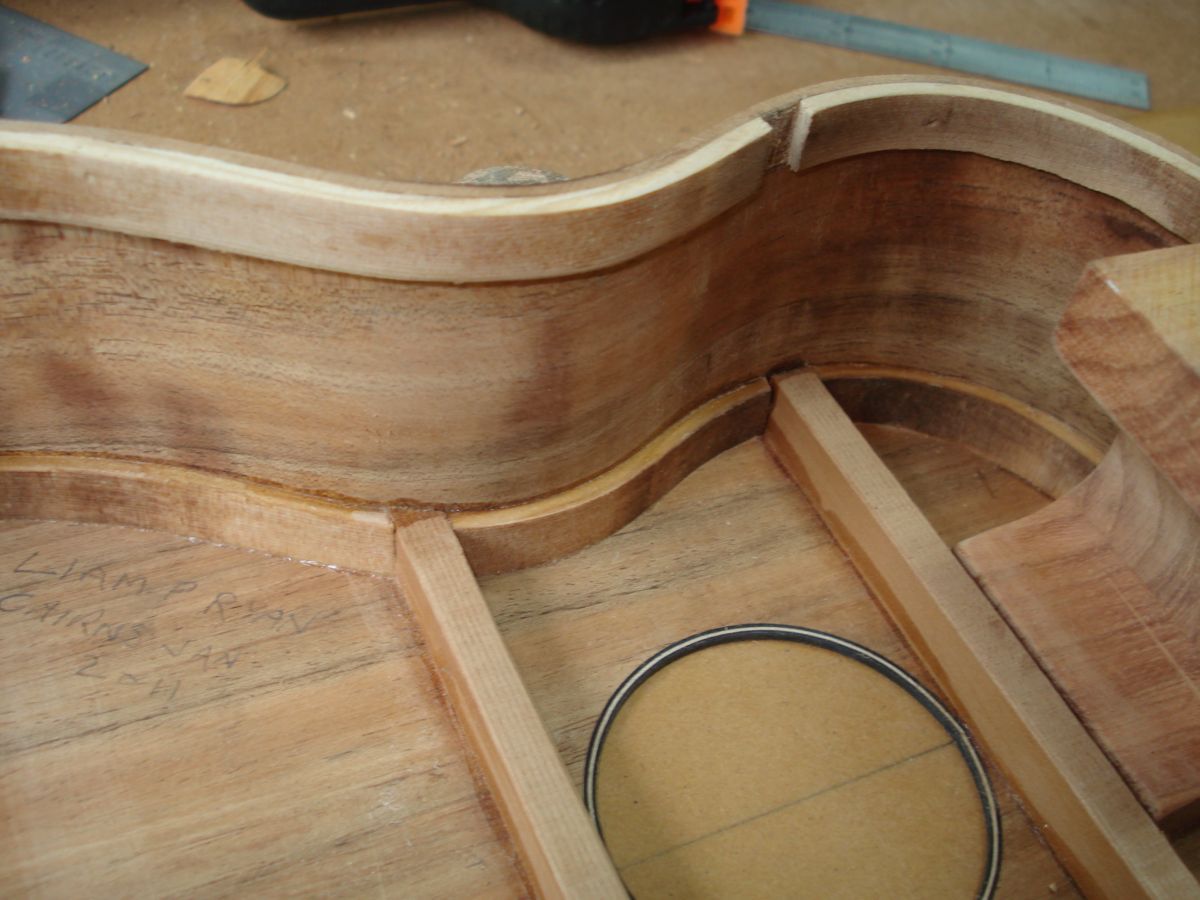

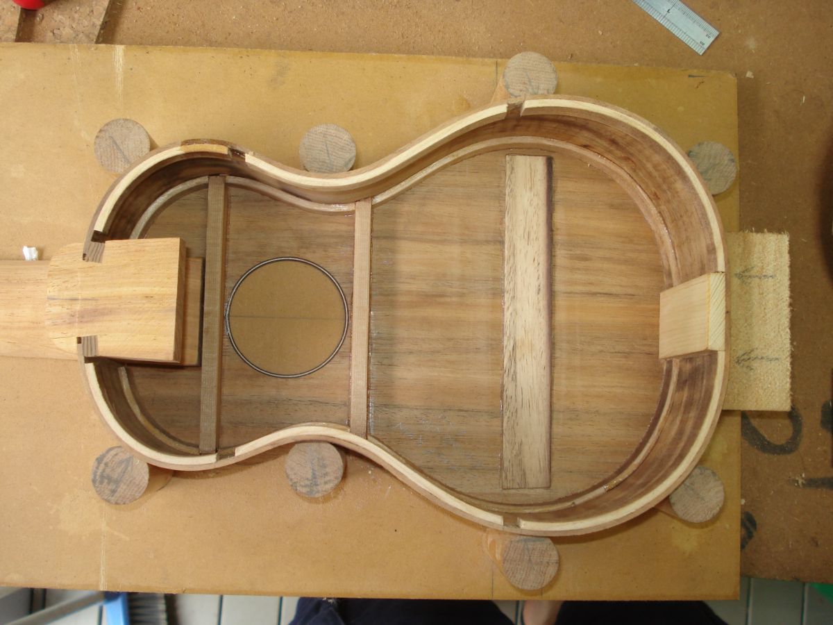

Next the tail block went in. Just a small piece of pine. I put waxed paper between the sides/tail block and the top/workboard tail black support post so I didn't glue the sides to the top or workboard. Don't ask how I knew to do this.
Next the linings were let in for the braces and the sides glued down to the top. Pre-made cedar wedges were driven into the neck slots to snug the sides against the neck-heel. The back has also been fitted into the back linings and is glued on as I type. All with 24hrs to spare before the dehumidifier is turned off and the spare room turned over to pesky guests

Nice going Liam ... what species are you using for the solid lining strips?
I can relate to an influx of visitors ... at the moment Perth is sweltering under consecutive 40 degree days, while Albany is basking in the much milder mid-20s, so just about everyone I know up there is heading south like a flock of migratory birds! Just hope the liver copes.

John, the linings are western red cedar. I bought a plank a while ago that was 1500x150x50 for $50. enough for about 30 uke tops plus a heap of bracing, linings etc. the plank was perfectly quartered and 30-40 graim lines per inch.
I bent the linings at 3mm on a hot pipe, the sides 1.8mm on the pipe too. the WRC linings were a little tougher than the blackwood sides. It may well have taken longer to bend the sides in a fox bender.

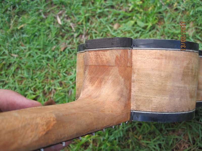

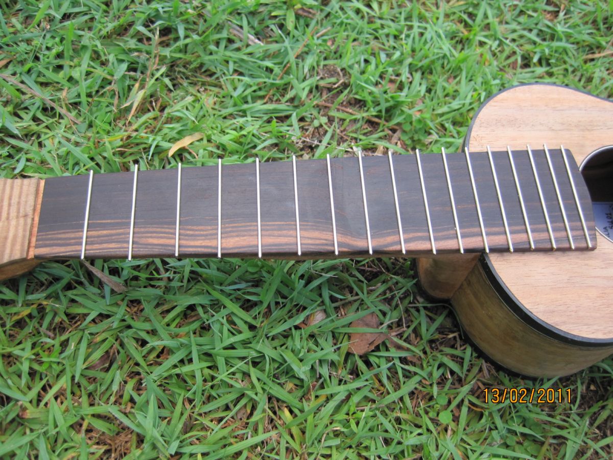

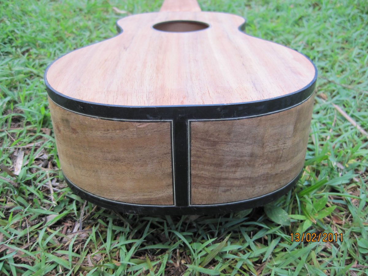

It's been a little while between drinks folks. Every weekend seems to have plans lined up for me, plus a cyclone and visitors so things are running a little behind. The box is closed, bindings on, neck rough carved and I've been getting re-acquainted with Mr Scraper. The frets are in and this week I hope to dress the ends.
That's a soprano uke next to the dog not a full size jumbo
Re: Uncle Mike's Soprano Uke
Looks great Liam, the fretboard...outstanding
