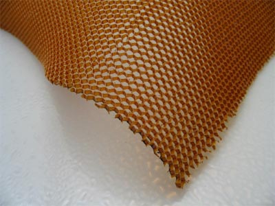

The Nomex is basically a separator, keeping the inner and outer skin apart just like the expanded cardboard honeycomb in a hollow core door.
No real additional strength in itself, but by making the sandwich thicker than the sum of the inner and outer skins, it increases stiffness without adding as much weight as a solid panel of the same thickness.

You could Jim, but nomex is aerospace material. I think it is supper heated phenolic resin that has turned to mostly carbon. They use it in jet aircraft wings and the body work of F1 cars...'super' light because it is essentially ash, but somehow still quite flexible. Once glued between light weight substrates such as carbon fibre sheet or spruce, it forms a very light yet incredibly strong sandwich. If you were to use it for a guitar with minimal bracing as I have described above, I would imaging that 'extremely' rigid sides would be the order of the day in lieu of the X brace or lower bout transverse.Toejam wrote:You could use a balsa lattice in the same way as the Nomex. Jim

Kim, some comments about nomex construction.
I will preface by saying I have not personally used nomex and have only researched it briefly.
It is probably most accurate to think of the nomex as a spacing material only, not contributing to the stiffness of the end result directly but increasing the effectiveness of the inside and outside plates by separating them.
Most seem to be using 40 thou inside and outside skins and 60 thou nomex
So you end up with a 140mm thick sandwich with pretty much the stiffness of a 140 thou solid plate but only a little heavier than a 80 thou solid.
This is a big advantage in a classical guitar in particular
In this configuration you could reduce your bracing but not eliminate it.
You could I guess increse the nomex thickness to give you a braceless top but then you would be stuck with a uniform very stiff plate over the whole area.

Re: Carbon Reinforced Lattice Bracing.
Hey Jeff,jeffhigh wrote: In this configuration you could reduce your bracing but not eliminate it.
As per my post above, the use of the word "braceless" was specifically related to that area of the lower bout behind the bridge, there was an upper and a mid transverse brace. On my old PC I had images of the same and the plate was not uniform by any means. Rather there was a central 'diaphragm' type configuration shaped somewhat like a pair of fused kidneys. This diaphragm extended out to a solid spruce outer ring or gasket if you like which fixed to the sides allowing it to be feathered in the usual way to introduce more movement into the top as desired.
I have seen similar on the net with minimal bracing constructed in the following way. You start with a top of regular thickness, app 3mm, and then rout out a section of the lower bout to within app 40mm of the outer edges. The nomex is then laid into this rebate with adhesive and, if I recall correctly, the 'nomex' is then reduces to the desired thickness via drum sander before the bottom, or inside .040" sheet of spruce is applied to complete the sandwich. The top I had referred to earlier used this system but had no bracing whatsoever after the middle transverse which sat just south of the soundhole
The point here is that in each of these examples, braced and unbraced in the lower bout the nomex was restricted to that area of the lower bout and I have never seen it extend to the rims. I think doing so would not only be dicey in regard to binding and the longevity of the instrument due to knocks and bumps, but it really would be taking things down the path of the resinator as Puff has suggested.

Randy Reynolds seems to use thinner plates and thicker nomex but then sands down the nomex
Both these guys are still using lower bout bracing
Seems like a lot of fussing around to me.
I do wonder whether it would be worth just laminating in a solid sheet of balsa?

The idea of Nomex appeals to me to a degree Kim and it could lead to a lighter soundboard, I am only just trying to get my head around the balsa lattice (even though I first listened to Greg about 17 years ago at Darwin Uni) but something new appeals to me so I might get around to Nomex one day. I did spend some time today taking a crash course in the material though cause you do have me thinking.
Do you know if the honeycomb luthiers using this method are using is phenolic foam filled or just straight honeycomb.
It is very light weight, about half that of balsa for low end balsa but around the same weight as extreme low end balsa. There is also a new Kevlar honeycomb which has better strength to weight than Nomex apparently, not that strength seems to be a issue here.
The balsa lattice thought was just a quick thought that I had not given any thought too but after looking at the weights (non filled Nomex) I found that you could, with balsa on its extreme end of its weight variation get the same weight as Nomex honeycomb (48Kg/m3) using end grain balsa (that is if you could use the same amount of glue) you could further reduce the weight using a longitudinal balsa lattice.

Good we got you think'in JimToejam wrote: The balsa lattice thought was just a quick thought that I had not given any thought too but after looking at the weights (non filled Nomex) I found that you could, with balsa on its extreme end of its weight variation get the same weight as Nomex honeycomb (48Kg/m3) using end grain balsa (that is if you could use the same amount of glue) you could further reduce the weight using a longitudinal balsa lattice.
I think the issue you would have, even if you did manage to get just the right bit of balsa is that the glue surface would need to be sufficient to support the wood. Nomex on the other hand has a 'very' fine edge to the form. This would require very little glue and it is the glue which carries the most weight.
- DarwinStrings
- Posts: 1873
- Location: Darwin
Yes I can see that and also that the end grain balsa might suck it up as well.....So that pic you showed is the stuff they use? no filling? it does have a very small glue edge, seems a bit scary to me though I suppose all up it is a reasonable amount. You still have not put me off the longitudinal balsa lattice idea though
