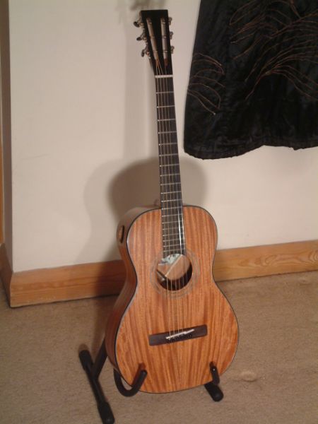

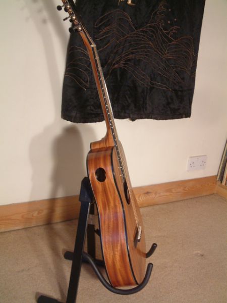

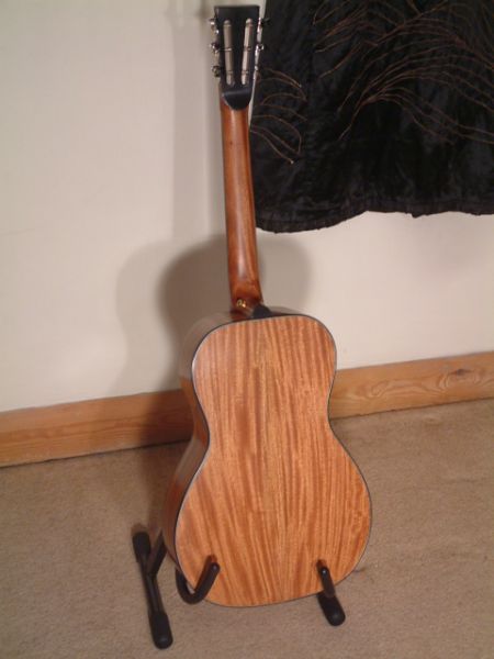

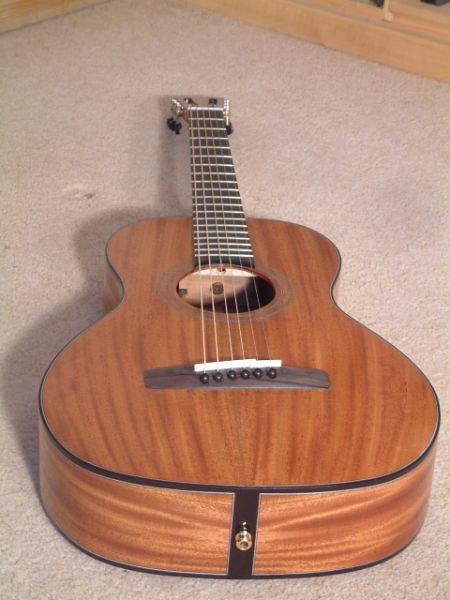

Apologies to OLF'ers as this will be a repeat. I've just finished this commission for a Cuban Mahogany parlour guitar (more properly a Concert or O sized) which was fun as my very first commission four years ago was the same model and woods. This guitar is a copy of an early 1900's American all mahogany guitar I have but done with my design X bracing on the top and X/ladder hybrid bracing on the back. I have also done a ladder braced version of this guitar.
Specs:
Top/back/sides/neck are figured Cuban mahogany, plantation grown in Micronesia (so it's almost Australian :lol: ). Side sound port. The neck is from the same block as the sides. The binding is ebony with bwb top/back and side purfling, ebony end graft, heel block and ebony venner on the front and back of the headstock. The bridge is Old Rio rosewood with split bone saddle and ebony bridge-pins. Scale length is 624mm (24.57"), lower bout width 335mm (13.19"), upper bout width 240mm (9.45"), waist width 205mm (8.07") and maximum body depth 95mm (3.74"). Tuners are Waverly's with ebony knobs. The finish is hand rubbed pre-catalysed lacquer over Z-poxy on the body and tru-oil over Z-poxy on the neck:

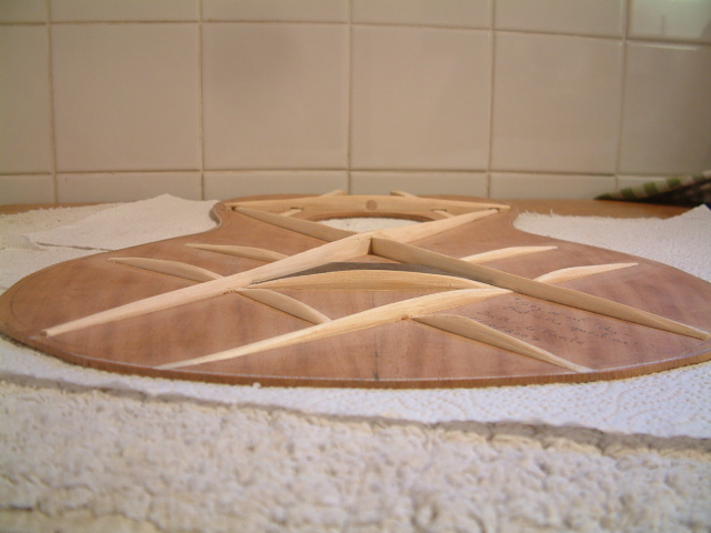

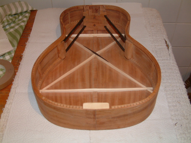

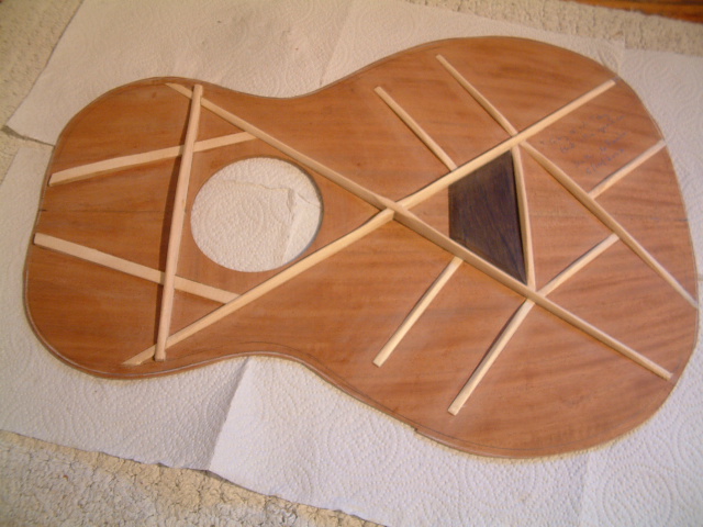

Bracing is my usual "triabolic" with hybrid X braced back with cf flying buttress braces:

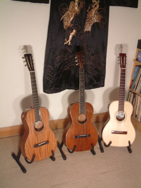

Here's the family - the original old boy in the middle, with the ladder braced version "Jack the Lad" on the right:

Awesome work and sound and man, what a nice trio!

Very nice, Dave. Those three really have a vintage look about them. Great job, my friend.

That's a gorgeous guitar. I really like the whole body in mahogany. And interesting bracing pattern. What sort of neck block does it get. Hard to tell from the photos. The way the upper bout braces are laid out it looks like you might have some sort of finger board support happening.

I do a fully floating neck, usually - but not in this case - with an adjustable neck system. The neck block looks like this:

Hey Dave, Looking Good here too man! I love smaller guitars like these.
I really like that Cuban top. And I guessed a Euro top :oops:
What is the thickness of the mahog. top?

Tnanks too. Part of the reason I did the "blind" sound clips was that mahogany topped guitars have a bad reputation with some builders/players. Hearing without any "visual contamination" is interesting. They make great guitars - especially if you want the bluesy growl - but you can also get great response, overtones and sustain out of them too. Also the top has Z-poxy on it like the b/s - and this is supposed to kill tone isn't it :D
I initially thicknessed the top to around 2.5mm and then went from there as the wood told me as I flexed and went through the bracing process. I have my tops thicker in the central bridge area and thinned out towards the side and back edges of the lower bout.
