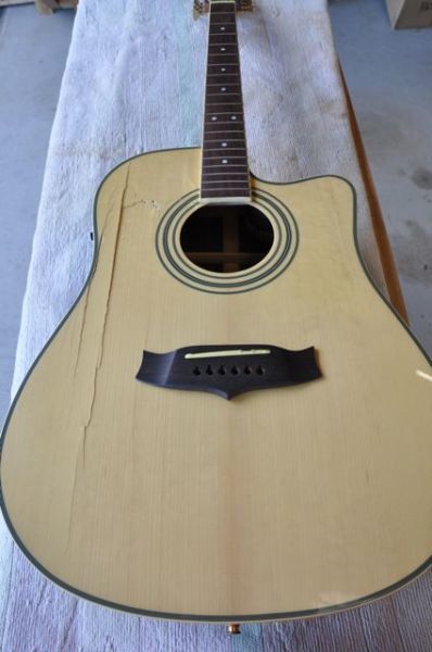

You can see that there are some pretty sever cracks running with the grain, but the worse is the cross grain break along the back edge of the upper transverse brace.
The finish on this thing must be some sort of polyester. It's as thick as the spruce and as tough as concrete. Can't be great for tone.

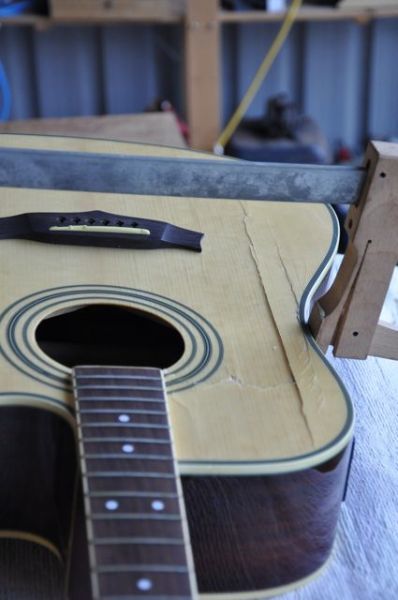

Another crack below the soundhole. This one isn't too bad.
img~
I tackled each crack one at a time, starting from the outside and working my way in using hot hide glue. This first one was particularly nasty as it was directly along the linnings. I had to do just the spot at the waist first, then put some blocks under that spot. Then tackle the rest of that crack on either side of the waist.
Once they were all glued up I levelled out the finish and then routed out some of the tip over the very worse of the cracks and glued in some spruce patches. Then levelled them out to the the existing top.
Tapping on the top after all the cracks were repaired revealed something not quite right inside, so I got out the inspection mirror and some good light and had another look inside. Found some cracked braces that were easily fixed with some more hot hide glue and a few clamps.

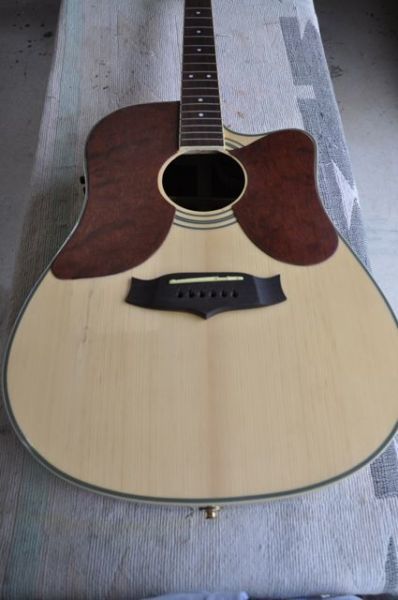

Finally I made some scratch plates from some figured Jarrah that I had on the shelf. Trying to hide as much of the damage as possible while still making them not look too hideous.
And this is the only crack that is left visible. There was chunks of the finish missing so I filled them with some CA and scrapped smooth. A little buffing and I'm pretty happy with the results.
img~
Not that it's ever going to be considered a pretty guitar, but at least it is putting it back in service for the owner on a budget the both he and more importantly I could agree upon.
