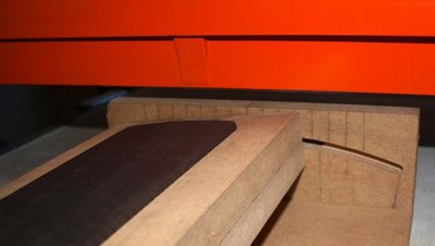

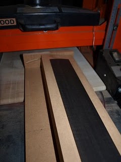

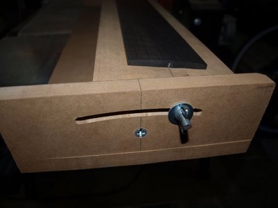

I "borrowed" this idea from somewhere or other and, with the help of my thickness sander and some double-sided tape, it gets me into the ballpark at least - a variation on a theme I guess. A Stew-Mac radiused sanding beam does the rest.

I have always thought that Rick's jig is well thought out. JJ gave an honest review of it after he constructed his. I liked it then and up until Pete posted his sanding jig, I was all over Rick's jig. It was going to be my next shop project. Now, I'm not so sure.
Pete, I think I'll have to see what I can do about giving your jig a test run. Its simple. It has a small footprint, which is becoming an important feature for jigs in the shop. And best of all I have a thickness sander already. I don't mind doing the clean up afterward with a radius sanding block, I just can't do the whole thing by with the block. It hurts my hands too much to do it all at once, which is why I can't do it your way Martin.
