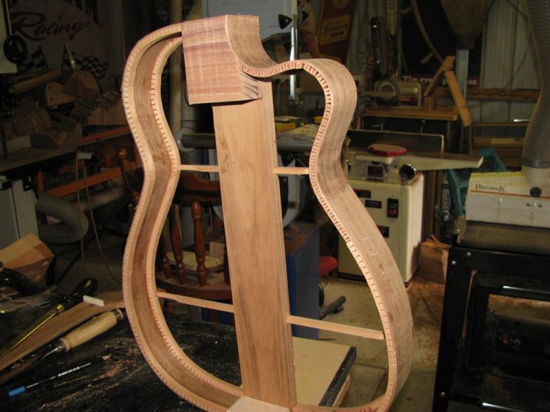

I've been threatening to build this for a while now.
An acoustic/electric for playing onstage. No soundhole, bolt on electric style neck.
Fairly hefty soundboard (3.5mm) Engelmann Spruce and two pickup systems.
K & K pure Mini Western plus an EMG UST pickup both wired to a stereo plug. i'm going to run the two signals into a Dtar Solstice pre-amp and from there to two channels in a desk or Acoustic amp.
Finished the neck today as well so I'm waiting on the pickups to arrive to install before I glue the top on.
Not going to bother with bindings or anything fancy on this. I'm more interested to see what it'll sound like (so it'll get trashed if it sounds like crap) :D

Hell of a hefty back on that one Bob. Never seen the insides on something like this. I'm guessing that helps with feedback issues when you play it loud?
Re: Acoustic/Electric Prototype
Post by Bob Connor » Wed Nov 03, 2010 6:38 pm
That's right. No vent. The Takamine I play on stage has a dirty great lump of rubber in the soundhole (Feedback buster)
I was tempted to throw sound port on one of the sides but I'll try it like this first.
Allen - that big lump of blackwood down the centre is to take the back out of play as much as I can. The back itself is standard acoustic guitar thickness (.090")
Which leaves the top as the main influence on the sound.
This is very similar to what Rick Turner does in his Renaissance instruments and is where i got the inspiration to try something like this.
The top on this is dead flat as well - no radius.

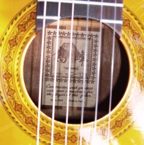

The headstock of mine has Takamine written on it.

Indeed Bob, as does every single guitar I have ever played or worked on produced by that company, all without exception read TAKAMINE.
http://www.takamine.com/

I doubt it. There actually isn't a Mr Takamine. Takamine is the name of a mountain near the factory located in Sakashita, Japan. Takamine translates as "high ground or mountain".
The main person behind Takamine is a Mass. Hirade who joined the company in 1968.

Ahhh so, that explains the mountain on the label Martin san.
taka label.jpg (194.44 KiB) Viewed 19284 times
Axe looks good Bob, perfect stage fettle me thinks, no feedback from that little sucker.

Post by Bob Connor » Wed Nov 03, 2010 6:56 pm
Finished the top today. Quite strange without the soundhole.
The aim here is to leave the top stiff enough so that it doesn't feed back but still has some bottom end so it sounds like an acoustic. As I've never done one of these I'm just guessing.
It's Engelmann from Graham Hein so it's nice and stiff but light. I left at 3.5mm thick which is about .5-.7mm thicker than I would normally. I left the Osage Orange bridge plate a bit thicker at 2.5mm instead of 2.1mm.
I didn't scallop the braces at all.
After much head scratching and looking at the spot where the soundhole should be I threw in a couple of braces the to counteract any rotational forces from the bridge in that area.
The Takamine has a Maple top on it and sounds pretty average acoustically (and quiet due to the weight) so I'm using that as my point of reference.
I also found a supplier in the US who would sell me an EMG AT93 UST pickup for this. Most of them won't sell OS due to some agreement with EMG.
