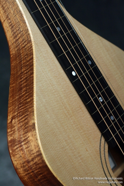

There were original Weissenborns with spruce tops. Of course with the way that spruce and lacquers age, most of these that remain today have naturally yellowed to the point that they blend in with the Koa and so aren't as conspicuous as a brand new spruce/koa combo.
Bunya isn't my favourite wood but I have built many Weissenborns with it and it makes a great sounding instrument. I can't say how exactly it'll sound in conjunction with sassafras, but you can probably expect it to provide an overall brighter sound than sassafras alone.
In the end, the answers to your questions by and large come down to personal aesthetic and tonal choices. Just stick with an appropriately hard and stable wood for the bridge -- I'm guessing Tim will have a number of native desert hardwoods that might work for you depending on the look you are going for.
You have a lot of options with the fretboard on Weissenborns because wear and tear (or even strength to an extent) aren't critical factors like on traditional guitars. Any stable hardwood should do the job; it's common to use the same wood as the top/back/sides as on original Weissenborns, but with a bunya or spruce top I'd say a darker contrasting wood might be idea for the fretboard, and in this case it's probably best to match it with the bridge.
At the moment I'm really liking the neat, modern look of spruce/blackwood with ebony fretboard/bridge on Weissenborns:
