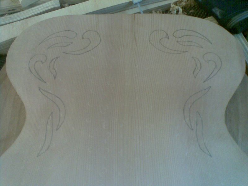

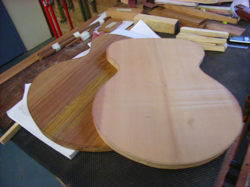

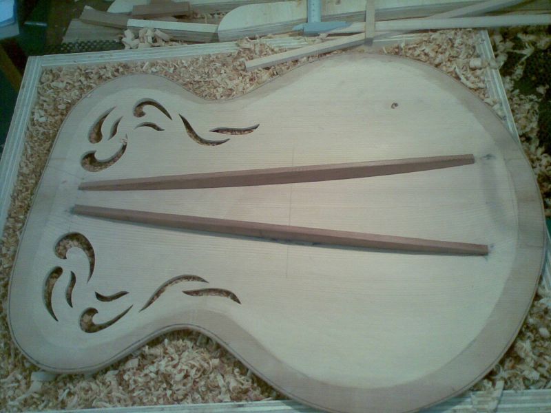

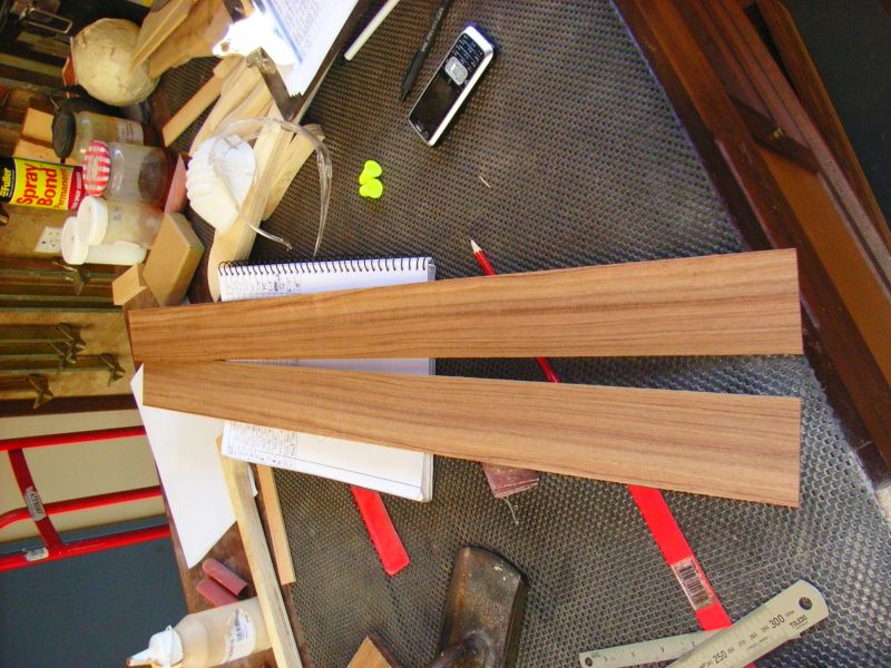

pictures are here, so far so good. Its been a big learning curve so far. and the photos got jumbled but. but you can get the idea of whats going on.

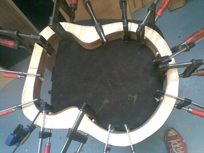

I dont have a bending iron but the workshop has a steam box. so i used that. Are there or will there be any problems with that?
This will be a pretty quick build. The project has to be done by the 3rd of December for an exhibition so ive been working pretty hard to get it all done.
For any one how lives in perth. i will post details about the exhibition and you are more then welcome to come have a look at this in person and see the other stuff that myself and other students have been doing over the past 2 years.
Aidan :D
top and bottom ready to carve
bracing done
f holes cut
F hole design
sides bent
sides ready to go

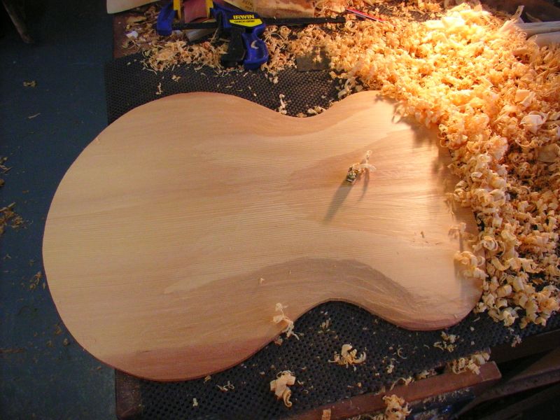

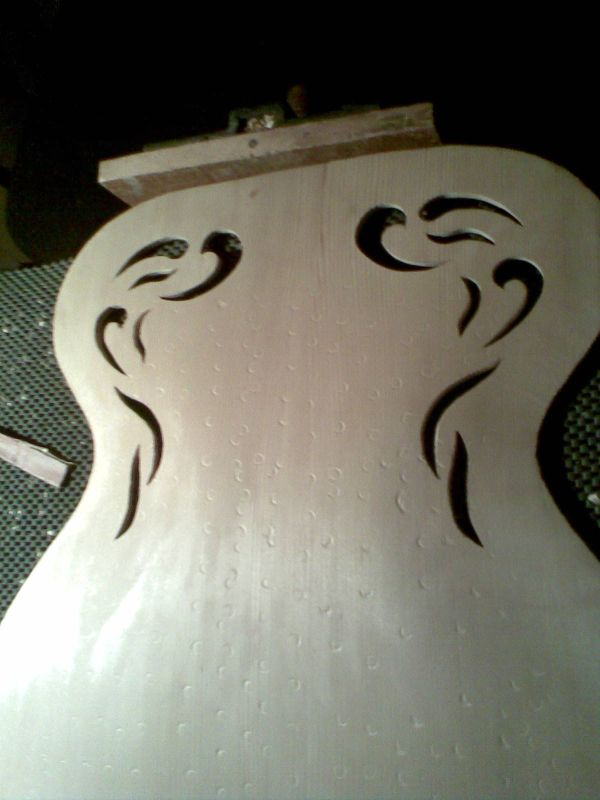

carving carving and more carving

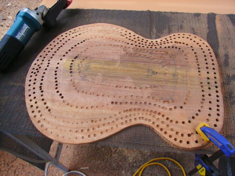

carving the back, the use of a friends carving tool thingo helped alot

AidanHarris wrote:I dont have a bending iron but the workshop has a steam box. so i used that. Are there or will there be any problems with that?
G'day and welcome Aidan, I have only even used a steam box to bend much larger pieces of timer than would be used in a guitar but there should be no problem with the method you have used other than burning your fingers when you get it out of the box. Any method that gets it bent without breaking it should be fair enough.

Looks like you're doing very nicely there Aidan, i like the sound hole set out you have too, looking forward to seeing more pics as you progress.
Cheers ,,,Rod.

Wow. Just wow...
I like the use of the drilled holes in the back - which I assume is about getting the thickness/depth of the carving consistent, right? I had wondered how one would go about that. An elegantly simple solution!
The f-hole design looks fantastic - just a bit different without anything too extreme/radical. The choice of timbers should look good too IMHO.
If this is your idea of a simple first build, I for one can't wait to see what comes next! :cl
Ian

hey, thanks, it is shaping up.
the drilled holes are for getting the arching close on the top, and then holes are drilled in the bottom to get an even thickness to start with.
lets hope future guitars get better :D im hoping they will. I have a few things stacked in the shed that could be turned into somthing nice.... I hope :P

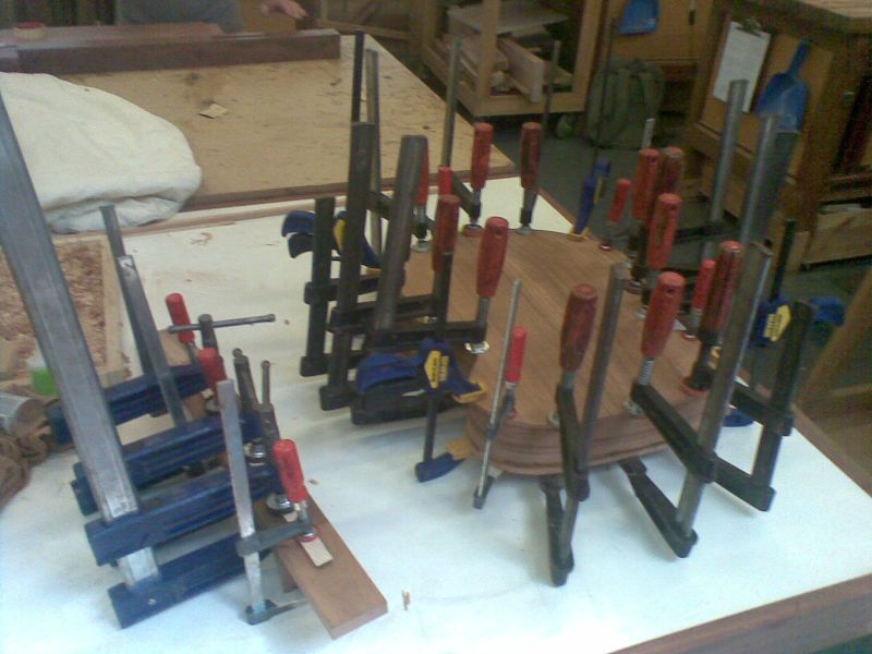

This last week has been a little slow in progress, I glued up the body and have been sanding and shaping the last bits. I was a bit nurvous scraping the re-curve and probably havent gone down deep enough with it in places but im scared of going that little bit too far and getting another sound hole in a place i dont want it :P.
I glued up the neck, cut the dovetail and glued in truss rod and now have to wack on the fret board. I got a prefretted one from Gilet guitars and it looks really good, ou of all the guitars i own none of them have an ebony fretboard. It will be good to have a change.
