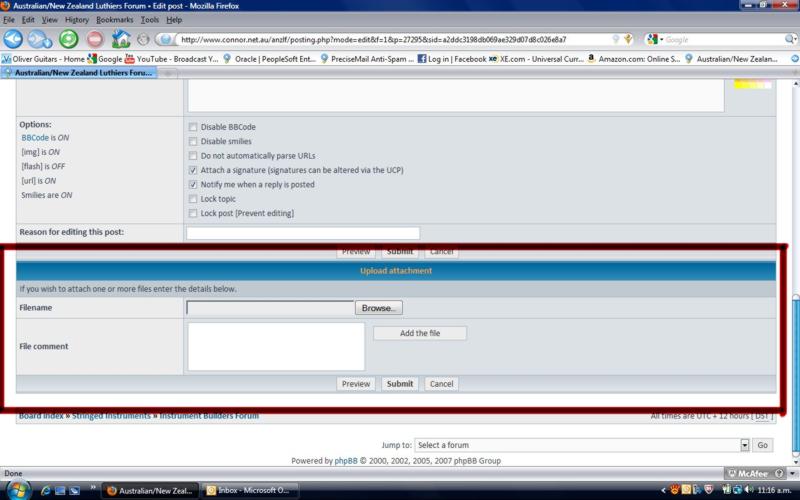

Tim, the new software version has an area below (if you scroll down) the posting area that says "Upload attachment" with sub headings "Filename" with an associated 'BROWSE' button & "File comment", once you've guided the software to you picture file on your 'puter just click on "add the file". It should upload your picture & display it in the forum as an attachment once you've hit the submit button. A little different than the old version I know but version 3 is a lot more stable platform so we have to make these little sacrifices :wink: :) I'm still feeling my way around it as well.
It should work for you.

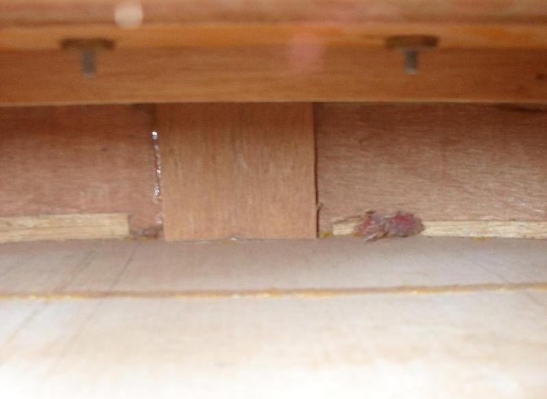

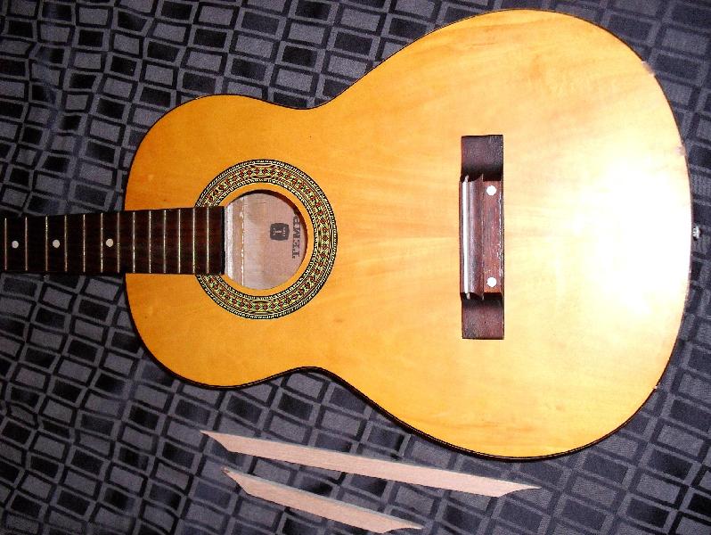

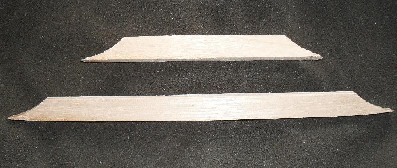

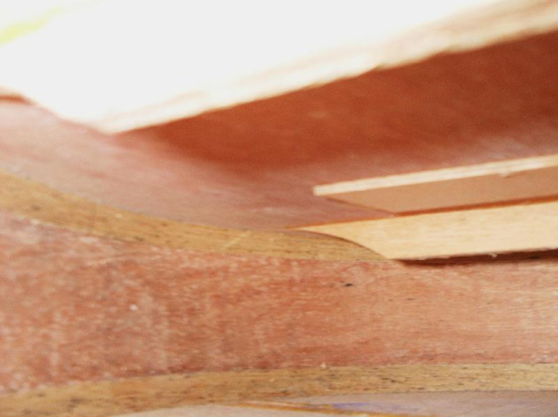

Ahh... I see it now :oops: I should mention the bracing has come from the back, one close to the soundhole and the larger one closer to the ebd of the guitar.
Ok here goes
As you can see here the butt joint is looking a little shady :shock: :?
That is the glue line from one of the braces on the backing.
Ok, that took me an hour to resize and upload, time for lunch me thinks :gui

Yes the fact that the fallen off bits fell off the back does modify things a bit :|
