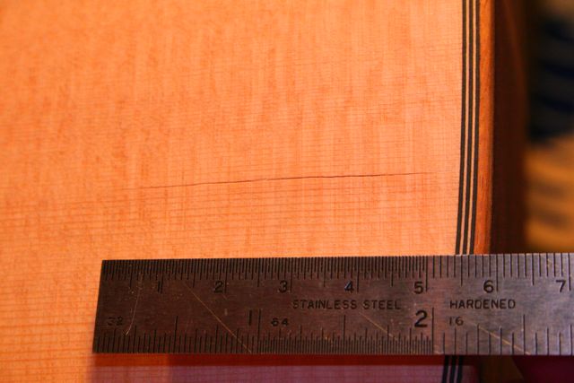

Tonight I noticed there is a split in the soundboard, which has only just appeared. It was definitely not there 2 nights ago !! The box has been closed up for approx 5 weeks and the soundboard had been in the workshop for about 12 months before that. I do not have a humidity controlled environment, but I am not at all convinced that this is due to humidity changes anyway. Prior to joining the top, there was a split in one of the plates, roughly along the same line as where this has appeared. When I traced the position of the top on the plates I made sure that I cleared the split piece by at least 1 cm - but maybe there was a structural fault along this line.
Anyway - the split is currently very thin - but who knows what will happen from here. It runs for about 4 cm - from near the heel block through to around where the lower of the two tone bars crosses. When you tap on the guitar you hear no difference in sound around where the split is.
Is there anything I can do about this - or is it firewood !! Would CA glue be any use - I guess the issue of staining would be a problem. It would be very hard to get a patch on the inside due to the position - and I am not sure what effect that would have anyway.

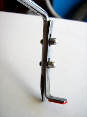

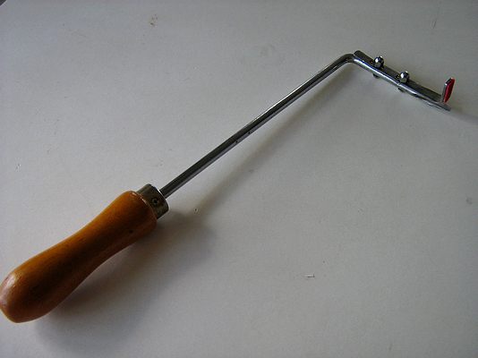

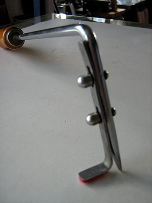

liam_fnq wrote:hey Craig, any chance of a pic of this v shaped chisel you made
I made this many years ago . It needs another sharpen !. The Pics aren't crash hot but hopefully you'll get the idea .
I use a delicate pull stroke with very little pressure so as to cut the wood rather than compress it .
A little piece of felt on the depth stop to save marring the soundboard
You may be able to notice I've filed a V notch into this pullside of the blade , but this probably isn't necessary. Establish a good burr
