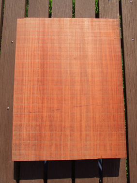

The 'African Rosewood' you mention using is most likely what many here would know as 'Bubinga'; in other words a Guibourtia Spp. Not a true rosewood, but it is used regularly for guitar making. You should have no problems with your intended use that's for sure - it's a beautiful timber. It is also comparatively cheap to acquire in board form still which is a bonus. 'Chambering' the piece is a personal choice but there would be many heavier guitars out there anyway.
The only other timber it could be off the top of my head, is Paduak; the Pterocarpus family. This is occasionally referred to as African Rosewood too but not commonly. I doubt your piece is Paduak though as from the image, it looks more like Bubinga. I could be wrong of course :wink:

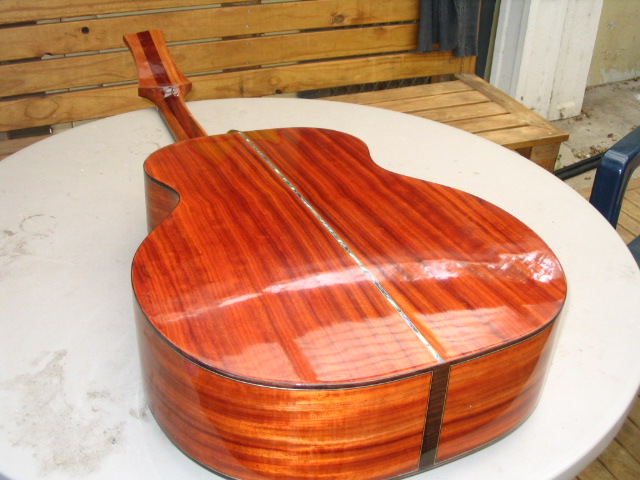

Post by Bob Connor » Wed Oct 21, 2009 10:33 pm
Australian Furniture Timbers call Padauk "African Rosewood"
I've got some that looks a lot like that pic.
It's a great wood for acoustics. Don't know how it would go as an electric wood.

Post by J.F. Custom » Wed Oct 21, 2009 10:43 pm
bob wrote:Australian Furniture Timbers call Padauk "African Rosewood"
See!! Told you I could be wrong :D
Wasn't aware of any suppliers here calling Paduak African Rosewood but there you go. The timbers can look similar - your image looked like a friends guitar that he thought was Bubinga. From what Bob says, he may have been wrong too.
Perhaps one way to check, other than questioning the supplier... As far as I'm aware, Paduak when freshly cut or planed, is less colourful or vivid - much like Purpleheart is. However it oxidizes and gains that deep rich colour it is known for, reasonably quickly. At least, the pieces I have did this. I'm not as familiar with Bubinga but, though most timbers oxidize to some extent, I am not aware of it being as pronounced.
All said, I'm with Nick - give it a go and see what it is like.
Post by Bob Connor » Wed Oct 21, 2009 10:54 pm
When it's freshly planed it's a vivid red/orange and it dulls down to a reddy brown after oxidisation.
This guitar is about three years old now and it's gone quite dull compared to these pics
