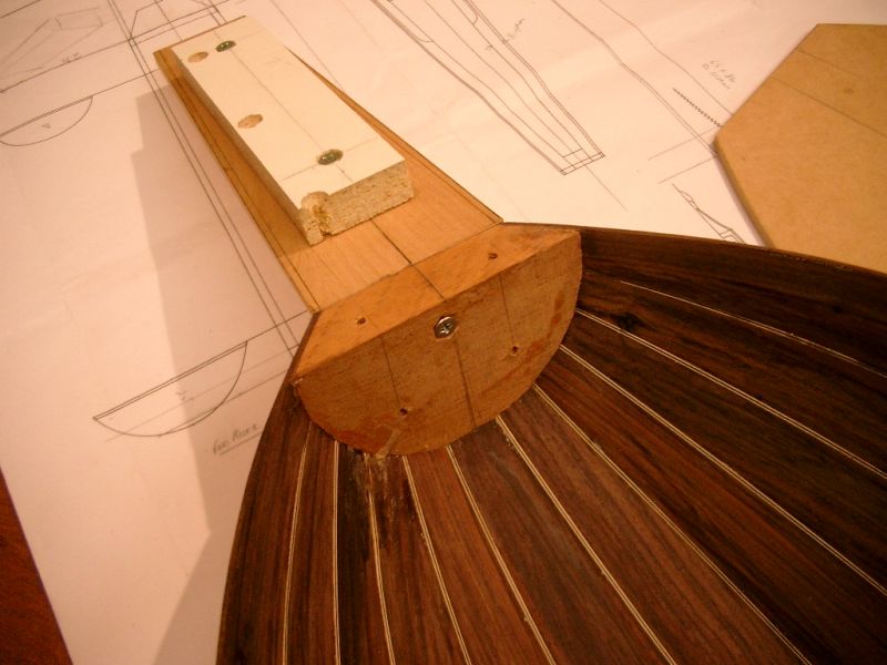

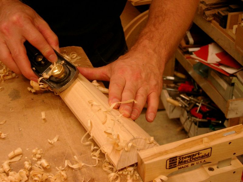

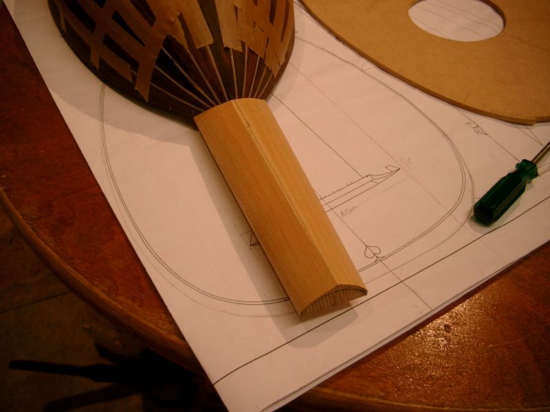

Got a few hours in the shop today so rough shaped the neck. I popped into Ottos here in Adelaide last week and managed to find some limewood of the right dimensions for the neck (Thanks to all of you who offered assistance in my search for neck stock).
The neck blank gets temporarily fitted to the neck block with a wood screw to allow marking up of the blank for shaping. Once the neck gets glued on the screw aids in clamping the joint together while glue sets.

The inside of the shell looks terrific. Have you got the seam re-inforcemts installed in the body yet? Silk I think is what Dave White used?

Havent got around to gluing in the rib reinforcement. Silk is one option ...parchment paper is the other. Silk is the easiest option but Im still working out how to explain to the wife about the shredded nightie.

Yes the neck to body joint is a butt joint...hide glue with a dirty big 60mm x 10G screw to hold things together while the glue sets. Not much tension to deal with with gut strings so no need for a fancy joint.

On mine when the glue had dried I drilled two holes through the neckblock into the neck and glued dowels in (I was following Obi Wan's instructions). Although the strings are nylgut or gut there are 15+ of them so there is a reasonable tension there. I reasoned that a little extra "insurance" doesn't go amiss even if it may not be necessary - it's not easy to do after the top is on :shock:
Clamping the joint was "interesting" by the way 8)

Would it be historically acceptable to use a wooden dowel in place of the screw in the finished neck joint? Would give that end grain glue joint some sheer resistance if it was knocked.

Dave, Im seriously considering whacking in a couple of dowel reinforcements through the neck block/neck. Thak=nks for getting me thinking on that one.
Dom, Ill keep the screw as it functions to help clamp the neckblock/neck joint together while the glue is setting. Getting conventional clamps to work in this joint would be very difficult given the angled nature of the joint.
