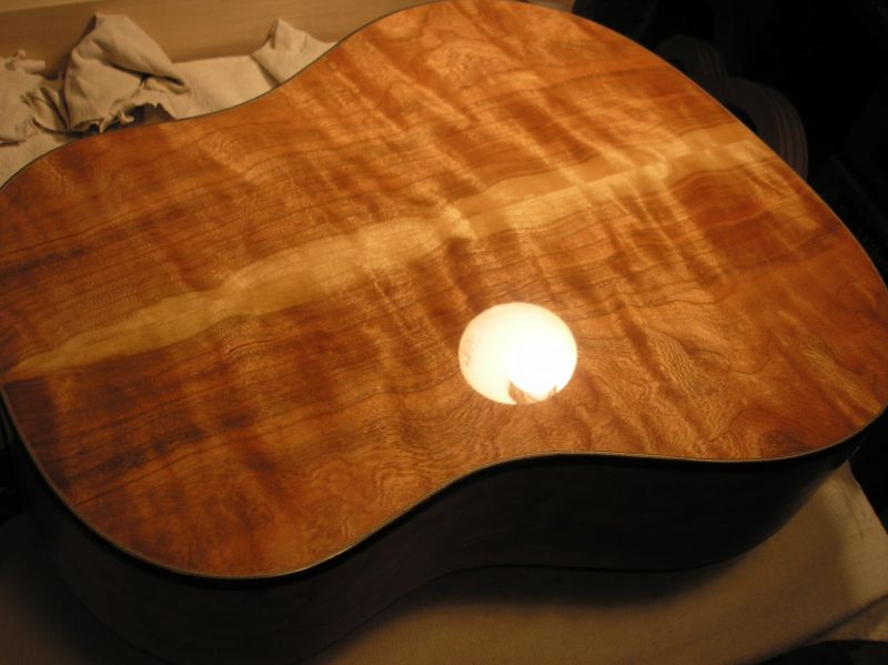

Haven't had one of these threads for a while and i haven't built anything since February due to wet weather and building a climate controlled room in the shed.
I started this yesterday. It's bound for Britton Brothers (sawmillers in Tasmania) and is supposedly to hang in their office. I'm reliably informed by one of the blokes in the mill that this'll probably end up at the bosses house. :D
It's a OOO with Blackwood and King Billy that'll end up with Cheesewood bindings (all the wood is from Britton's of course)
The sides are doubled (laminated). Each layer .060" for a total of a little over .120".
Because they are so thin when I bent them I didn't bother to spritz with water, just wrapped them in butchers paper and bent them dry. I think they tend to warp less with no water.
They hold their shape pretty well.
I glued them with Titebond and just strapped them into the Fox bender. I'm looking forward to getting hold of a vacuum setup in the next couple of weeks.

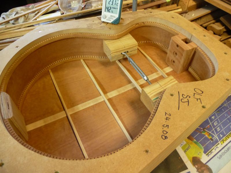

I've been doing nothing but wait for the RH to come up. It's been around 27% for the last couple days (ever since I was ready to close up the box). Had some rain last night so today might be the day.

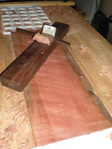

Had another crack at resawing some tassie myrtle after modifying the farme saw. the saw looks more like a "proto-type" than a real tool, but it did the job.

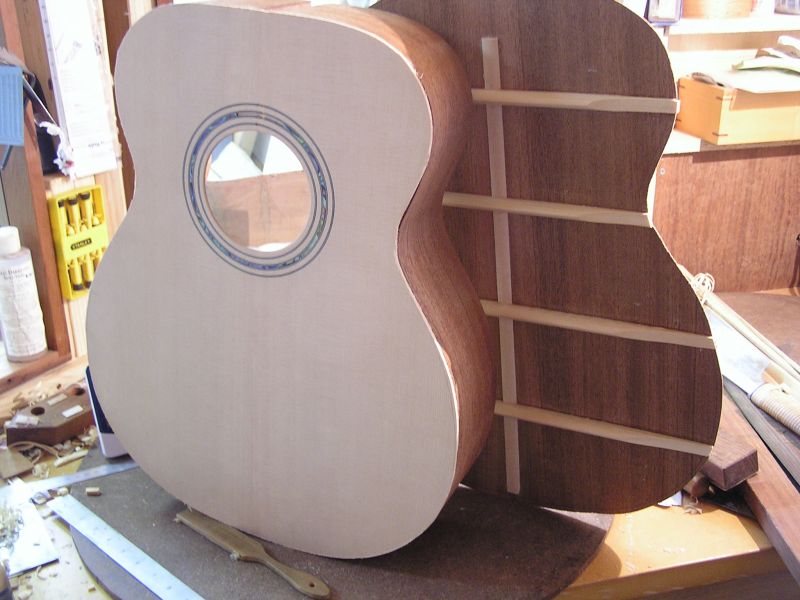

I am working on an OM with AAA sitka top and Brazilian Mahogany back and sides. The binding will be figured blackwood and ebony bridge and fingerboard.

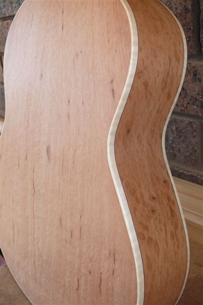

Getting closer to finishing a kids-sized classical. Put on the fret wire, attached the fret board & shaped the neck this weekend.

Steve wrote:Getting closer to finishing a kids-sized classical. Put on the fret wire, attached the fret board & shaped the neck this weekend.
Interesting look there Steve.....its very blonde :D
What are the woods?
Posts: 165
Location: Coffs Harbour, NSW
Post by Steve » Sun Oct 18, 2009 5:54 pm
kiwigeo wrote: Interesting look there Steve.....its very blonde :D
What are the woods?
WA Sheaoak, Engleman Spruce, silky oak neck, gidgee fretboard & some maple bindings. I've been looking for a local equivalent to maple for bindings - any suggestions? I saw some silver ash (?) in some marquetry once that looked similar.

Post by Joe Sustaire » Mon Oct 19, 2009 12:18 am
Boy Craig, I'm impressed!!!
That's really getting to know your wood, sure turned out nice!
What are you using for the blade in your saw? I don't have a large enough bandsaw for re-sawing backs either, may have to give this a go.

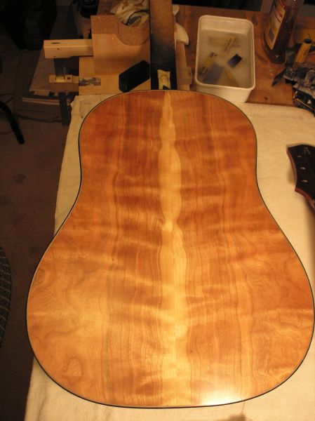

Post by Dave Anderson » Mon Oct 19, 2009 1:39 am
Hi fellow wood monkeys,
I'm wet sanding /buffing this same cherry "Concert Jumbo" I've been farting around with for the last few Months!
And I made the mold and bend pattern for my next - Grand Concert.

I got the back on yesterday! After waiting forever for the RH, the rain the night before did the job. And since I'm currently employment challenged, I'll close it up today, I'll try to take a pic.
Craig, those frame saws really give you a great upper body workout don't they? I built one and resawed a set of jarrah backs. Never again! I went out and bought a 18" Jet bandsaw after that.

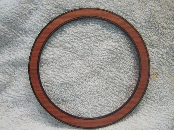

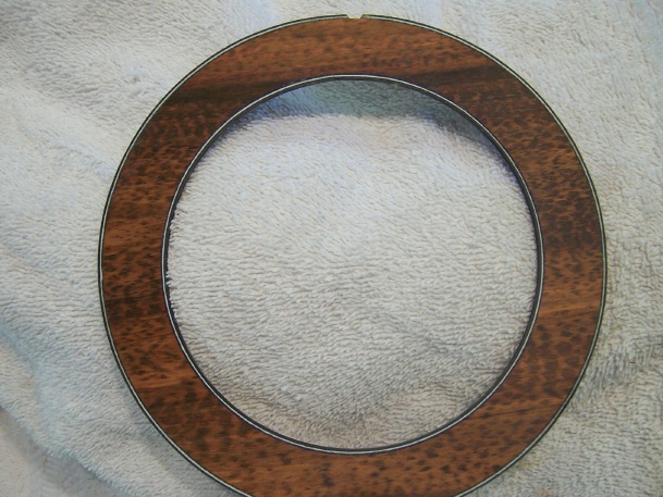

Some nice looking stuff here. I finished up three rosettes and a bridge this weekend.
Ron
Bloodwood
Snakewood
Blingwood (in macassar)
Macassar bridge
