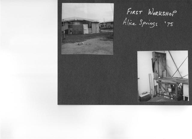

Want a laugh? heres my first workshop in 1974-75, just for repairs at that time.
I've had a few shops since then, all tin. Except for a luxury one I built along with the house at that time, out of rammed earth, walls were 300mm thick and roof so high I put in a mezzanine floor.
Those were the days, but the cook wanted to move to Queensland so it was a case of start all over gain.
