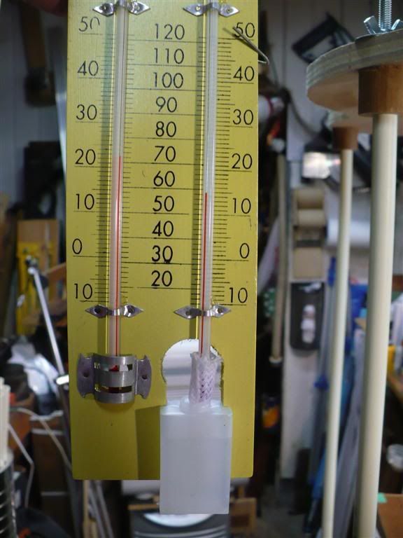

Post by WaddyT » Tue Oct 13, 2009 1:06 am
This is how the one I bought on ebay for about $12.00 looks. Simple enough. Ambient air, dry thermometer, and wick with a bottle of water and an air passage for the wet bulb. I just put mine in the path of the fan I keep running in my shop all the time. I have two separate charts, and use the average between them. Only minor differences though. I'm sure altitude has something to do with the differences, and there are probably altitude corrected charts somewhere, but I don't know if it makes a lot of difference.

pat foster
Posts: 79
Post by pat foster » Tue Oct 13, 2009 6:41 am
Hesh,
Mine looks a bit like Waddy's. I use distilled water to minimize buildup of dissolved solids in the wick and also because there's always a gallon container of it for mixing HG.

Clancy
Posts: 620
Post by Clancy » Sat Oct 17, 2009 8:16 am
Hey Waddy, they look like alchohol thermometers. I'd be surprised if that even come close to an accurate reading.
It it's not mercury, it's not a thermometer!
