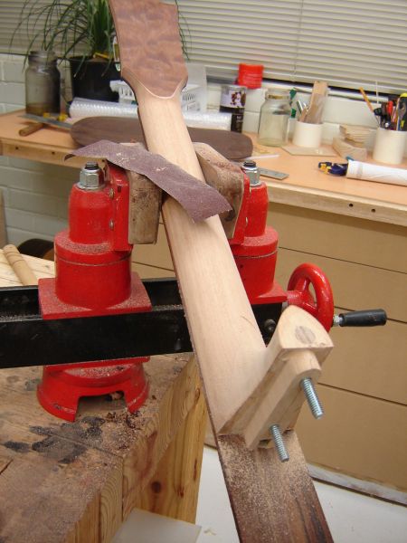

I've been using 1/4-20 lag/hanger bolts (screw one end, thread the other) that I screw into a 13mm dowel that runs the full length of the heal and I only use a very short tenon. I have found some nice looking cap bolts/nuts that thread onto the bolts from inside the guitar and look just like nice knock down bolts. Here's a few pics.
