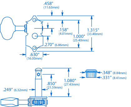

Looking at the diagram below of a tuner (compliments of Stew-Mac) do you see the taper on the tuner post tapering toward the hole?
What I learned was that the purpose of this taper is to direct the string winds when the tension increases to the narrowest part of the tuner post effectively cinching the string winds against the end of the string that is passing through the hole.
In short - self cinching/snugging/locking. Go figure - this is what I did not know until David asked me what the hell I was doing when he saw me installing strings. And yes - he made me do it all over again too... :lol:

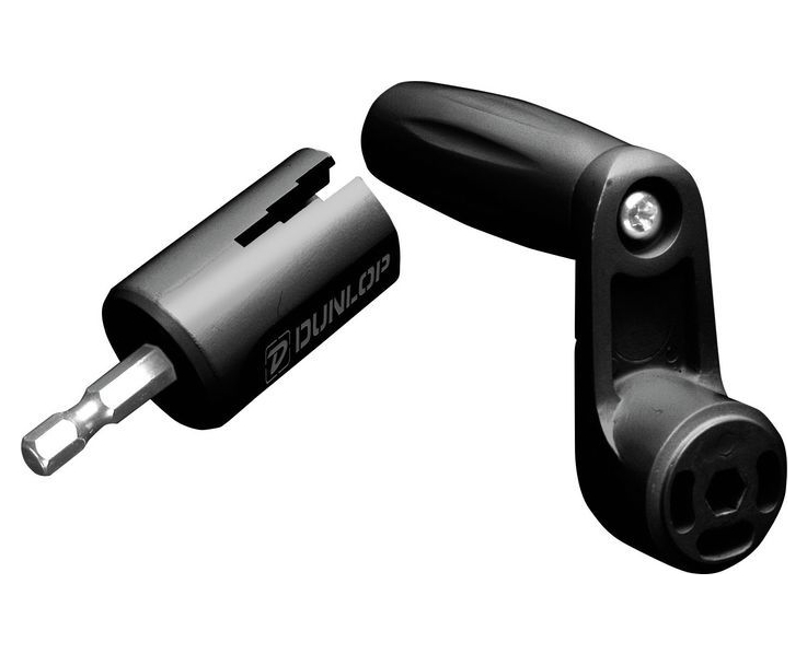

So after learning this and in combination with a suitable cordless drill with a Dunlap string winder attachment and the proper methodology/technique one can wind strings onto a guitar very quickly and precisely once you get used to how much slack you start off with for each string.

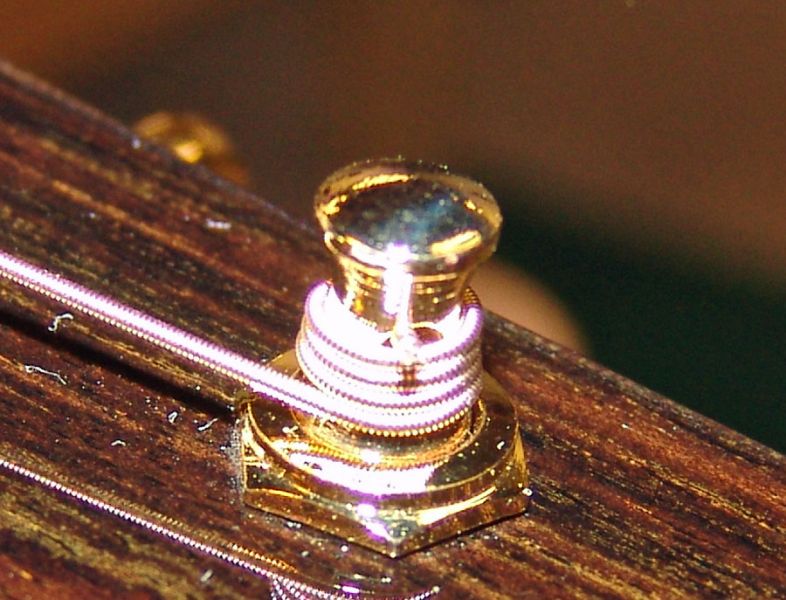

Here's how it looks on the guitar that I am playing these days:

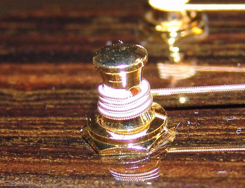

Here is the other side showing the end of the string cut off pretty close to the post. It's cut off as close to the post as it is because it is already locked in place by string tension and this greatly reduces or eliminates the possibility of the next person who strings the guitar poking a hole in their hand/finger on a string end.....
So this is pretty basic stuff but again I didn't know any of this and my prior technique left a lot to be desired over this one.

Also I bought several of the yellow string winders shown in the Taylor video and they work fine for the tuners that Taylor uses but are not ideal for having to tune what ever the dog drags in.
I like these better, chucked in a light weight cordless drill with a good variable speed capability. A cordless screw driver would be better IMHO because it's lighter and the axis of the tool matches the angle that you want to approach the tuners at - a straight line. Notice that Taylor had to regear their cordless screw drivers for this application. I suspect that they geared them down so that full bore is not excessively fast.
Here's what I use and it has cut out for many sizes of tuners:
I don't use the included winder but one could but not with the method that I learned in as much as one hand is required to feed the string.

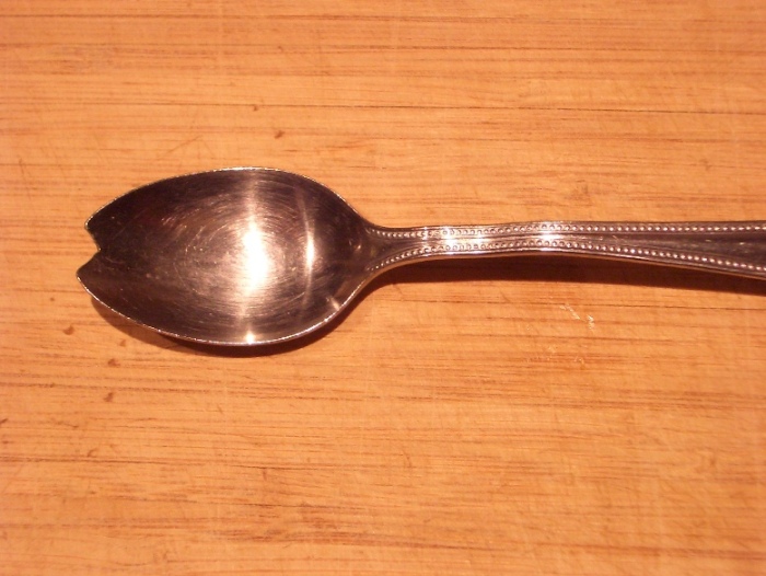

Post by Mark McLean » Fri Oct 09, 2009 5:46 am
Here is my teaspoon for bridge pin removal. A quick nick on the bench grinder gives you an end that gets better contact with the round pin. If you pinch an old one out of the kitchen she will probably never notice.
The technique on the Taylor video is cool. But Hesh is right that it can still be hard to estimate the right string length. Here is a great tip from Frank Ford:
