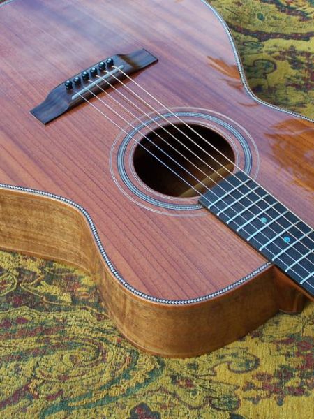

Post by Allen » Sat Oct 03, 2009 6:33 pm
A real killer look it to go with Australian Cedar with the Blackwood.
Image[/img]

That Cedar top looks beautiful Allen, great looking Instrument.
Regards Bob
Allen wrote:A real killer look it to go with Australian Cedar with the Blackwood.
Image[/img]
