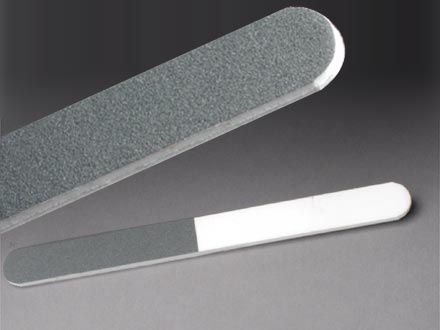

Micromesh touch up sticks
Post by jb2060 » Sat Oct 03, 2009 9:00 am
I use Micromesh touch up sticks fom stewmac and they work a treat. The shape and padding makes it easy to hold and push along the fret. 3 grits in one stick. I count how many times I push along each fret to ensure I don't make them uneven. The finest grit really brings up a nice shine. You can also use these things to fine sand/polish the fretboard.
The good thing is if you run out, you can raid your wife's nail buffers. Don't get caught though :-)
cheers, Jason
