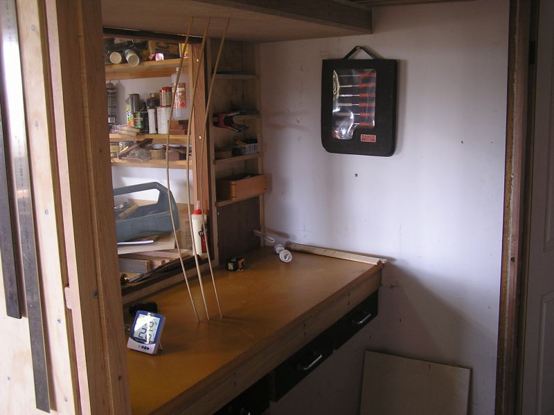

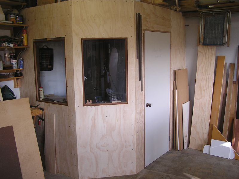

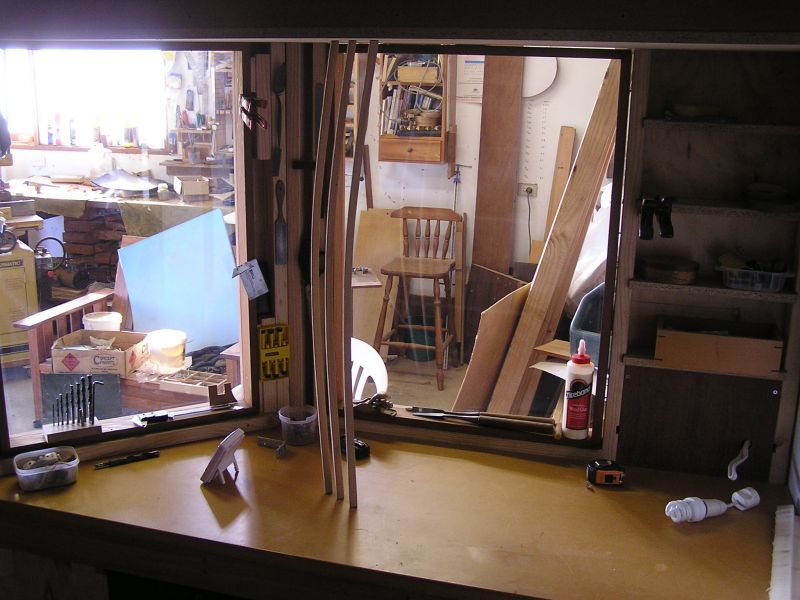

I have just completed a small 2.4m by 1.8m (8 foot by 6 foot ) room in one corner of my workshop. I did it so I could have the dehumidifier in there instead of in my room! I have constructed a bulkhead 900mm (3 feet) over the bench to make it a double dish go bar deck to be able to work on two tops or backs at once. It is so much easier to control the humidity in this smaller space, it drops to mid forty % quickly and will cost less to run as well. It is also an airlock between two parts of my workshop. I thought I would share some pics.

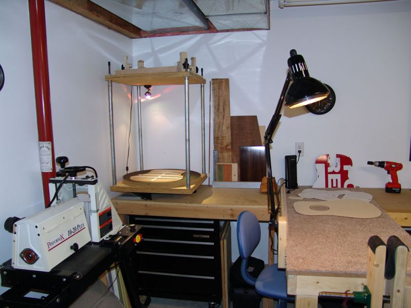

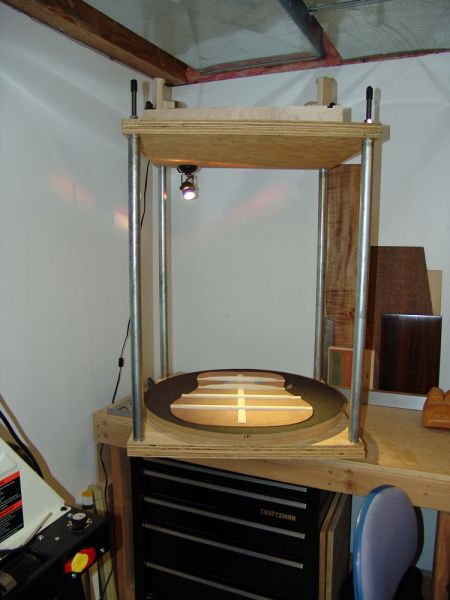

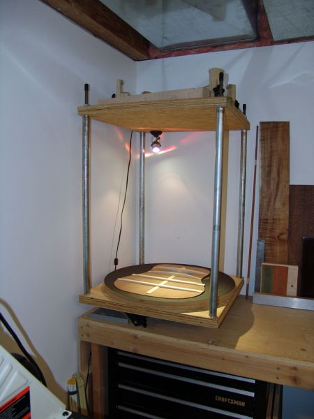

John I like the windows and I wanted to install a window in my shop too so that I could tell when I was slacking off....

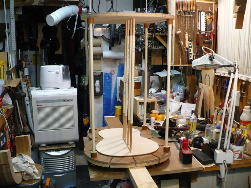

Here's my go-bar deck and apologies to those who have seen it before.
To me a go-bar deck is an integral part of how I build but I don't use it every day. So I wanted to get at it from all sides (mostly for ease of cleaning up squeeze-out) but I did not want the stinkin thing to dominate my shop and be centrally located.
So here it sits in it's corner location nicely out of the way.
Notice the built-in task light. I don't know if it's me or what but I just can't seem to have enough light where ever I am working so task lighting in addition to over-head lights really helps.

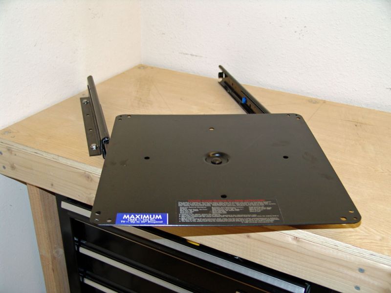

When I want to use the go-bar deck the Performax thickness sander wheels somewhere else for easy access and the go-bar deck slides out AND rotates 360 degrees for all-sides-access.
It works because of the magic of television, well..., the magic of a television slide like what you find in cheap hotels that rent rooms by the hour.... :lol:
This slide has a 250 pound capacity which permits me to build dreadn*ughts too... :D
It works great and I would not change a thing. I wish that I could take credit for the idea but I can't. When discussing go-bar decks and all-sides-access on the OLF OLFer Dean Pmed me with the idea of using a television slide and I have been grateful ever since.

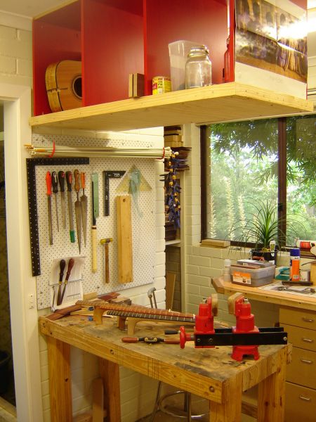

Mine is a divided shelf attached to the ceiling that goes out over a bench against the wall so I can get a 3 sides. My bars are on the rack there and I have heaps of storage above for bodies and other stuff.
Here's my Go bar deck/bench.
