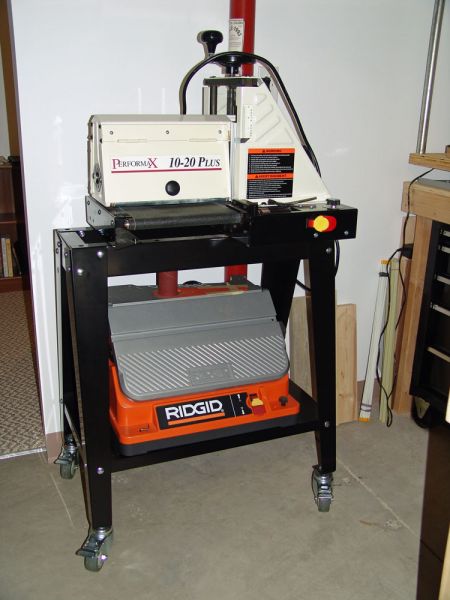

Hi Alan - I like my Performax 10-20 just fine. It's small, not as expensive as some, and once one understands that this is more of a finishing or skim sander and does not try to hoark off too much material in one pass it works great.
Another consideration when selecting a drum sander is that dust collection, good dust collection is a must. With my 10-20 I can get away with using my Festool vac since the 10-20 does not have a big ass drum and less material is getting airborne than with bigger sanders.
1/8th of a turn of the crank with each pass with this sander will remove approx. .005 - .008 depending on the wood being sanded and with 80 grit paper. The double pass sanding meaning turning the board around if it's wider than 10" is no problem for me.
My machine is about 4 years old, came set-up perfectly right out of the box, and it has never given me any problems with one exception which may be more of a perception problem on my part.
The tracking belt wants to track to the right and no amount of adjustment or "resettling" the mechanism on my part has eliminated this occurrence. I call it an occurrence and not a problem because this does not seem to cause any problems and I still have the original tracking belt on my machine and a new one in reserve for the day that it craps out.
The machine is light enough (although pushing the limit) for table top use and picking it up and moving it around by yourself.
Anyway you get the idea - I like my Performax and recently considered getting a bigger one but decided that the machine that I have now works perfectly and does everything that I need to do.

Yes, that is one thing that I forgot to mention to you Alan, is that you must have dust collection for these things. I've got one of Carbatecs 1 hp dust extractors hooked up to it, as well as my table saw and band saw. It's one of those hidden costs that tends to add up with the purchase of tools.
Wish we could get them for the price you pay for them over there Hesh. Here they are about $1,000 but like you I'm happy with mine. I would like a larger one for joined top and back plates, as running them through twice hasn't been all that successful, but I have access to the 16/32 so I've not needed to toss down more cash for something that is only used occasionally.
