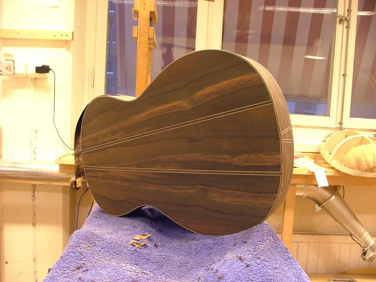

Saw your post yesterday and have been trying to find a pic of Lars Rasmussen's guitar with a three piece back, so I could show you a good example.
Never been a fan of a three piece back myself, but Lars found a bunch of Brasilian that would only work as a three piece, and he really did it justice, actually, full-on jaw dropping justice. The pic is over on the OLF somewhere but seems to have been deleted, maybe one of the other guys has a copy?
So yes, go for it. Just treat each join the way you would your normal center seam and you'll be right.
Paul B
Post by Paul B » Sat Sep 19, 2009 8:06 pm
This is from Lars, it looks even better with finish on it. In my opinion, this is how you do it. That is; don't hide it, make it a feature.
Post by Allen » Sun Sep 20, 2009 5:29 am
Yes, Lars nailed that one.
I think that adding the extra purflings and framing the center like that really sets it off, saying that you didn't run out of decent sized wood, but rather it's part of the design, and may have even cut down larger pieces to build with a particular design in mind.

Post by Hesh1956 » Mon Sep 21, 2009 1:06 am
Lar's 3 piece back is one of the very few examples of a 3 piece back that I really like. Note, as mentioned the framing, same wood used on the center panel, and repetition of the "V" shape on the butt wedge.
Lars has an excellent artist's eye.

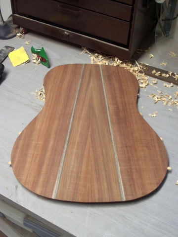

Heres a 4 piece back.....and its blackwood.

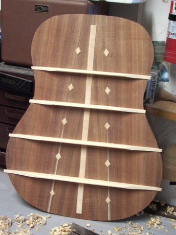

Post by Dennis Leahy » Fri Oct 02, 2009 7:09 pm
Here's another example, like Taffy's, that's a 4-piece back. If you really like symmetry or if you have a small piece for the center wedge, then you can bookmatch a pair of smaller pieces and get a wedge wide enough for the job.
This Cocobolo set wasn't wide enough for even a parlor back by itself, and the center wedge came from resawing a curly Katalox fingerboard blank that had a crack in it.
