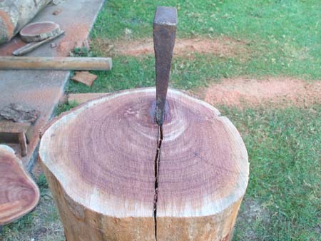

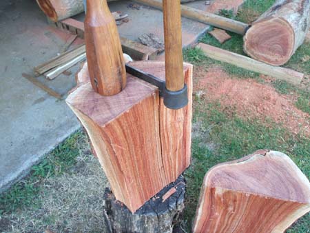

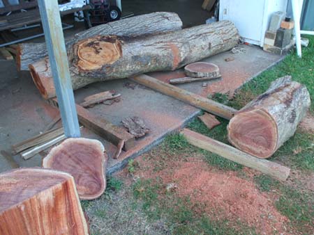

Been busy doing a bit of log scrounging after driving past these particular examples a few times and realising if I didn't salvage them they would end up going to waste.Just lucky a passer by gave me a lift with the second and third ones.No need for guessing games it is Coastal Banksia and is usually very stable and dries well once quartered.In a order to get well quartered wood you can't beat a froe and maul and sometimes a wedge and sledge. Lots of pictures will tell the rest of the story.
Coastal Banksia logs

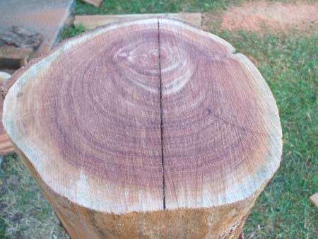

End marked with froe prior to splitting, this sets up where the log will split(usually) Got to love a log with the heart so far off centre,just made for luthiers and wood butchers like me.
Split with wedge

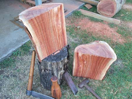

Nice result so far
Trimming up with froe

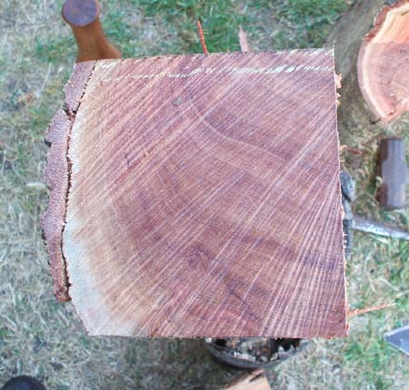

Nicely quartered ready for bandsaw

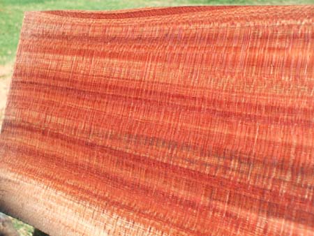

Closeup of what could have been firewood if it wasn't salvaged.This is the only face that has been jointed flat the rest are as they split.

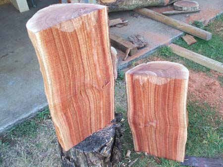

Another billet for backs and soundboards
Cheers from Micheal.

One question, do you re-saw before it seasons a bit?

Due to a lack of time at the moment it will be air drying in the woodshed for a while first. It should dry without too much checking and be easy enough to resaw later.I did put some wet boards into the kiln to check what will happen to force dried wood.A week in there should give me an idea.Sawing dry means more recovery as I can saw it closer to its finished size.
