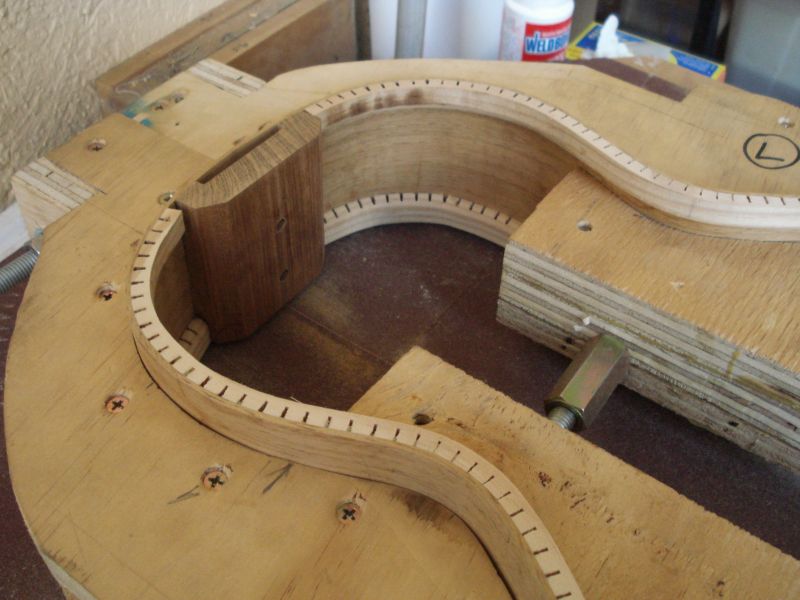

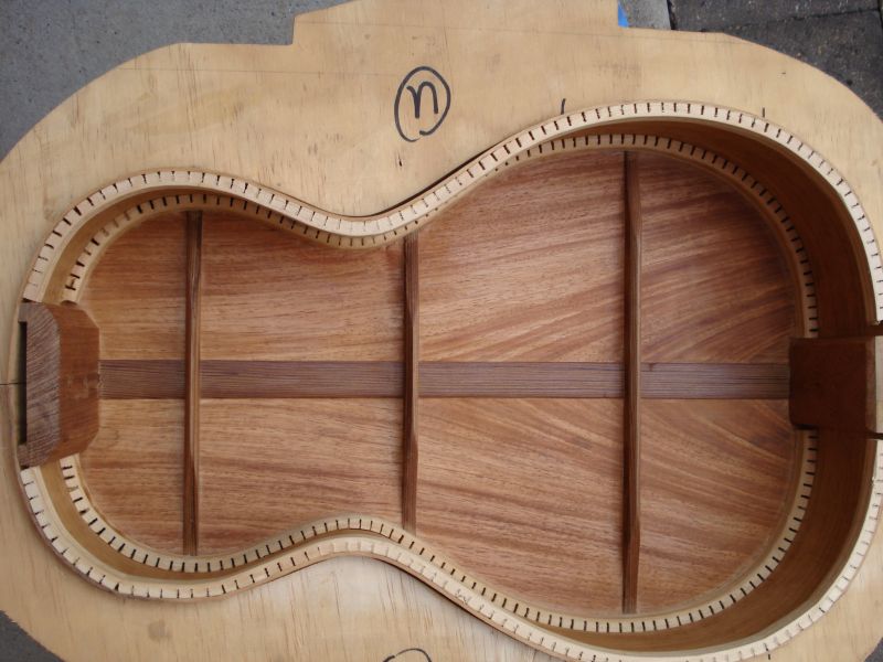

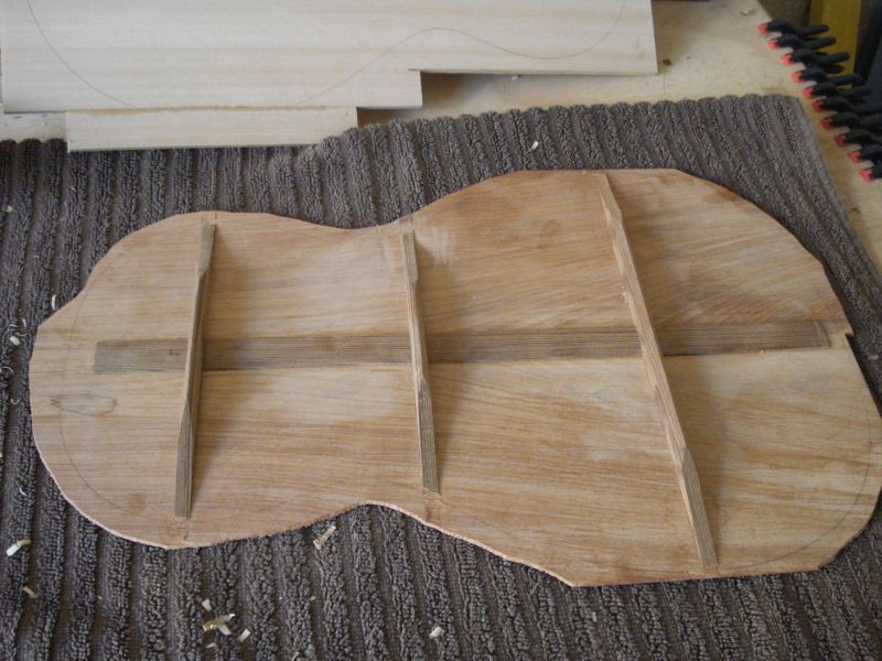

so i've started my second build.
i probably should have taken some photos earlier in but never mind :cry:
back, sides NGR.
top Kauri
bracing WRC.
neck will be NGR too.
cant decide on bindings, any ideas.
also any critiques are most welcome.

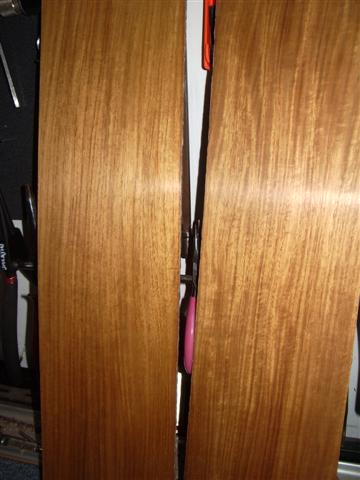

Post by Mark McLean » Tue Sep 08, 2009 9:47 pm
Looking good so far Liam. The bookmatch on the back looks very nice. You wanted suggestions for binding - the NGR will be gold-brown so the best binding would be something much darker (EI rosewood or walnut) or something really pale. I would probably go for maple. But your decision, and the good thing is that there are no wrong answers.

Great start there Liam. I have a big soft spot in my heart for parlor sized guitar. What scale length are you using on this one? Thanks for sharing the pictures.

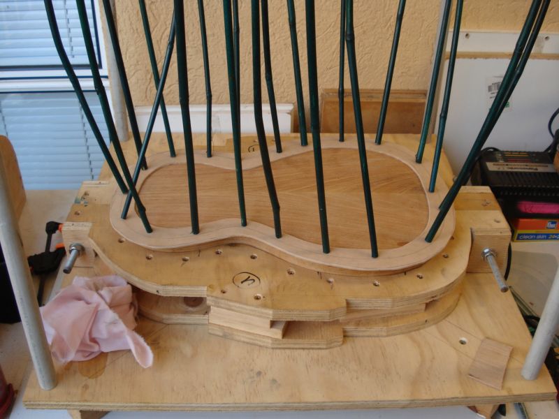

i just got the back glued on. note the bamboo plant stakes AKA go bars. $3 for the lot.

Hey, I use bamboo stakes in the go-bar too. Cheap as chips and very effective. I buy packets of little rubber caps from Bunnings to put on the ends of them (get the white ones - the black ones leave marks on your work). I haven't used many Aussie timbers in my builds so far, but I want to get into that. For a pale binding, how about sassafras. 12-string parlour guitar sounds interesting. Are you going to use a tailpiece or a pinned bridge. For a pinned bridge it might be cool to use Craig Lawrence's 6-pin 12-string bridge idea, to save space on a small guitar top. (viewtopic.php?t=354&highlight=6pin+12string+bridge)

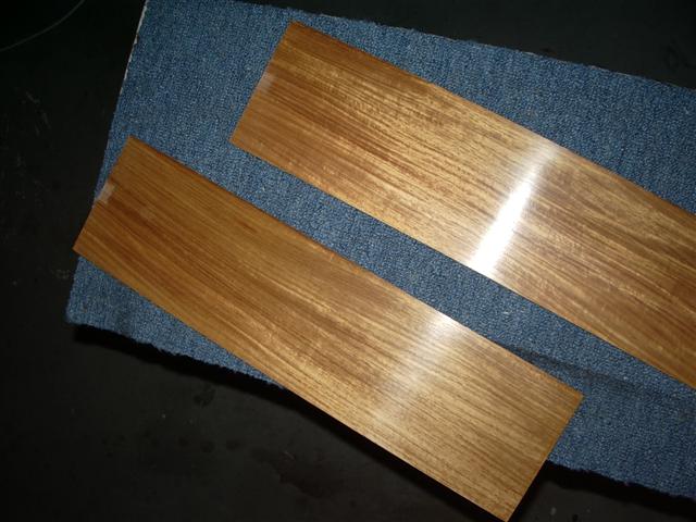

Hi Lillian, some time ago I was experimenting with grain filling on NGR samples. Here they are: unfinished, finished in NC lacquer and a shellac/wax finish Image

Taffy, thanks for the visuals. I can't see much of a difference between the shellac and the NC lacquer which is kinda cool.

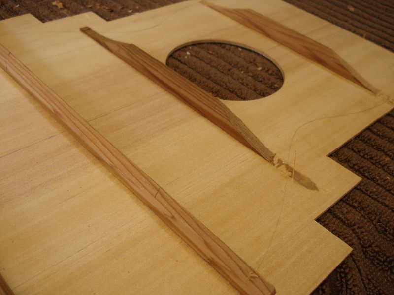

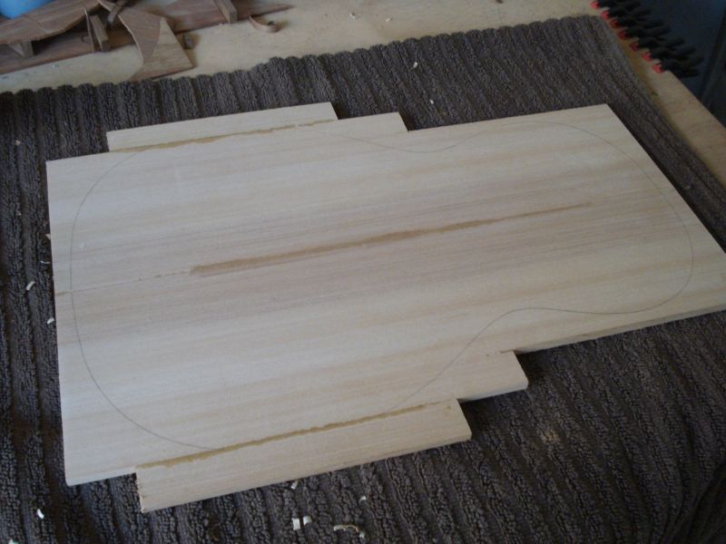

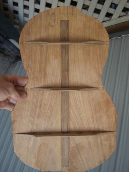

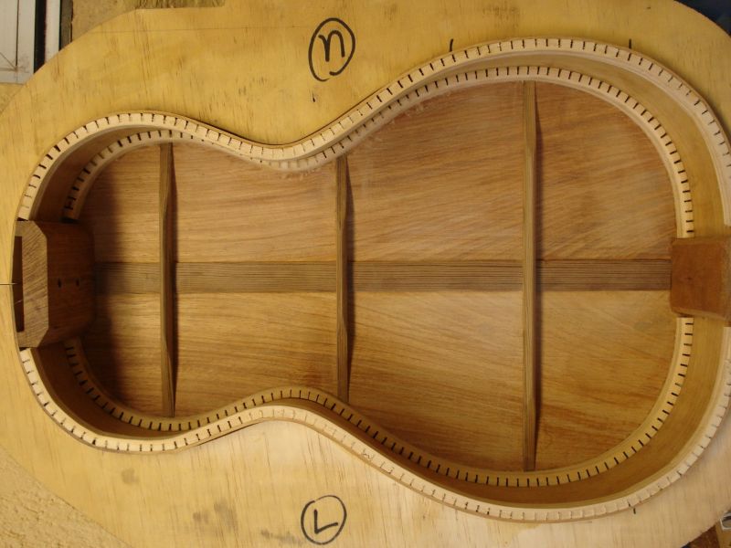

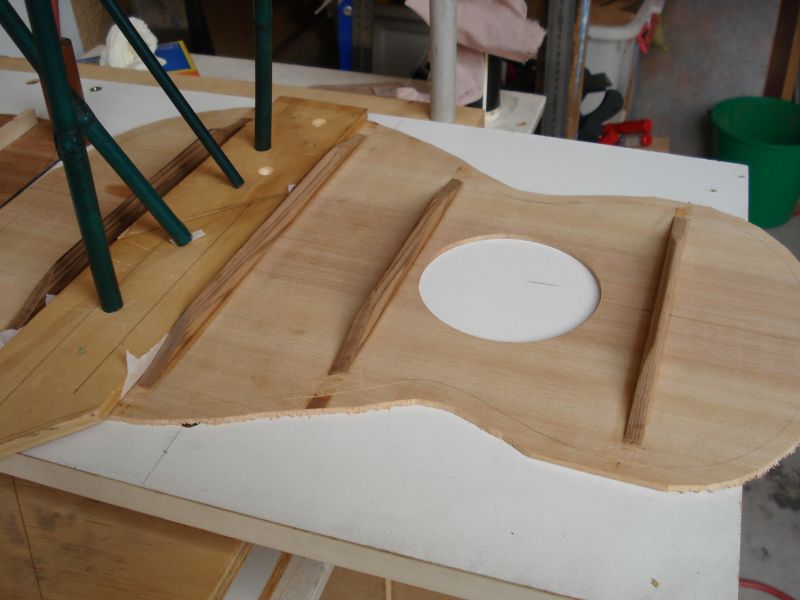

A little more is done, I hope to get the box closed late this afternoon.
taff, those samples have come up a treat.
The top is braced, carved and is now having the Tas Oak bridge plate glued in.
i thought i'd throw in a photo of the inside with one coat of minwax wipe on poly to seal it from the tropics. might give some idea of the colour to expect on the finished instument.

Post by jeffhigh » Sun Sep 13, 2009 4:46 pm
Hi Liam ,
Lookin good so far.
I Hope you plan on some braces beside the soundhole and between the UTB and headblock, looks a bit vulnerable there at the moment
liam_fnq
Posts: 594
Post by liam_fnq » Sun Sep 13, 2009 5:35 pm
jeff, can you give me a bit more detail on bracing thoughts, i'm quite the novice.
the old oscar schmit stellas and others similar were some times braced with less.
the fingerboard will be floating w/ adjustable neck join, so not so much downward force on sound board above the sound hole.
also, this is a very small body
length: 420mm
upper bout width: 200mm
lower width: 280mm
Posts: 1536
Post by jeffhigh » Sun Sep 13, 2009 5:53 pm
I build mine with a floating fingerboard adjustable neck arrangement too. Most of the force from the neck goes straight into the top and attempts to push this section into the soundhole and can shear the top though on a line parallel to the sides of the neck.
I brace mine with diagonal braces from neck block to UTB to distribute the force to the side of the soundhole and then braces beside the soundhole to reinforce this area.
Doesn't really matter that it is a small body, the forces in this area are the same and yours is worse in being a 12 string.this is how I do mine

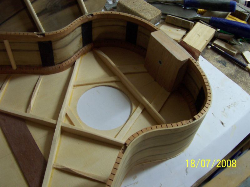

Posts: 1550
Post by ozziebluesman » Sun Sep 13, 2009 10:13 pm
G'day Liam,
I found this on the MIMF forum. It is a view of the top bracing of an original Stella 12 string. If you research this lead a little more you may be able to get some more info. Here is the link:
http://www.mimf.com/link.htm
