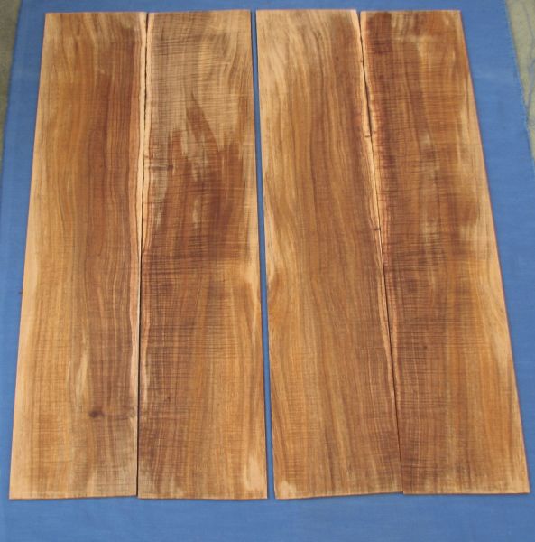

Photo Billets for resawing for Weissenborn build.
Regards Bob

Well I have finally managed to resaw my sets for my weissenborn build.
I must say I love the idea of Rick turner audience sound port, a built in tuner, hipshot D-tuners on the highest & lowest strings.
and a D-Tar wavelength multisource pickup.
Just a thought there is a long way to go yet.
Regards Bob.

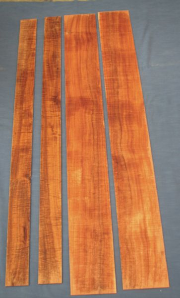

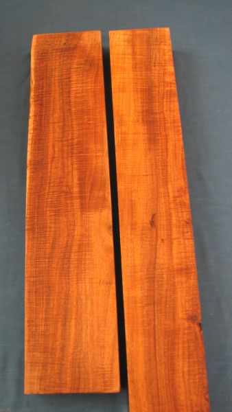

My First Build a Weissenborn
Metho wiped on sets to bring out colour.
Now correct me if I am wrong a few posted in the Soundboard thread not to use figured for the soundboard, now if I decide to go ahead with rick's idea using built in tuner plus D-Tar wavelength multisource pickup.
it will be ok to use figured.
Attached photo left hand side sides for my build.
Regards Bob.
Regards Bob.
