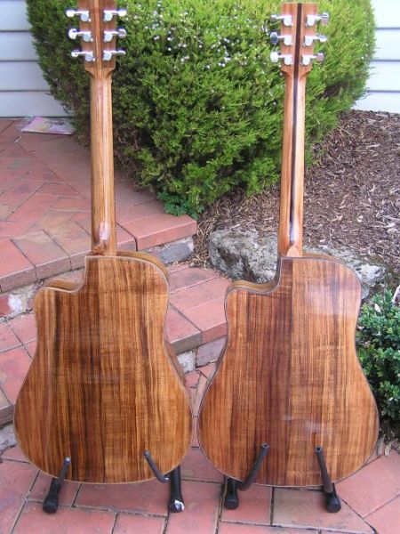

Finally finished these two - started back in Feb. One for me, one for one of my boys. Same design for both. Not as fancy as some of the stuff you guys put up, but my goal has been to stay with dreads until I think I'm doing a reasonable job.
Tops :Sitka. Left - LMI , Right - plank from Matthews timber in Melb

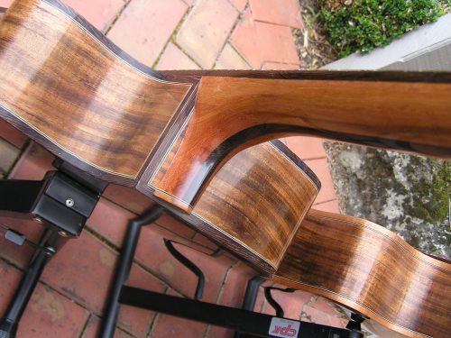

Back & sides : tassie blackwood - bought a 3m plank sight unseen over the phone from a tassie sawmill when I started a couple of years ago. Risky but a good outcome.

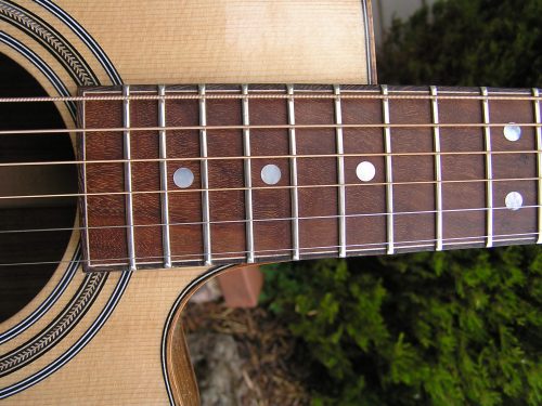

Fingerboard : Left - Cooktown ironwood, Wenge binding; Right : Wenge

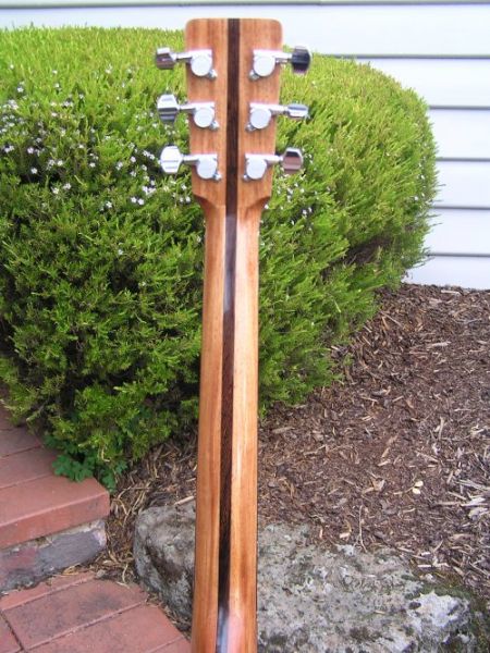

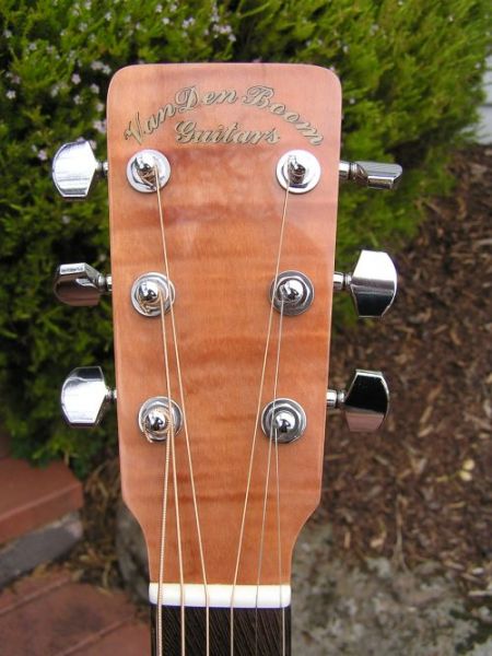

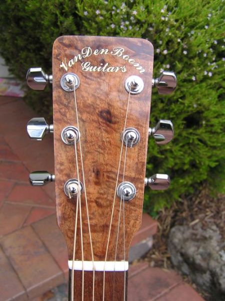

Headstocks : Left : Blackwood, RIght : Myrtle; Decal is vinyl
Bindings : Left : Blackwood - got from Tim Spittle, Right - Wenge
Both have under saddle pickups (Artec)
There were a few questions the forum helped me with along the way, thank in particular to the following...
* Rick Turner - tilted saddle used for first time.
* Kim - suggested I make my own saddle out of beef bone from the butcher when the slot became oversized. Also solved my lousy pickup response problem.
* Bob - supplied some nice bridge pins to suit
* Allen, Bob, Stu & others - got me onto Mirocat, solved some other finish problems I was having
Before bracing these tops, I bought Kent Everett (OLF) recent DVD on steel string top voicing. I found this very helpful. X-braces are also pushed forward.
So, while not perfect, I am now reasonably satisfied with my dreadnoughts, and so I will start to focus on a couple of archtops.

ozziebluesman wrote:Was there a difference in tone, volume sustain between the two guitars?
Yes. The one with Ironwood fb is noticeably louder and has better sustain than the other. Other differences to consider here are...
Guitar 1 : Ironwood fb, Blackwood neckshaft (much heavier than the other), rosewood bridge plate, ironwood bridge - slightly bulkier profile to the other.
Guitar 2 : overall noticeably lighter guitar, Wenge fb, Fijian mahogany neck shaft, maple bridge plate, Wenge bridge
Bracing pattern identical on both.
Frank
vandenboom
Posts: 414
Post by vandenboom » Sun Sep 06, 2009 4:44 pm
liam_fnq wrote: can you tell us a little about the plank top on the right hand guitar.
Matthews in Vermont get these planks of Sitka that they call "Mast grade" as it is used for sail boat masts.
I bought 3.6m of 9"x2" a couple of years ago for about $300.
Nicely quartersawn.
Good strength with the grain but pretty weak laterally. I left this top close to 3mm thick. Further to previous message, this is the also the top with slight less volume and sustain.
