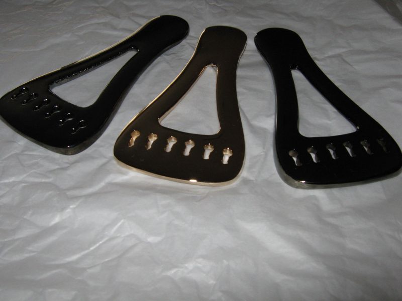

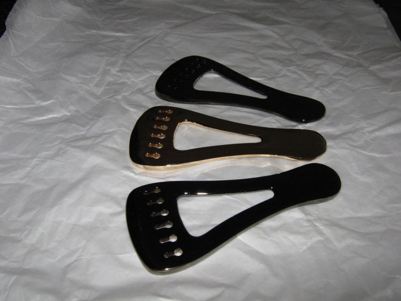

Post by rocket » Tue Sep 01, 2009 12:19 pm
Hi people, i thouhgt you might be interested in these tail pieces i have produced. I made a pattern first and then had a few cast in aluminium, and now i've just recieved them back from the platers, i had some done in black chrome and some in gold. Cheers Rod.Image

Post by rocket » Tue Sep 01, 2009 1:46 pm
Nicko, these do actually have a 12 inch radius to match the bridge and fingerboard i am using, i should have taken a shot front on to show it. I haven't seen the video but i can understand what you are saying.I have seen a few tailpieces that are available commercially and they were large and heavy to me, these are shorter than the Benedetto number, only 150 mm long and very light, it will be interesting to see how they compare to the timber ones i've been making, but besides the effect on acoustics, it does give one abit of variety to offer.

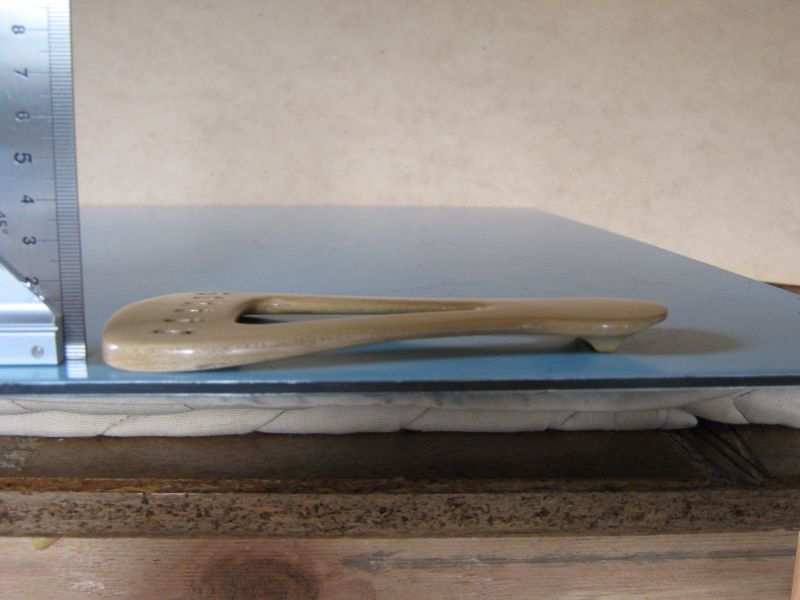

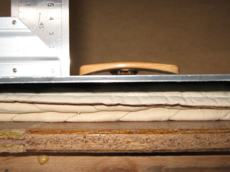

Post by rocket » Tue Sep 01, 2009 2:37 pm
OK Nicko' i took a couple of shots of the prototype, front and side view check it out, rock maple, it's been on an instrument,works well.Image
The outside radius is 12" but the inside radius is 8" so that viewing the instrument from the side the end of the string ball can't be seen.

Post by rocket » Tue Sep 01, 2009 3:43 pm
Yes john, cast in sand, which means alot of polishing before plating, one could use lost wax but very much more expensive, not as much poishing though, have to do the figures. This is a first for me, never had anything cast before, the best way is die cast, but then you're talking megabucks. Cheers Rod.

Post by Nick » Tue Sep 01, 2009 6:09 pm
Thanks Rod the radius didn't show up too well in the overhead shots but thanks for posting the others, they sure make things clearer!
