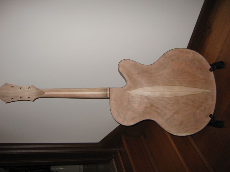

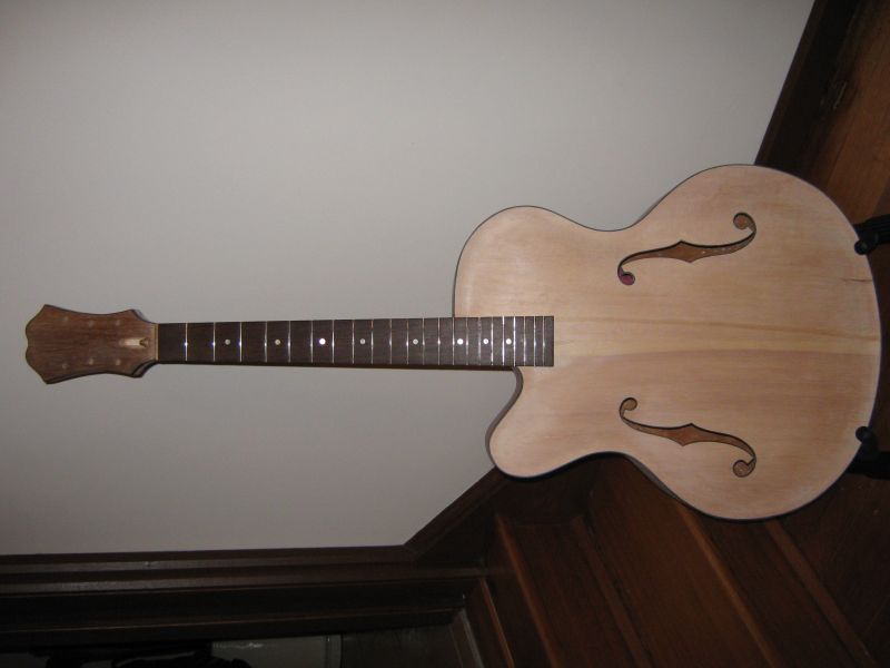

hey people'' Here's a couple of pics of the left handed cut away archtop i was fitting the neck to recently.
Back and sides U.S. Cherry,
Belly sitka spruce,
Neck U.S. cherry and rock maple,
Fret board wenge,
headstock veneer blackwood

Molly duker" A reference to somebody who is left handed, it's a left handed guitar so i called it a molly duker. Just a bit of fun tis all.....!

A cack-hander :lol: Nice job Rod, looks very tidy.What laminates are in the neck? & while I'm bugging you with questions :lol: What plans for the finish, just clear or maybe you're planning a burst?

It's really lovely. What did you do for the top bracing?

Hey Nicko and Allen, thanks for the comments, yes Nick i thought i would have a go at a red burst, i think that'll go well with the cherry, i've just ordered some nitro and colour from Durobond, very aprehensive now this to me is the most scary part of building a guitar, hope i don't stuff it up.
Allen, it's got x bracing on the belly but with a high intersection on the braces and pivoting on the bridge posts.
Cheers Rod.
