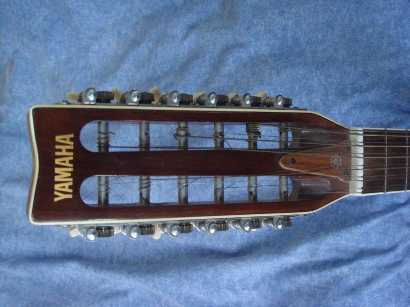

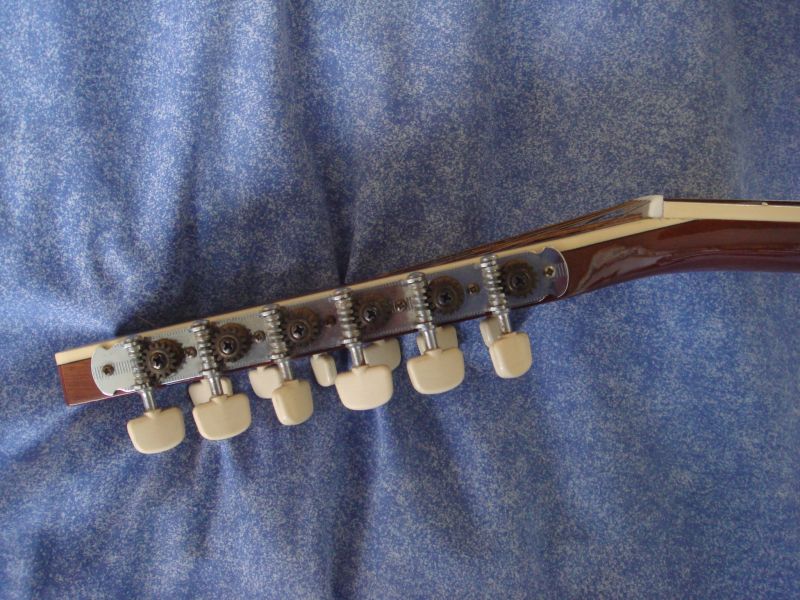

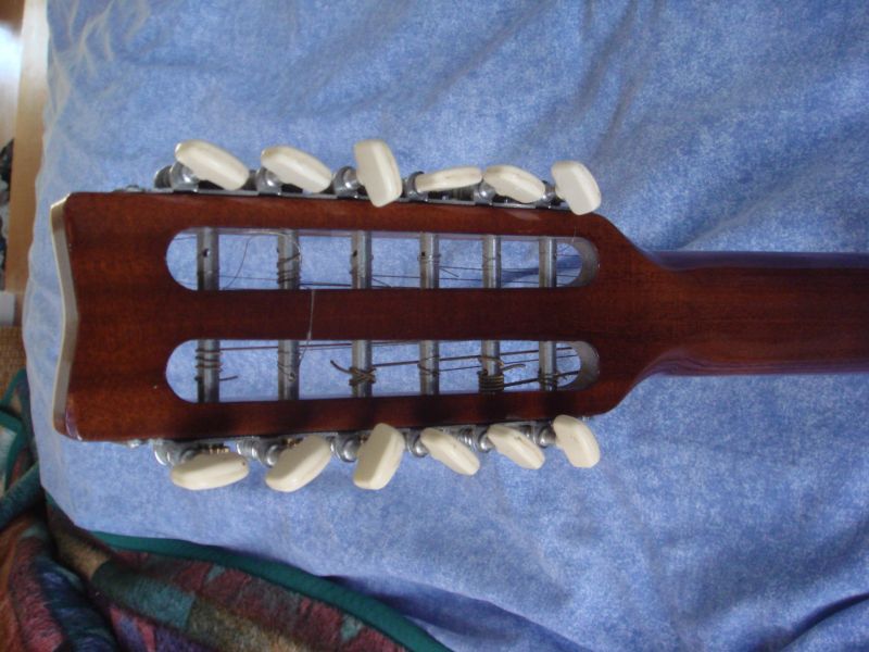

photos of my (somewhat unloved) 12 string Yamaha slot head
Front
Side
Back
Looks to me like the neck angle is the standard 15 degrees, overall length of peghead from nut to tip is 209 mm and its mm 67 wide tapering to 60 mm wide and 20 mm thick.
If you let me know what other dimensions you want, I will measure it for you and post a reply.

Liam, mate, sorry for the delay. Measurements are of my Yammy FG512, made with digital calipers, (which may not have been invented for people like me whose eyes are packing up, but they sure make measuring things a truckload easier!)
Nut width = 48.5mm
Space between strings varies between 2.87mm on the treble side to 2.0mm on the bass, because of the larger string gauge. Strings are med to light.
Distance from out side to outside of strings at the nut = 42.6mm
Distance from out side to outside of strings at the bridge = 59.5mm
