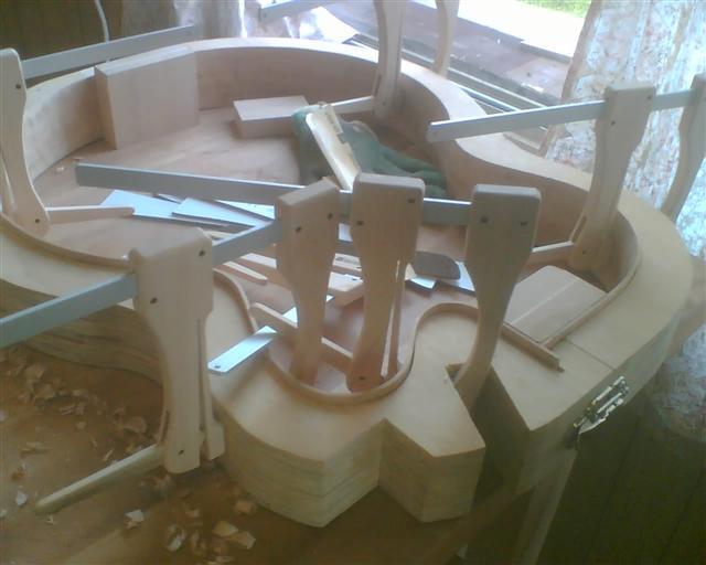

It's still summer here in Michigan and I don't build much in the summer these days.... But today it rained so I spent some time in the shop and picked up where I left off last spring with this stinkin dread*ought.
Today it was install and shape the back joint reinforcement, join some scrap for a rosette, and kind of get back in the swing of building since the weather will begin to suck here soon....
Anyway it was a good time and here is a pic:
So my friends what's on your benches? :)

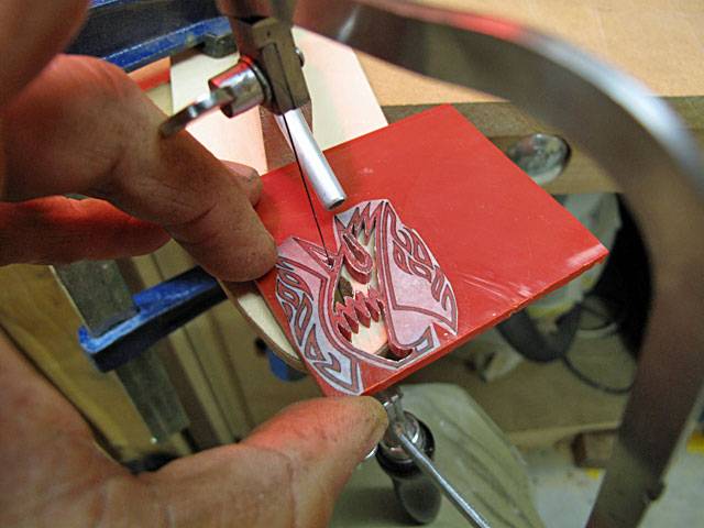

I've just finished cutting out this firebird motif out of recon. stone and ready to inlay into a wandoo board. Fun times .
cheers, Stu

Nice work there Stu. Where are you getting the recon from? And how does it cut?

Stu, nice bird inlay. I will have to look into "recon stone" as it looks like a good medium. Waddy, those little rounds on your bridge profile look great. Tho I'm sure the "classical purists" might frown, I think it is a subtle, yet distinctive touch. My bench is utter chaos as I've been routing binding and neck dovetails. I've been taking pics of my neck join process. If anyone is interested I will post.

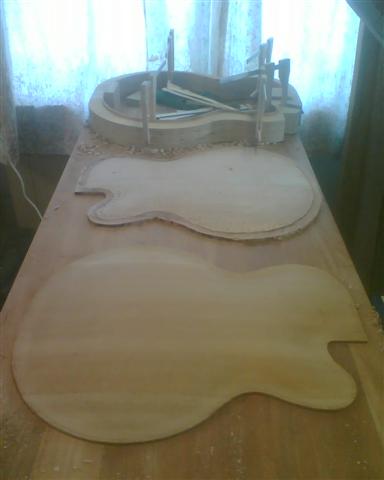

Post by Clancy » Sun Aug 23, 2009 2:28 pm
Well, it's been 2 weeks since I had a brain tumor removed and while it's been all good news following the surgery, I've been left feeling a little flat.
I had thought that I would use the time off recovering by pottering in the workshop (no power tools!).
Instead I'm just too weary to be bothered, which was probably to be expected.
When I do get the motivation up again I've got an archtop too complete for my brother in law.
Shown in the pic is the Qld Kauri top & Qld Maple back & sides sitting as I left them about 3 weeks ago.
The Kauri is an experiment in avoiding the high cost of buying spruce wedges from OS.
It rings nicely to a tap, is very staright grained but looks kinda like bunya and is heavier than spruce.
Anyone else had experience with non kiwi non ancient kauri?

I've only use Qld. Kauri for bracing and linings. Tests I did against spruce for deflection tests showed it to be stiffer in my samples than the spruce. Bit heavier though not by much. My biggest problem with it is that it has sort of a drab, dirty look that I don't find particularly appealing. But beauty is in the eye of the beholder.

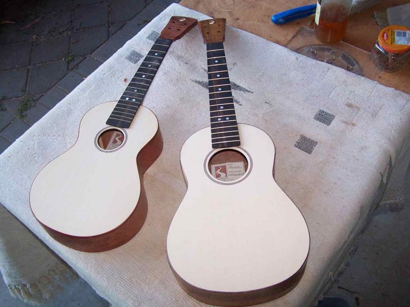

I've been working on a pair of ukes. One concert size and the other tenor. Both with Spanish heels, as these are prototypes for the uke building class I'm instructing next month. Not having built with a Spanish heel, I thought it would be a good idea to work out the details before hand. :lol:
Got them all done and pore filled 1/2 hour ago. Will have some photos in a couple of days when I can handle them again, and I've got time to get back to them.

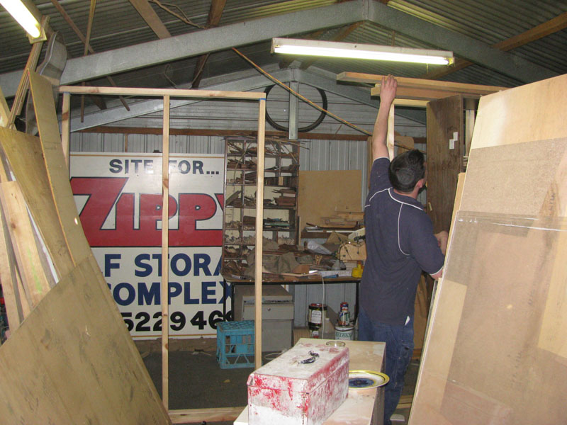

Post by Bob Connor » Sun Aug 23, 2009 5:08 pm
Hope things improve quickly for you Craig.

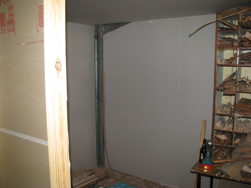

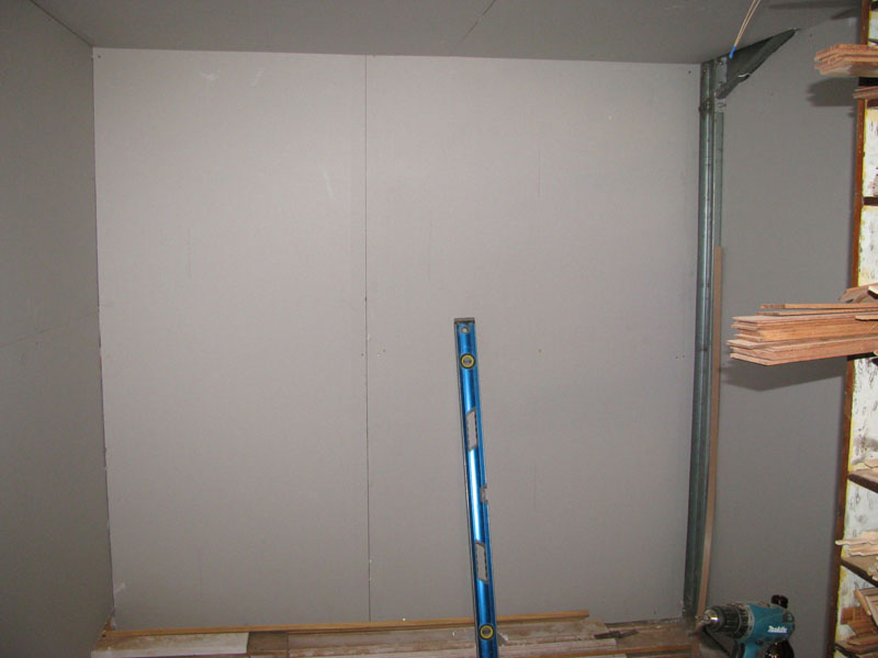

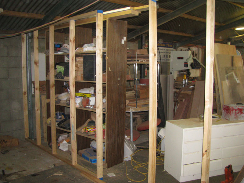

We've been building nothing, nada, zip because the sheds too full so today was the day the renos started.
It's just a framed, insulated and plastered room that will be humidity controlled so that our wood will dry to an acceptable MC and we can be a bit more consistent in building year round and not be subject to the vagaries of the weather.
The gobar deck will be living in here as well.
The roof of this erection will be storage area for spare backs and sides and other lumps of wood that usually get stacked against the wall. A lot of these are leftovers from resawing.
The average humidity year round in Melbourne and surrounds is around 65% so most of the work in here will be done by a dehumidifier.
Total room size is 5 x 3 metres.

Have you added on to the shed Bob, or is this just dividing up and utilizing the space more efficiently?

Stu, have you found any issues working with recon stone? Allen, I know there a few places over here that carries it. Check out places that carry supplies for making custom knives.

Gearing up to go full time Bob? Having an insulated room will make a big difference. Good to see the elusive Dave.

Ooh yes, about the recon stone.............
I couldn't find a supplier with my searches on the net within Oz,
though I did find a few in the U.S. and one in the U.K.
I went through here
http://www.customluthier.com/shop/cart. ... gory_id=91
I got six different blanks and landed in Oz for about A$90.
Workability is very much like abalam with the finer pieces prone to
breakage if heavy handed. Overall it is a great product when requiring colouring other than standard mop varieties. I'll be using it again for sure.
If anyone has another source for Recon stone, I'd be interested in finding out who else has it.

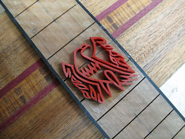

Inlay is over half way done with the bird finished in the Wandoo FB
and the wings still to go in.

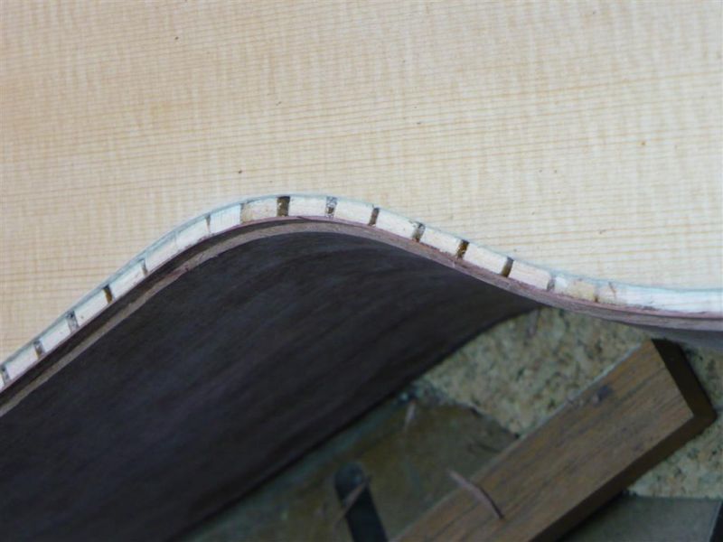

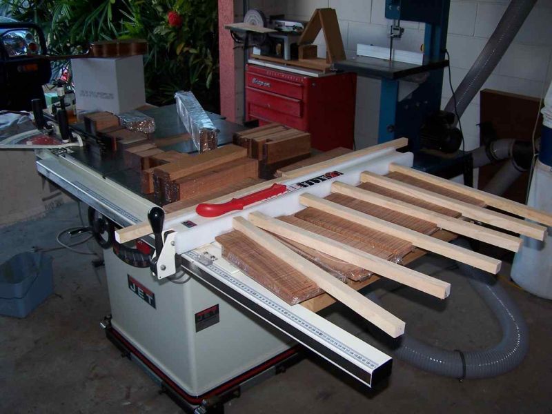

I'm just trying out a new, to me, kerfing system. Needed to run a new batch of kerfing. I normally make a reverse kerfing, so after profiling my blanks I pulled out the K sled, except this time I kerfed them on the opposite side, similar to standard kerfing, and cut and sanded some slats to overlay after the kerfing is on.
After the kerfing is glued and dried then I soaked the slats for a bit and glued them on over the top.
Kind of doubles the kerf gluing process but does make a nice strong set of rims, and I think looks pretty sharp also.
I had read about someone doing something similar and Arnt tells me that C. Fox does his this way but I believe he cuts a rabbit in his so the overlay is flush.
Joe

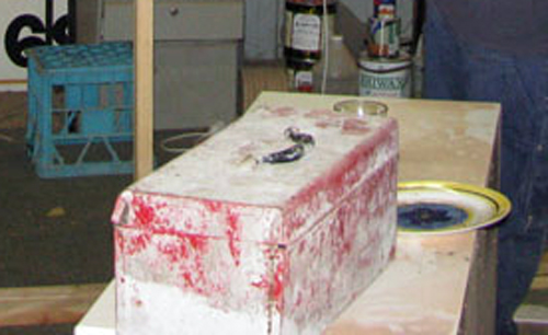

So tell me Bob buddy do you let your shop get THIS dirty to cut down on the need to pore fill? :D :lol:

Joe great looking linings!!

Really nice work Stu my friend and that is going to be a killer looking inlay when completed!!!

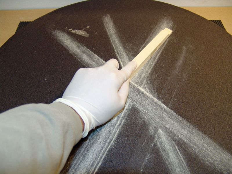

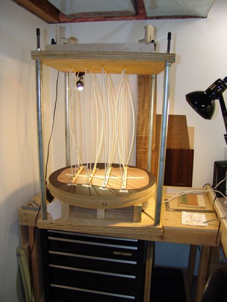

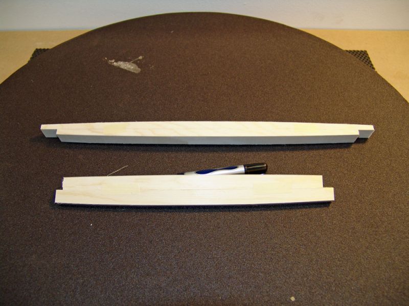

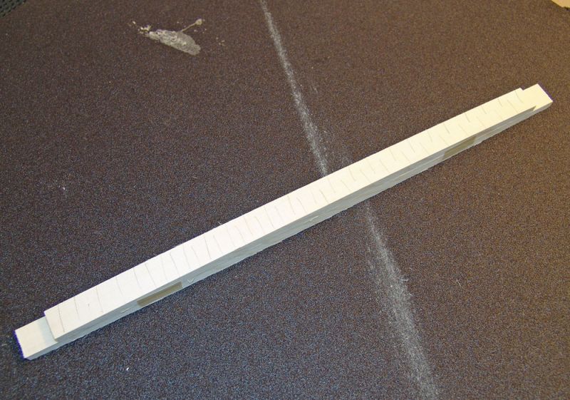

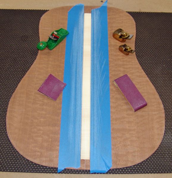

I thought that I would post some more pics and share a couple of ideas.

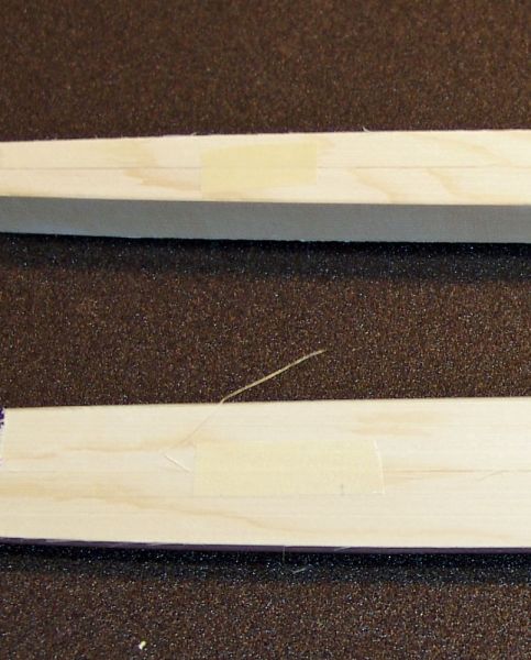

When I am making bracing I trace the respective radius onto the designated bottom of the braces using a radius template from Tracy at Luthier's Supply. Then with some quick hits on the old belt sander the radius is roughed in.
This is what I think some may find useful. I use plain old masking tape to tape two braces together with the radiused side out. The reason for this is that some brace stock may flex in the dish when sanding or pressing fairly hard and what results is something different from the radius of the dish - whatever the hell that is... :D
So when you tape two braces together prior to dish sanding there is far less flex in the brace stock and what results is a truer-to-the-dish radius - whatever the hell that is... :D
In addition, with taller braces sanding them in the dish it's all too easy to tip them to one side and end up with the leaning brace of Piza... :D I find it a little easier to tell if I am sanding on an angle if the brace is taller and acting as a better indicator.

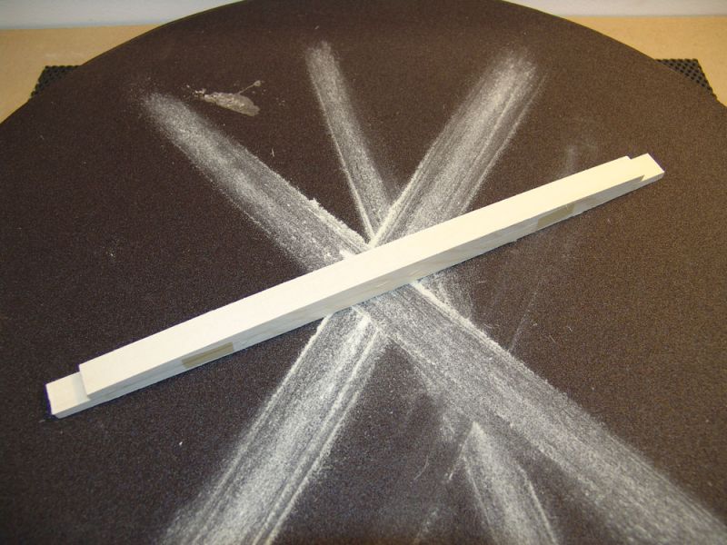

Next it's the old pencil marks trick:
Sand until the marks are gone:
And don't laugh but it is far easier to hang onto something as slippery as brace stock if one puts on a latex glove (unless you and latex don't get along). Gloves are also great when buffing a guitar and provide me with a bit more positive grip at a time when one slip and you just smashed your new guitar all over the wall or floor or both....
Anyway that's what I just did this morning in my shop... :) [/img]

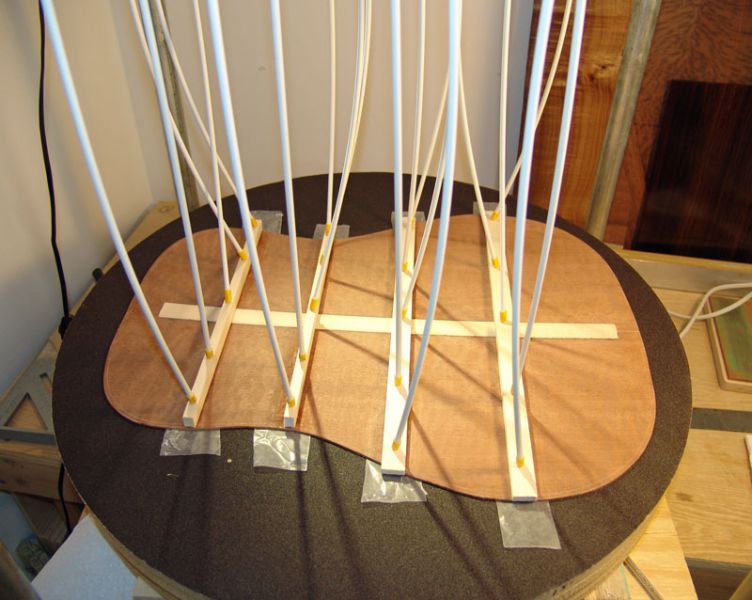

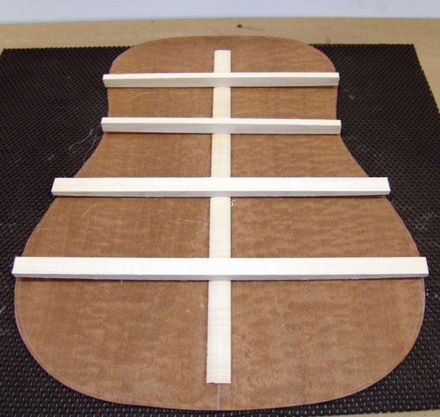

Post by Hesh1956 » Mon Aug 24, 2009 2:52 am
Well I made some progress and thought that I would throw up some more pics. The back braces are now on using HHG.
Thanks for looking. :)
Post by Bob Connor » Mon Aug 24, 2009 7:55 am
No additions to the shed Allen.We've just enclosed the area where the wood stash used to be.
Lillian - no plans to do this professionally at all - I'm quite happy with the teaching gig.
Kim no extra fridge - the Kelvinator holds more than enough.
Hesh - that toolbox holds a Ramset gun. Dave bought it from a bricklayer hence the crap covering it.

Well, been bloody hectic here, and I've got no end in sight to the stuff I need to get done in the next couple of weeks.
Got the concert uke sanded out and a coat of shellac on it. The Tenor still needs the pore filling sanded back, but that will have to wait until Wednesday, as I've got to spray some clear on an English style rocking horse for the Woodworkers Guild's Christmas Raffle tomorrow after work. Then I just recieved part of the wood for the Uke Class I'm putting together in 2 weeks. This is some of it laid out on my table saw.
And the pair of ukes.
And not in the picture is the box of truss rods from Allied that I had to run and pick of from the post office before they closed today. Now to pack them up and get them out the door as well.
