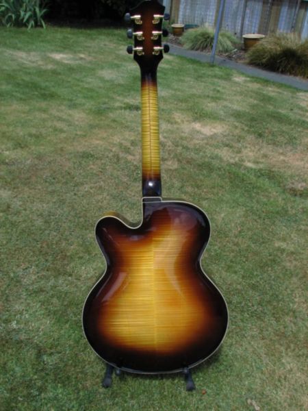

I've done quite a few bursts over the years but without scanning the photo's in I'll just post one I already have on me 'puter to give you an idea of the type of bursting possible with the powders.
The acrylic lacquers I have used I used on mostly solidbody electrics and have gotten from automotive spray stores, they do take a long time to harden up before you can buff out (typically 4-5weeks) and you do get shrinkage for some time after but the beauty of this type of paint is that if you need to, the store can match any solid colours, you can invent your own or spray metallics, the options are limitless.

Post by Nick » Sat Aug 08, 2009 2:43 pm
Lillian wrote:Nice Nick, and I don't like bursts.
Thanks Lillian, I'm not into the three tone bursts & only do them if the customer asks, there's something about a line of red that screams GARRISH to me.But I like a nice tobbacco burst. Did a refinish on a Hofner "Beatle" bass some years ago that I was really in love with how it looked but never took any pictures! :cry: :cry: Damn fool. :evil:

Post by Lillian » Sat Aug 08, 2009 2:46 pm
Yours doesn't have that hard line that is so common to bursts. It looks more like it was worn off from use. Not quite, but very close.
I still don't want it on one of my guitars, but still, it was nicely handled.
