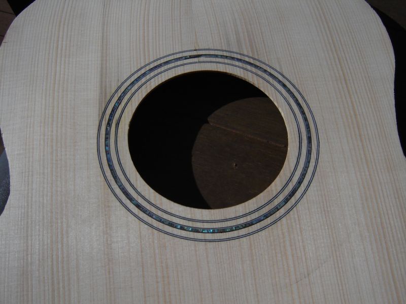

Here’s a pic of one of the tops i have used it in. It has only been run through the drum sander with 120 grit it is a bit flat looking. Don't let my crap photo put you off.

Dom - that is a nice looking top. What width did you use for the rosette, 0.047" or 0.064"? Have you put a black strip alongside the flexi-shell stuff or is that black accent part of the product? Does it have hard or flexible sides? If it has a little bit of give I imagine it would conform well to the routed channel without any gaps to fill in later.
Hi mark, I used the widest flex they had. Can't remember what size. The black line on the product is very fine. I added some more fine black and a BWB on the other side. The sides are a little flexible with slightly rounded bottom edge so it fits into the routed channel easy.
