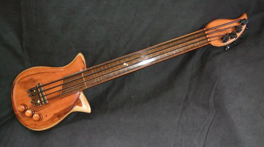

This is my new baby.
And a baby she is with a 496mm scale length and total length from tail to tip of headstock about 77cm. But size isn't everything. She plays in the octave of a double bass.
Body- mountain ash with goncalo alves front and back.
Neck - mountain ash with pau ferro fingerboard with goncalo binding. fret slots filled with wood filler. black and brazilian rw laminations between the fingerboard and neck to give a sort of purfling look.
tailpiece is pau ferro with black fibre/brazilian rw/ and goncalo, brige is goncalo with black fibre and braz rw laminates.
Knobs are a bit of everything with goncalo/ash/black/braz rw.
nut is goncalo with black and braz rw laminates.
gold MOP inlays.
The electronics are from Ashbory bass, the strings - which give the deep sound from a small scale length are polyurethane.
This was meant to be a quick and easy build while my next electric guitar build was on hold during our house renovations. It was neither quick, nor easy. Some of the mistakes led to a much better result than planned, others I hope will never be noticed.

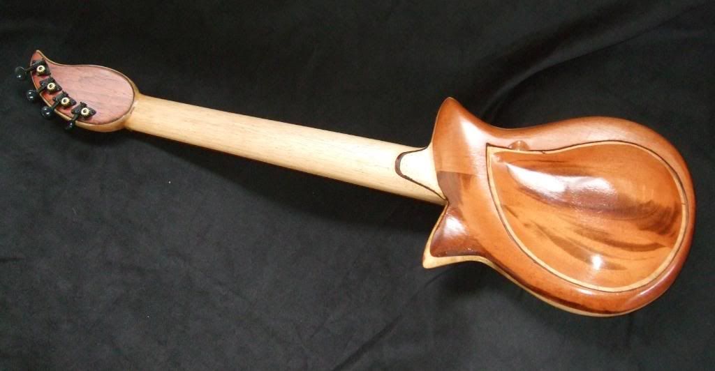

Here she is from the back.
Lots of nice features which came about from rectifying mistakes:
The neck and body were originally one piece. After making a dog's breakfast out of the headstock, I decided to cut the neck off and make a separate neck. The new headstock is scarfed and laminated on the front with goncalo, and on the back with black fibre sheet and brazilian rosewood.
I decided to highlight rather than try to hide the neck joint, so some black fibre sheet and brazilian rosewood laminations make the join stand out.
Originally the body wasn't going to have a goncalo back, but the body was so thin that I couldn't get the jack in, so I planed it down to where I'd destroyed the rear cavity and put a new back on it. It looks much better.
I also put in a bit of a "wedge" to make the body tilt back toward the player.Image (clickable thumbnail). Unfortunately you can see some of the less invisible corrections around the jack.
The cavity cover is as planned. It's retained with magnets. It's much bigger than it needs to be as a cavity cover, but this gave the design feature of a shape that fits with the body. I'm really pleased with the aesthetic result.
Here are clickable thumbnails of the inside of the cavity cover, and the cavity.

Fantastic idea to make a weeny bass, but I have to ask - how does it sound?
Don't those strings thud and rattle like mad?
What pickup are you using? I'm guessing that must be a piezo bridge pickup if your strings are synthetic.
As for the look - I find it grotesque, but compellingly so. I can't stop staring at it!
:twisted:

The pickup is in the saddle - yes, a piezo pickup - that is a replacement part for an Ashbory bass. It comes on a combined bridge/tailpiece which is black plastic and I didn't want that, so I dismantled the saddle from the original bridge. The pre-amp/pcb is also from an Ashbory bass.
I originally had Ashbory bass strings on it, but didn't like the look (white with a very slight blue tinge) or feel (a bit sticky). I found these polyurethane strings from a guy who makes bass ukes.
The sound is deep and woody. Not too much rattling. I'll try to put a sound clip up - any idea how to do that?

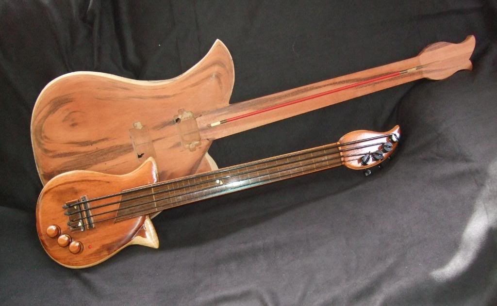

Here it is with a earlier iteration of the shape in a full size electric guitar for size comparison. The proportions on the full size are certainly more what our eyes are used to seeing. This bass is built as a compact instrument, but the neck still needs to be big enough for strings and fingers.

brian64 wrote:Here it is with a earlier iteration of the shape in a full size electric guitar for size comparison. The proportions on the full size are certainly more what our eyes are used to seeing. This bass is built as a compact instrument, but the neck still needs to be big enough for strings and fingers.
yeah ...the full size electric body is more like it, imo
