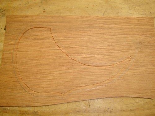

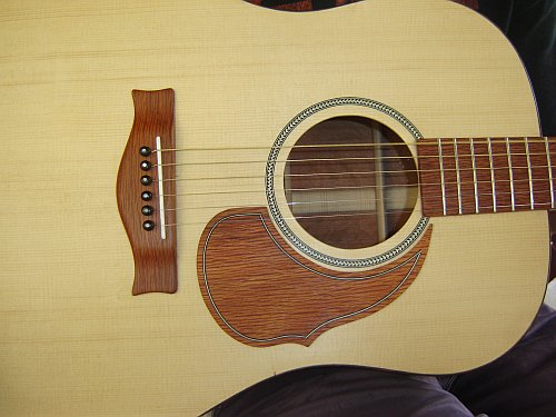

Never let it be said there is such a thing as 'waste' when it comes to lutherie. A variation on plastic pick guards is to manufacture them using thin off-cuts of wood, as these pics of WA Sheoak might help to illustrate.
I start by drawing the outline of the shape then, using a routing guide, I cut a thin channel a few millimetres in from the intended edge:

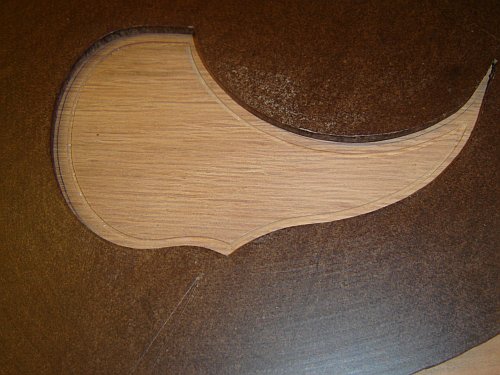

Once the channel is cut then the plate can be sawn & sanded to shape:

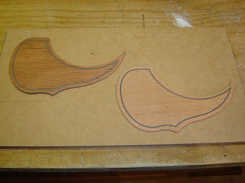

This channel is then filled with BWB binding:
Then after final sanding and a couple of coats of Organoil, voila!:
A pic of son Drew with his new pride and joy:

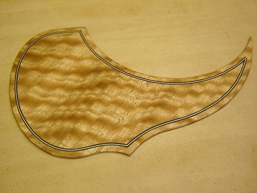

And here's a finished scratch plate made from Tassie Bluegum:
One advantage of using wood instead of plastic is that, if scratches build up over time, they can be sanded out and the plate then gets another light coat of oil.

Nice looking pick guards Pete! That is slick with the purfling in there.
Looks like you did a pretty good job on the guitar and son as well! :P

Peter - what is the thickness of the guard once it's all finished. I imagine it would need to be on the thicker side to hold the purfling.
Also, do you adhere with double sided sheet or use some other method?

Welcome to the forum Pete. And that a great first post. Gives me a few ideas about those scraps that I've been giving away to the intarsia folks a the Woodworkers Guild.
Post by Bob Connor » Thu Jul 23, 2009 8:58 pm
G'day Peter
Nice to see you here. Very, very elegant pickguard solution there.

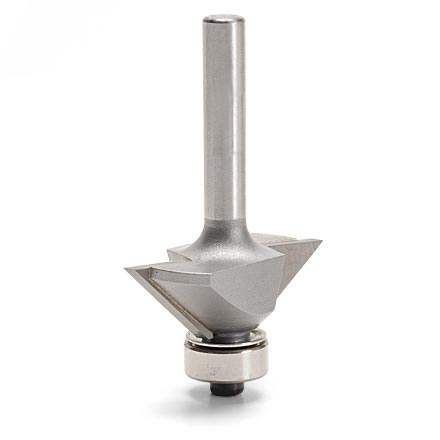

Frank buddy the answer is yes. Stew-Mac sells a router bit just for this purpose although I suspect that other bits may work too.
The bevel is important if you don't want the owners of your guitars to catch the polishing cloth on an edge every time they clean up the instrument.

G'Day Peter, good to see you chime in and what an great way to start . That pick guard looks bloody brilliant.I'll be stealing that idea straight off your first post , thanks mate. :lol: :idea: :lol:

The idea came from Kinkead who suggested wood rather than plastic.
Thinkness is a debate on effect on tone ...... anything under 1 mm is what I have done. Stuck it on with double sided tape .... so far OK.
Cheers Pete
