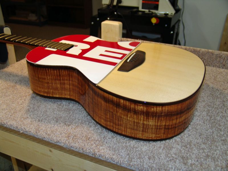

Since I haven't posted anything of value for a while I thought that I would continue the trend and post this.... :D
One of the many things that I picked up from David Collins is how to be more responsible when working on someone else s instrument and when working on your own guitars.
This is a shield of sorts to prevent the errant slip of tools from damaging the upper bout of a guitar. It is very useful when fret dressing on a new or older guitar. I am in the process of making these for each of the sizes/models that I build.

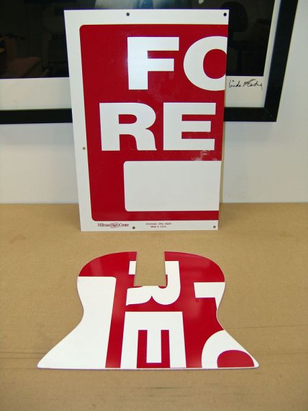

It starts with a plastic "For Rent" sign but a "For Sale" sign would work just as well... :D After tracing (I used my OM mold) the upper bout, annotating the neck extension location, and figuring out where it needs to stop so as to not make contact with a bridge the shield was cut out. I found that a 2400 micro mesh pad worked better than sand paper for deburring the edges and the pads conform to the curves very well too.

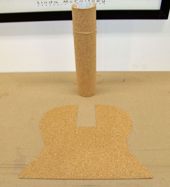

I had some self stick cork that came from LMI or Stew-Mac and once the shield has been sized and cut out the cork is applied to the back side to protect the finish of the guitar.
Provided that your finish is tough enough, this one is cat urethane, I use masking tape to tape the shield in place before getting out the fret files. I would not use masking tape on a FP or some other finishes without doing some testing first...
This one took me about 30 minutes to make and offers decent protection with very little effort. The next time I fret an OM all I have to do is make sure the cork side is clean... :D , slap it down, tape, and Bob's my uncle.

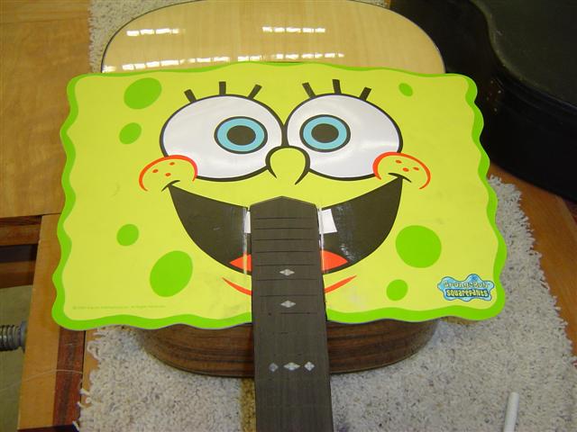

Nice idea Hesh. A placemat also works well and you can get some funny ones too like this Spongebob one.

I had a Luthier friend tell me today that cork is not the best way to go because it can pick up metal filings say when fret dressing and the filings can stick to the cork. The next time you use your shield you end up scratching the finish of the guitar.
So if you go with cork vacuum the cork side of the thing after every use. Felt is probably what I will use on the one I have to make for dread*oughts if I can find some self stick felt.
