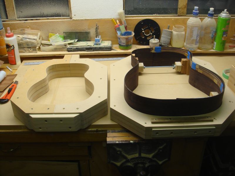

I'm going for the mould method this time, so job No1 was to build those. Thanks to all tutorials on this site, this is the result so far.

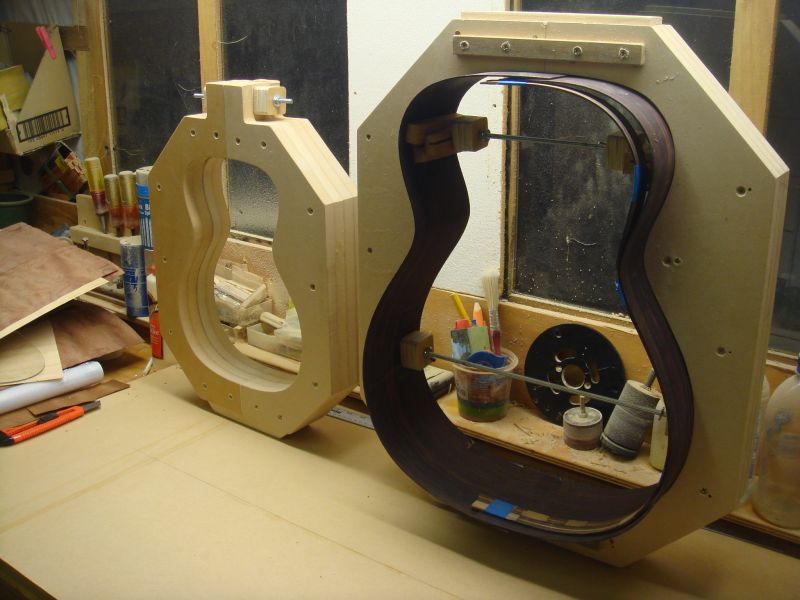

I am going to put a couple more layers on the OM mould to make it deeper, but I will screw them on so I can remove them if I need to, to get at kerfing etc,
The rosewood sides are sitting in the OM mould. I have a master grade redwood top and spruce bracey bits for inside, ebony fretboard and bridge. The neck is an LMI premade bolt-on jobbie, so I am cheating a bit there.

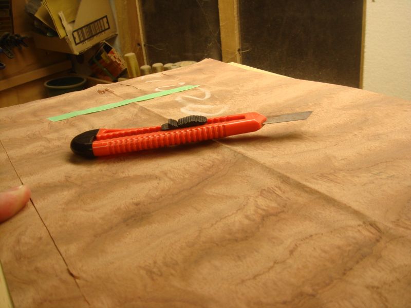

Mini-me on the left, is going to be built out of odds and sods lying around the workshop and anything I can lay my hands on. The latest idea was to use veneer laminate for back and sides for this little beauty. It is currently awaiting the outcome of experiment No2 with laminating veneer.
Here is the result of experiment No 1 - not entirely successful!!
I'll have a go with epoxy (Thanks again Tim!) and attempt a laminate rather than faux plywood. If that doesnt work I will have to have a go at bending some sides, which to date I have been too chicken to attempt.

Not very well, clearly!!
I pasted it all with glue then put it between two sheets of mdf then loaded everything heavy I could find in the workshop on top, starting with the thicknesser and ending with a nearly full petrol can (my guitars share their habitat with the lawnmower)
The moisture from the glue expanded the thin veneer and hey presto - a major stuff up. I posted the pic for a bit of light entertainment for you all, it certainly made me laugh.
Ironically, the finished wrinkly product is far too stiff - I have used too many plies.

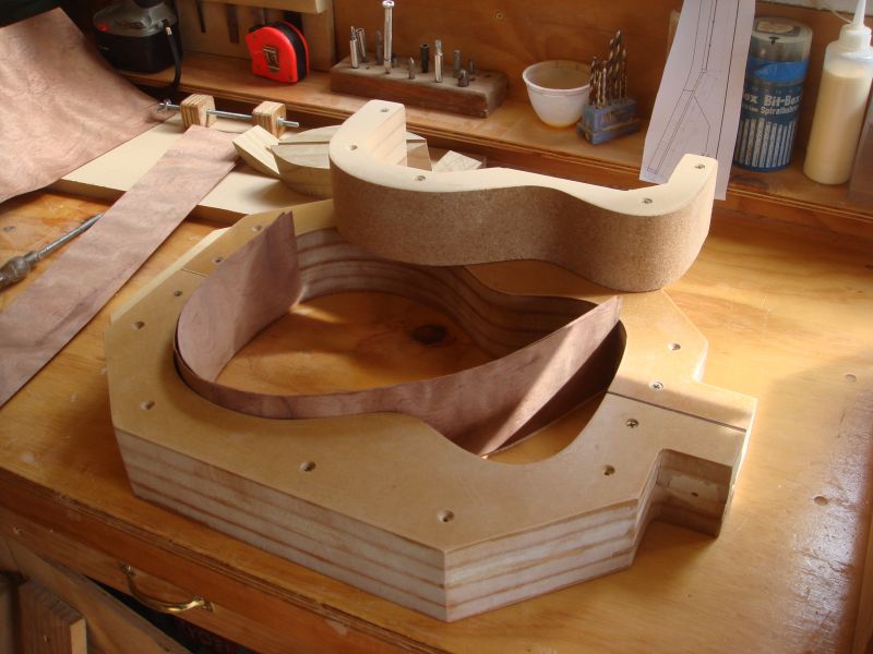

This time I decided to have a go at the sides, as they have a smaller face area. I figured if I couldn't do those successfully I was not going to have much luck with the back.

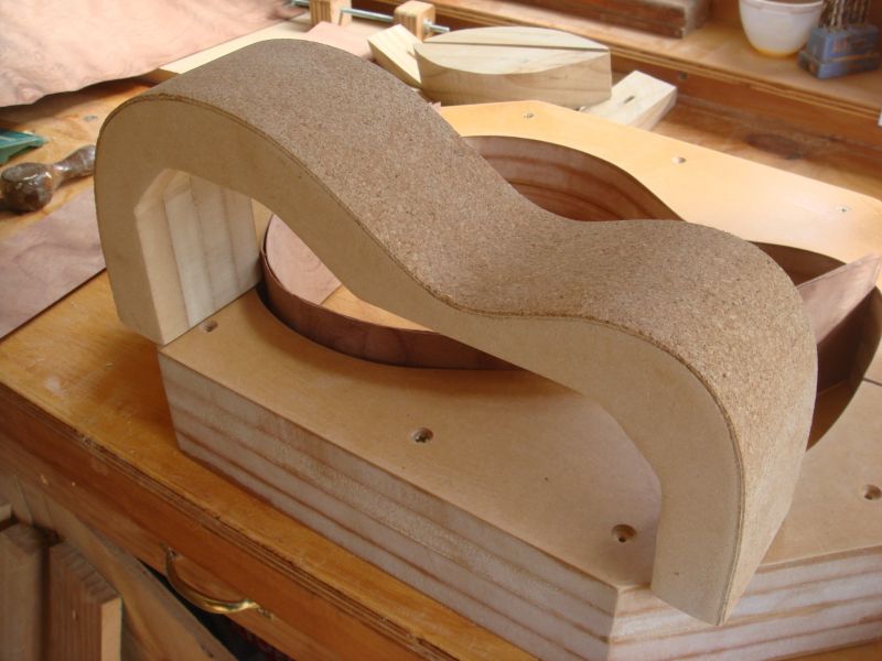

So first I finished the mini me mould and made an internal form. I lined the form with cork so as to get even pressure when I clamped it, as it was going to be difficult to get the internal mould to be perfect and allow for the thickness of the veneers.
When I glued up the first pair of sides (I bought a glue roller from Carbatec this time) I found that even though I had put lots of clamp pressure on it, the upper bout had not mated well and as a result I had a section of the veneers in that area that hadn't stuck together and they opened up when the side "sprang" out of the mould.
You can see it in the photo below, just beside the splinter.
Also, it looked like I had not used enough glue this time! Doh!!

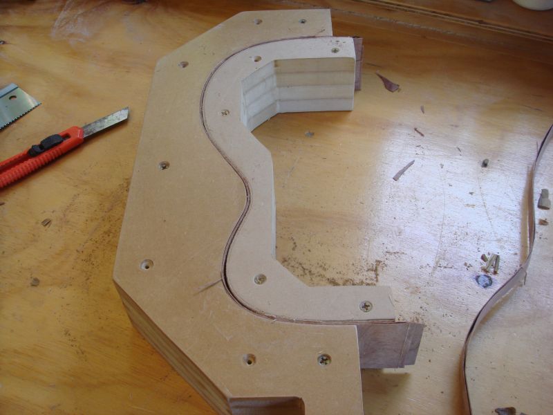

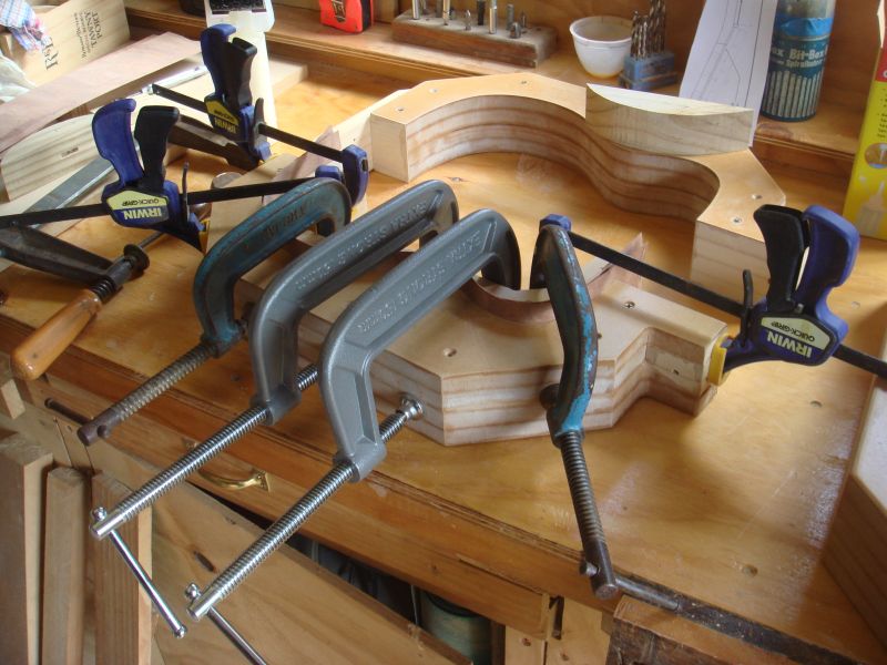

So then I tried again and this time the veneers glued better, I clamped the pesky upper bout first with lots of ergs and then clamped everything else afterwards. In the middle of exerting lots of macho clamping force, I heard a cracking noise, which I couldn't track down to anything broken but it turns out that was the top laminate shifting - its only screwed on while the rest are glued. This is so I can remove it when I have the sides made and want to work on the purfling etc. End result is that there is a little "ripple" parallel to the edge where the mould shifted, just about the thickness of the veneer, so I guess that one's buggered too.
I also found that the veneer is very porous and lets the glue through - I found this as it had glued it self to my cork faced mould! However, the glued, bent side did at least look like something that might one day be part of a guitar. Its pretty thin, 1.75mm. I think I need a third layer, which could be a problem as two thicknesses only just fit in the mould...
Anyway, trial side #3 is now in the mould, this time with lunch wrap in between it and the mould, and this time I have used sapele veneer instead my precious but dwindling supply of bubinga.

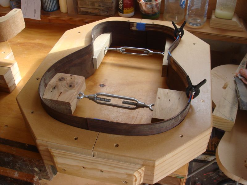

I put a couple more layers of MDF on the big mould so its now more like the depth of the body. but very heavy. Thanks for the turnbuckle idea, Bob.
