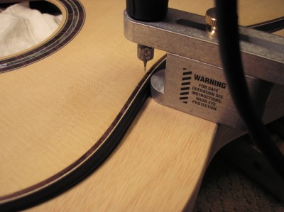

Hey Guys, Well I decided to add a black/white purfling to this guitar.I don't think it looked right the way it was so I got this tool that is used for violin purfs. It holds a dremel and I used a 1/32 downcut bit. First I carefully routed along the rw purf and slowly increased the size of the slot to the blk/wht purf size.It slides along the top of the outside mold and is adjustable in and out.
I don't know why I thought it would look good with No blk/wht border on the inside of the rw purf but...It's just another screw up and learning experiance! :D

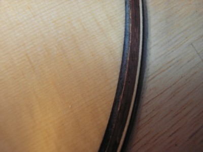

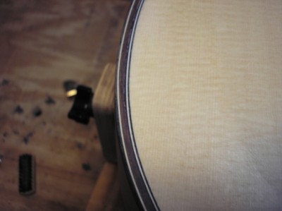

Here's the slot cut -needs another pass to remove the faint white strip.

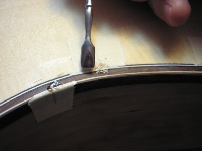

patching a few holes with epoxy and rw dust
Done...
