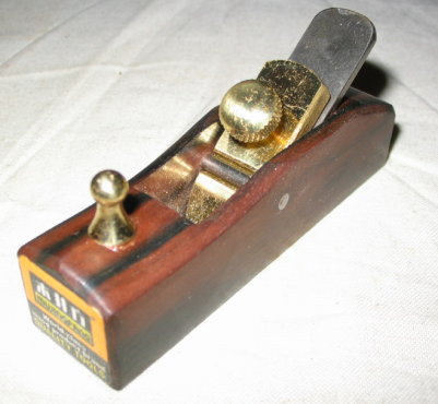

I just bought a couple of these.
http://cgi.ebay.com.au/ws/eBayISAPI.dll ... %26otn%3D4
one of which I will reprofile to a curved base.
Have'nt got them yet but only $12.

What's amazing about these planes is that I don't know how anyone can make them for that price and be making a profit - I guess the same could be said for a lot of products ex China/India. That's it for good aspects really. Sorry to be such a downer.
I have had a couple of these for years. Found them at an export trade show overseas. To be very straight forward, they aren't great. They are not particularly accurately made, the blades are very thin and don't hold an edge and the adjustments and mechanism leave a lot to be desired. The brass of course tarnishes too. But then, what exactly could be expected from so cheap a product?
They can be 'tweaked' though and even through their flaws, I still very occasionally reach for one for the odd small job. They are after all a handy size. When set and sharp, they cut small jobs effectively - such as removing a sharp corner/chamfering a bevel. I would not however be using them for gouging/carving hard woods - you will be very frustrated very quickly.
I'd go a decent blade such as the Lee Valley replacement I mentioned above and make my own plane over trying to use any of these for an archtop. Hope this doesn't sound condescending and you are likely to still find a use for them. They are still a bargain - you couldn't make one yourself for that price.

I am not a fan of Ibex. I bought one thinking that since everyone talks about them that they must be all that. I can't say I like the way it sits in my hand. It feels like its going to pop out of my fingers because of the shape.
I picked up another small one on eBay that had straight sides and a longer blade. Love it. Found out that it came from St. James Bay Tool Co. Odd name considering they are in Arizona. But I have found their prices reasonable and the quality to be worth the price. You might want to check out their site. Its a bit clunky, but they will answer any questions you have. They carry full sized planes as well as luthiery intended ones.
