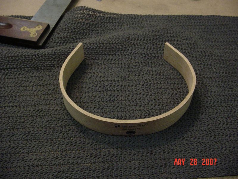

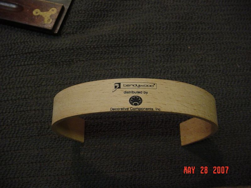

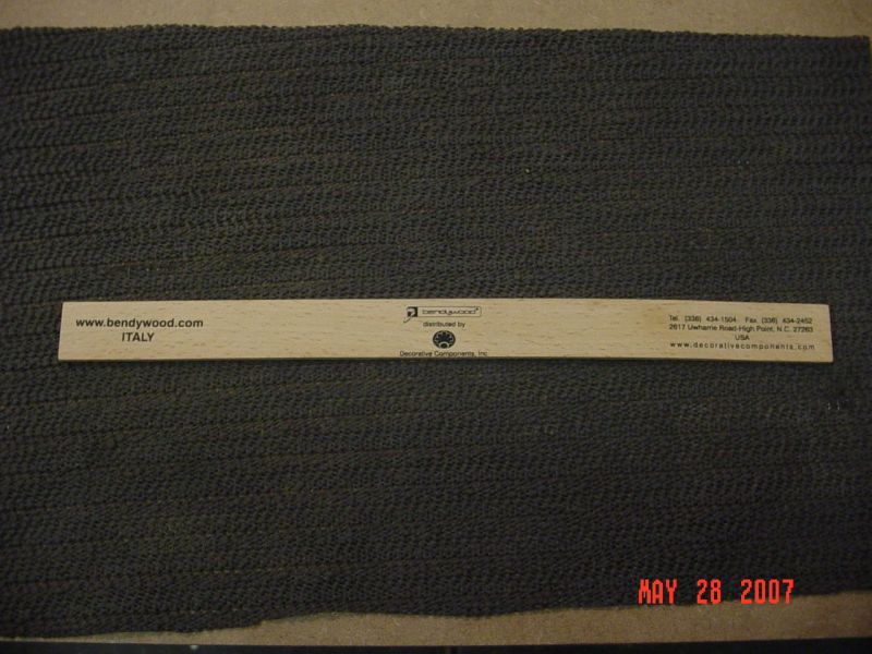

I didn't watch all the videos, but it looks a lot like a product I saw at the woodworking show in NC a couple of years ago. The product is called Bendy Wood. The process includes heat and pressure, but the wood is compressed, lengthwise, so the cells are crushed into each other, and, sort of, overlap each other. The result is a piece of wood that can be bent double by hand, and it holds it's shape after bending, with no springback. I would assume, though that it has no structural uses, only decorative, as if put under stress, it will bend.Image
When I saw it, I was thinking more along the lines of solid linings, but, alas, the stuff is really pricey. It's cheaper to bend with heat.

I think the difference is, that Bendywood, is not purported to be applicable for structural uses, but more for furniture and decorative interior applications. They have lots of pictures of curved hand rails, curved stair lips and aprons, etc. Most of the stuff is smaller than the 2x6 application in the original post. This stuff is treated, then is bendable at room temp, by hand, and it stays where you put it, until you un-bend it, which you can do. It is very good for table banding for odd shapes. Check out their website - www.bendywood.com
