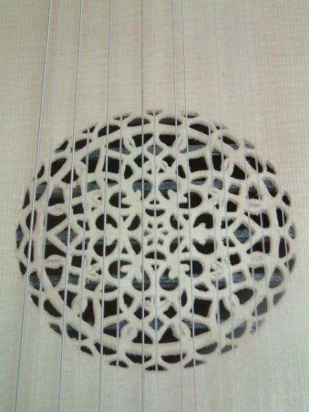

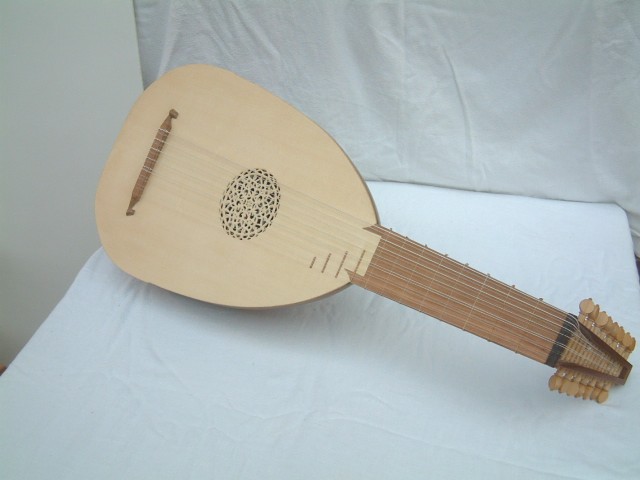

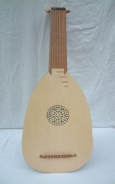

I have no compunction in calling myself a "luthier" as I make stringed instruments but knew that someday I'd have to step up to the mark and make a lute - well now I have. I'm happy and fortunate to have as a mentor, guitar building sounding board and friend Colin Symonds, a maker of great talent who is involved in his spare time in repairing old stringed instruments for the Royal College of Music. He repaired a Heiber 8 course lute and got permission from the owner to draw up a set of plans and make a copy of the instrument. He very generously made me a copy of the plans, provided me with a 90 year old European spruce top and made the fabulous boxwood pegs. On top of that Obi Wan Symonds mentored me through the project patiently answering all of my questions and providing detailed instructions for each of the many and varied processes involved. He also soundly put me back in my box when I mused about making the top arched. I owe him a huge debt of thanks.
This was scary stuff for me as I've never built from anyone else's plans and these plans are VERY detailed. Also it took me totally outside my comfort zone in terms of how a lute works compared to a guitar, but I learned a lot of interesting things and feel I now have a better understanding of where some modern techniques came from. Some of the techniques such as making the bowl and carving the Rose were . . . interesting.

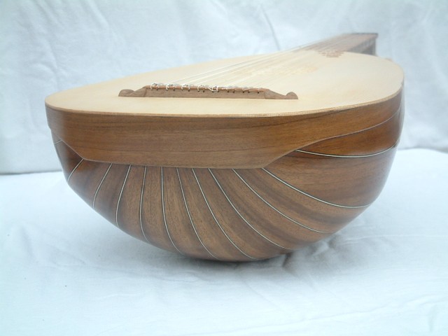

The lute is called Eggbert as basically that’s what the bowl is – draw a line down the middle of the top (half-egg shape) and rotate this though 180 degrees, this gives me the surface of the bowl back. Eggbert is an eight course lute with 595mm scale length. The bowl is made of thirteen African walnut staves separated by bwb purfling together with an African walnut end cap, the neck and pegbox are also African walnut and the pegbox has an ebony end cap. The fretboard is plum, the nut is Old Rio Rosewood and the bridge is English walnut capped with plum. The neck has eight gut frets and four wooden (plum) ones glued onto the top. The bowl was pore filled with egg white and finished with Tru-oil (along with the neck and pegbox). The top was sized with egg white, had a shellac wash coat and then a few coats of Tru-oil.
Tuning from low to high is Dd Ff Gg Cc (Octave pairs) ff aa dd g'. Think of it as a normal six string guitar in standard tuning with the third string down a semitone to F#. Now put two more strings on the bottom - D and Bb. Put octave strings on the bottom four courses and double up the next three courses as unisons. Finally put a capo on the third fret - that's now in eight course lute tuning. The strings are

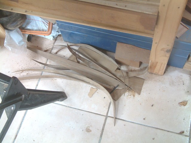

Keep at it - you'll get there in the end. If I were a perfectionist I would still be building that lute in twenty years time but I'm anxious to get to the playing stage and so compromise. I suspect you have "perfectionist tendencies" :D If it helps here's a picture of my lute rib "graveyard":
Making a card template of each new rib you are going to fit and dry fitting it on the form before using it to make the actual rib might help. This is what I did on the last few ribs.

I actually had to make up a rejigged template for Rib No 3 as the fit was way out at the arse end of the instrument. Van Andrews actually instructs to check his templates fit the mold before starting.
Your pile of discarded ribs looks about the same size as mine.
